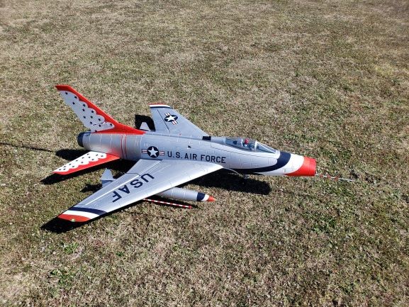

    Yes indeed!
    I'm still enjoying flying my F-100 even with the Stock Fan.

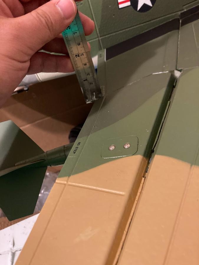

          Everything is set up conventionally. No taileron, flaperon etc. The jet has a great roll rate and plenty of elevator&rudder authority with this setup.

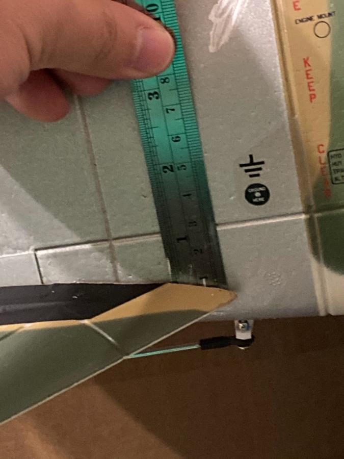

          Aileron 20mm up&down. measured at the trailing edge close to the fuselage. High rate with 30% expo. Low rate of 70% travel with 20% expo. Note: put the control linkage one hole inner on the servo arm. For better aileron control resolution.

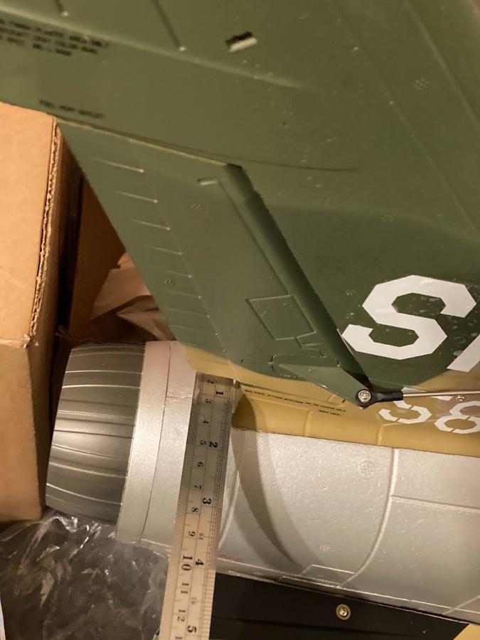

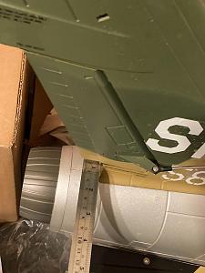

          Elevator 38mm up&down. Measured at the leading edge at the fuselage. High rate with 30% expo. Low rate of 70% travel with 20% expo.

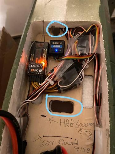

          AR637T and AG61 steering gyro mounted with double side tape. Secured with foam-safe glue. Used the stock Gear door sequencer. Note: With the stock sequencer. If you left the gear down before plugging in. The gear will not go up on your first control of retracting the gear. Only the door closes. The gear will go up once you cycle the switch. You can do this once you are in the air. But I would not recommend it. Best to cycle them and make sure they work on the ground.
          The E-Flite 90mm EDF and inrunner motor is a drop in fit. No need to worry about FSA(Fan sweeping area/intake area). You may put a few washers at the mounting point. Just to make sure the EDF is not pressured or deformed by the foam surrounding it. The thin plastic exhaust pipe needs to be trimmed short to attach to the E-flite EDF unit. Wrapping it in half and inserting it from the back make assembling easier. Note: If you programmed reverse thrust on the Avian ESC. Be sure to secure the thin plastic exhaust tailpipe. Otherwise, It may be deformed or even sucked into your EDF unit. causing serious damage even crash! That is why I did not demonstrate the thrust reversing in the video.

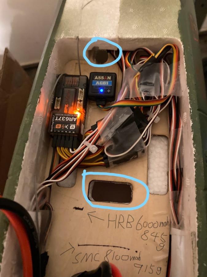

          I drilled a hole in front of the receiver and steering Gyro. Also, cut off a piece of foam in front of the battery. They will help to cool your battery. As there was no venting for them.
          2 marks showcase battery location on my plane. Yours may vary.
          CG at the manual recommended position. (maybe a couple of mm forward for the maiden fight) the Elevator is 26mm down below the seam line when neutral.

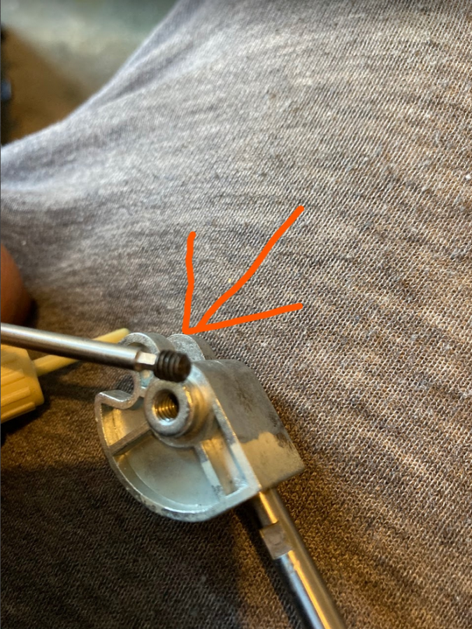

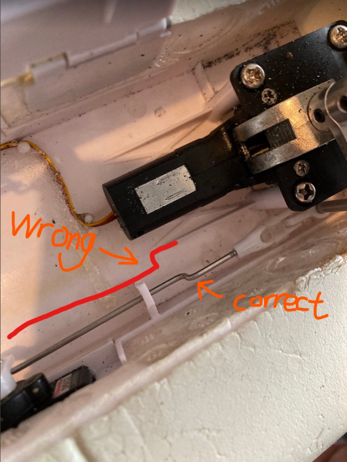

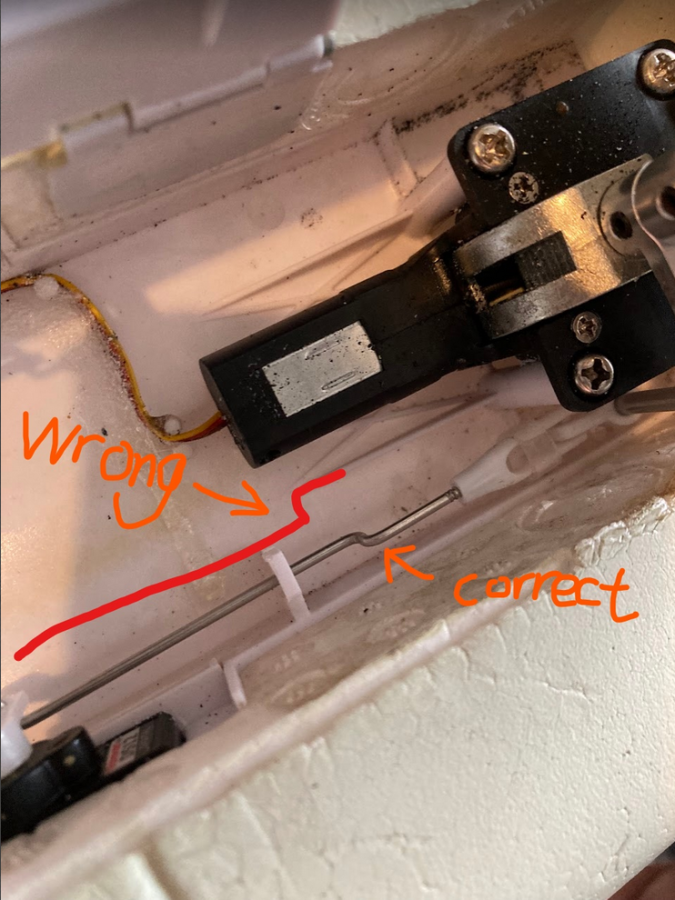

                                          So I have been through some landing gear troubles with the F100 lately. Here is what happened. It's a shame so little effort was put into manufacturing this $550 jet. Seems like I'm the "Monday Plane" magnet.
                                          1. The steering clevis was broken while I was taxing on our runway and on grass. I did not do any harsh landings whatsoever. And when I go back home I found the pushrod was bending to the wrong side. This little twist I highlighted should be pointing downward. Mine was pointing upward. And that causes the clevis and the servo to hold a lot of pressure. As it is a couple of mm away from where it should be. The manufacturer just forced it in place. Not surprisingly, it broke after about 10-12 flights. Had to replace the clevis.
Name:	Screenshot 2022-03-23 at 20-47-04 Flex Innovations Super Sabre 90mm F100D - Page 84 - RC Groups.png

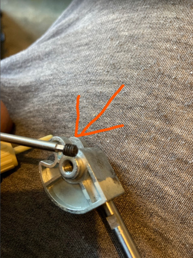

                                          2. The main gear failed. It started to twist left and right. As careful as I could be. I applied thread lock to all the setscrews I could see from outside. However, These two were hidden inside the retract unit. You will have to pull the main retracts out to gain access to them. (You don't have to disassemble the retract casing as I did. You can access them once you pull the retract out from the socket) They lock the main struts in place, together with a couple of other setscrews. There was no thread lock at all. So make sure you don't miss any of them. Coz they will come loose.

                                          3. This has something related to the ASSAN AG61 Steering Gyro. So if you are not using one. Disregard the part.
                                          I had trouble getting the Gyro working correctly after I change the wiring diagram a little. Simply put, you want to plug the "Gear in" directly to the receiver. Then plug the sequencer to the "Gear Out" on the AG61. Otherwise, the gyro won't recognize the signal from the sequencer. It will keep steering the nose wheel while it is retracted.
