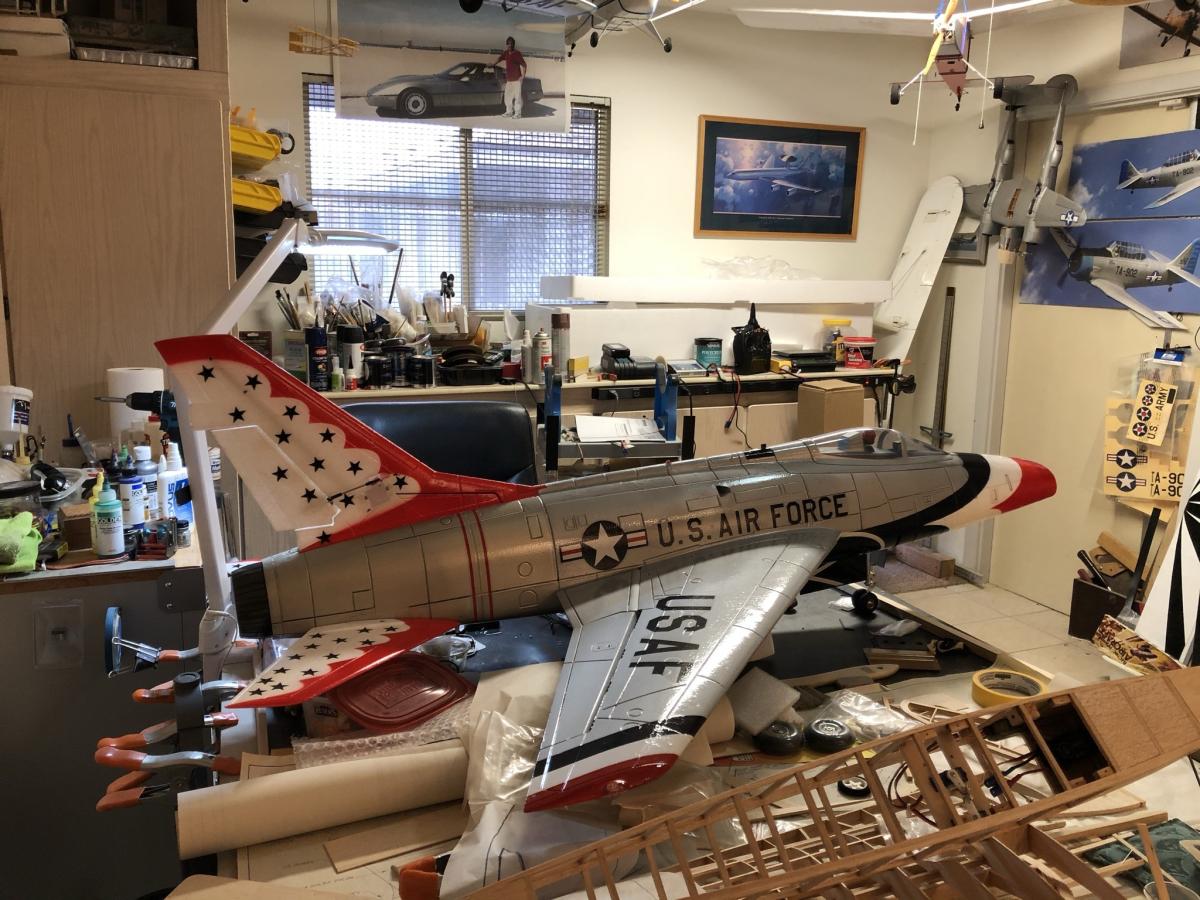

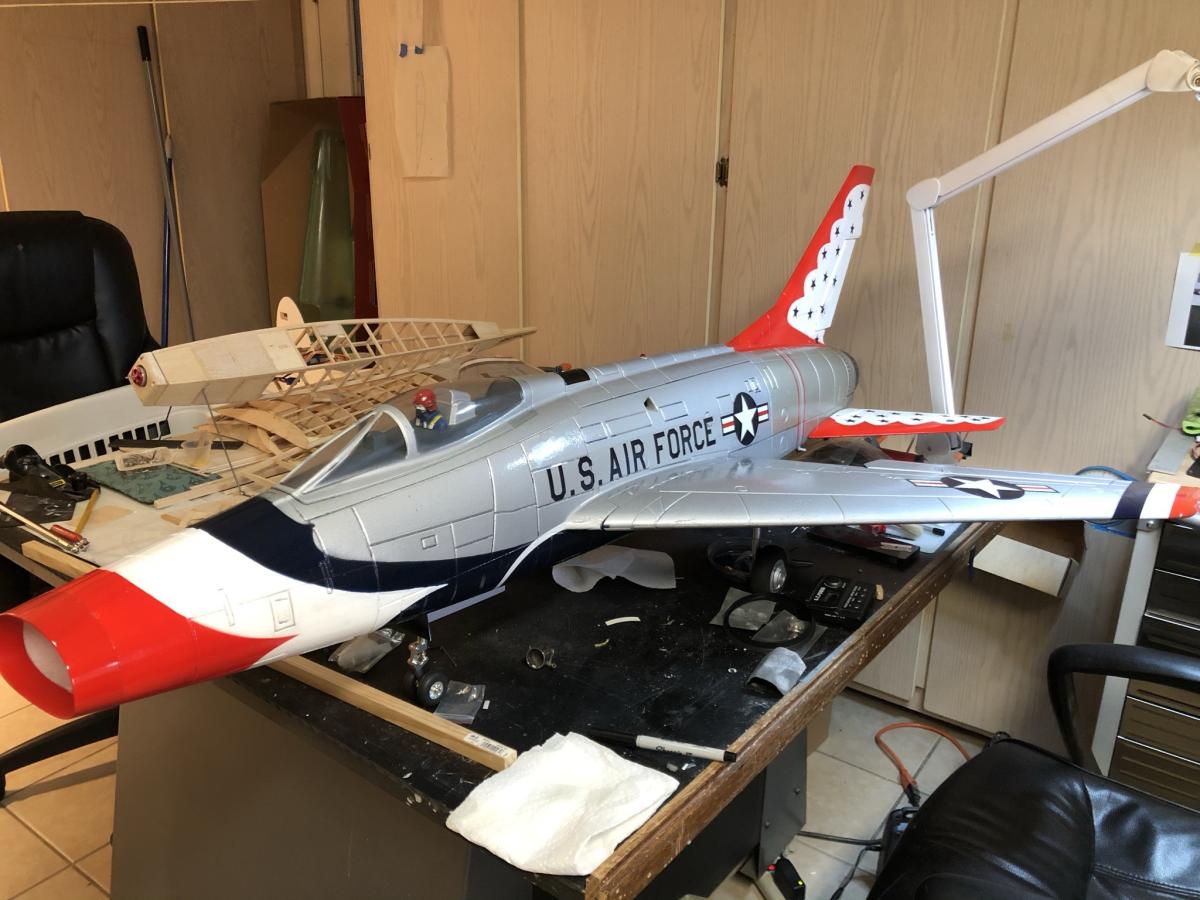

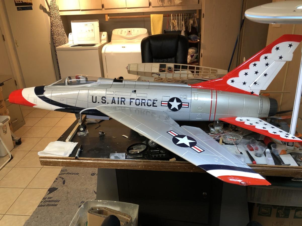

  • Got a ways to go yet, but the damage from packaging is fixed, fan and motor is in and clear Polycryllic has begun. I did get it powered up, but no control surfaces are programmed yet. Couldn’t get the gear down yet either.

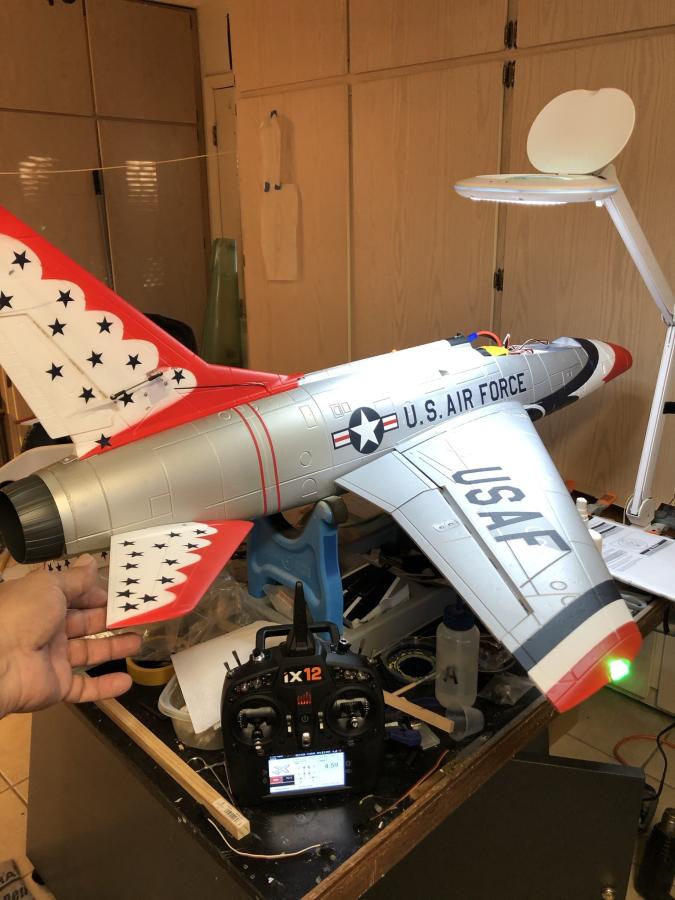

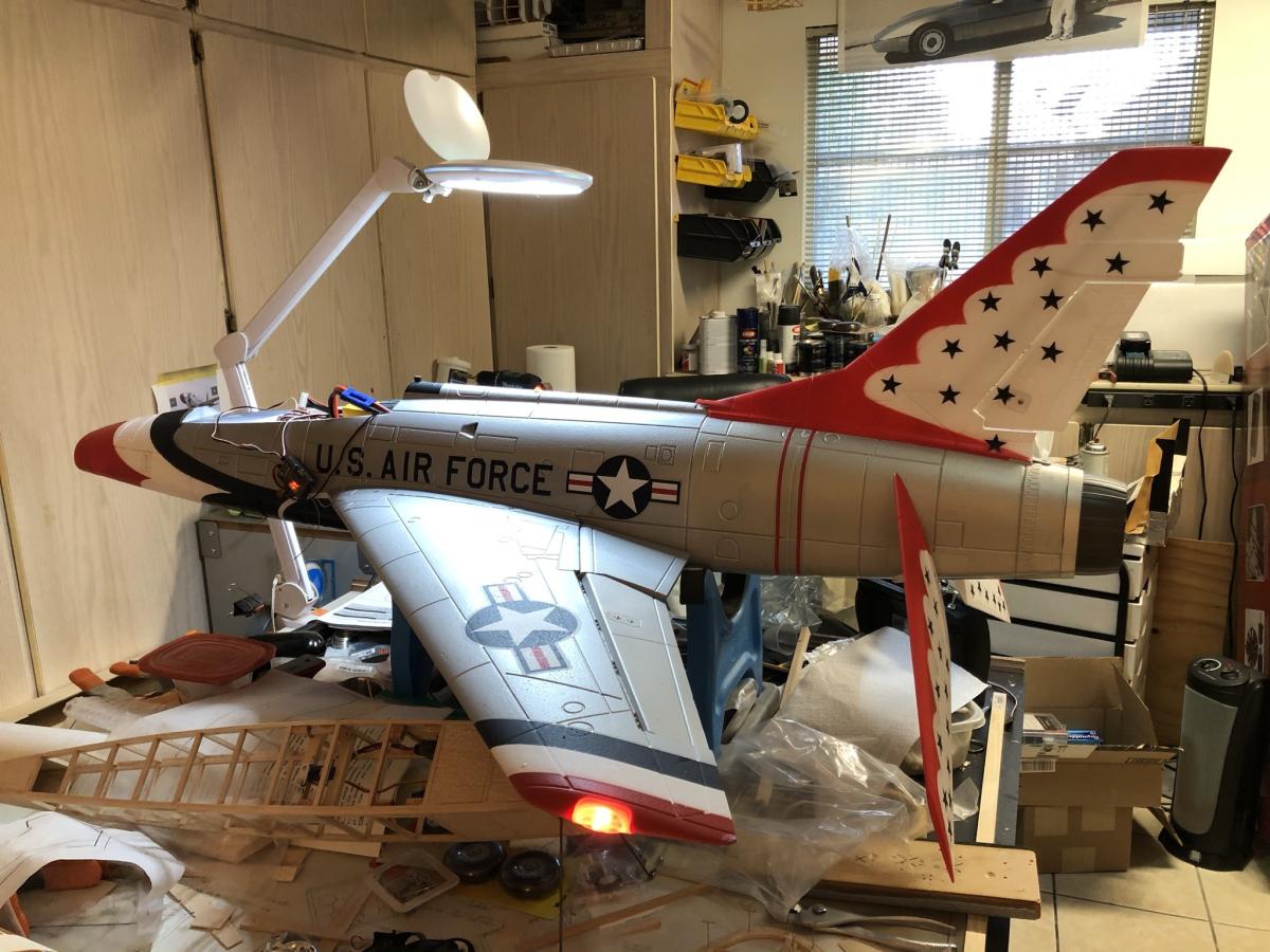

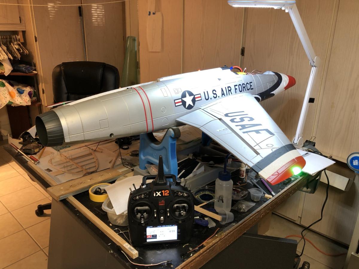

          • I think this model left the factory after a major holiday…but I think I have it better than what it should have been when it left. I may have to find some better wheels and tires - not so round or smooth in rotation. Gear swings checked out good after removing the Aura and all of the control surfaces were proper and smooth, except for one flap servo which was definitely defective. I also discovered they HAVE a reverse servo, but installed a regular servo for the steering nose wheel, so ordered that also as I didn’t have an extra channel for that ( Spektrum AR 8360). She now rests on her own gear for the first time and programmed for basic flight, but no expo or dual rates and AS3X. That’s next and then a short rest on the CG stand before the ride to the field.
            3rd coat of Polycryllic made a nice finish.
