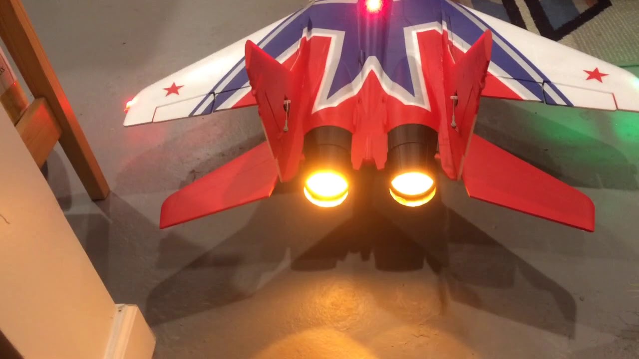

            Do-it-yourself afterburners in mine.
