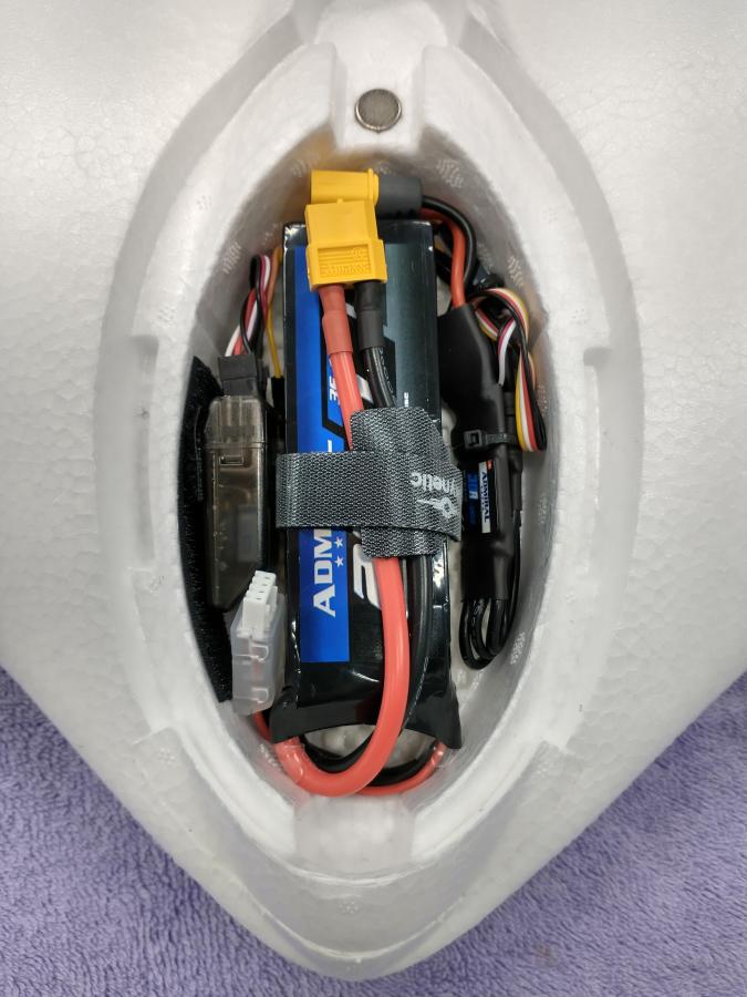

      With an Admiral 3S 2200mah, it's all a snug fit. There is a little space for air to circulate around the ESC. CG is right in the middle of the range.

                      install was fairly simple. Managed to keep some room between everything in the hatch to promote air circulation as well. ( 3c 2200mah)

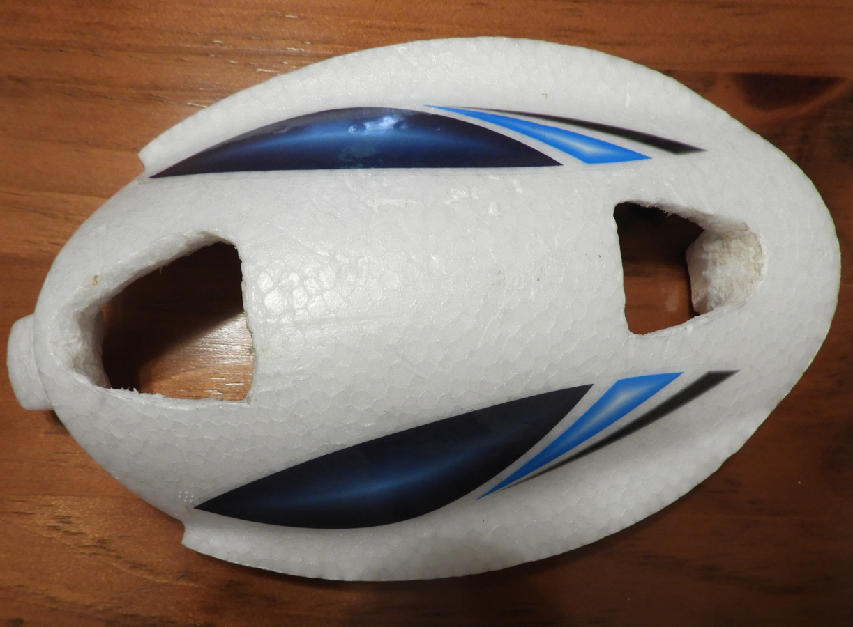

                          After flying the Neptune with the ESC outside of the hatch cover and not having overheating issues, I used a hot knife to enlarge the air vents for cooling. I was careful to try to maintain the angles so the hatch wouldn’t fly off.
                          Success. I flew today in the heat 90+ and no ESC overheating issues. So the problem seems to be that the vents are not large enough to allow proper airflow to cool the ESC.

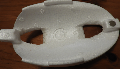

                            I opened up the air inlet and exit holes in the canopy by tapering them. The battery stays nice and cool. The ESC still gets quite toasty though.
ID:	317999 underside
