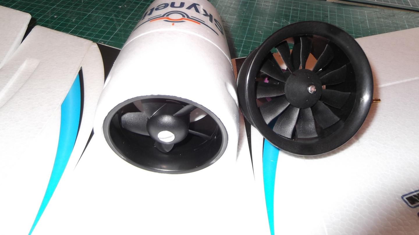

        Can someone confirm the blade count on the EDF please.
        5 blades would just be way to noisy.
          • 5426
          #24
          Very clear on Motions site, the spare parts says it and you can see it in the videos on the Motion site for the Neptune. The couple at my field have 5b's.

            #25
            Thanks for that, just wanted to confirm. I am going to pass.

                  #28
                  Get the Motion RC 12 blade unit (12 blade 4S 3300 KV) which will take 4S and up the ESC to 55 or 60 amps. Fast and quiet !

                    #29
                    The model should arrive tomorrow. I have a spare 64mm EDF (3S) so I will do some power comparisons before flight.
                    Photo`s to follow tomorrow.

                      #30

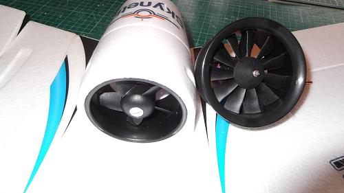

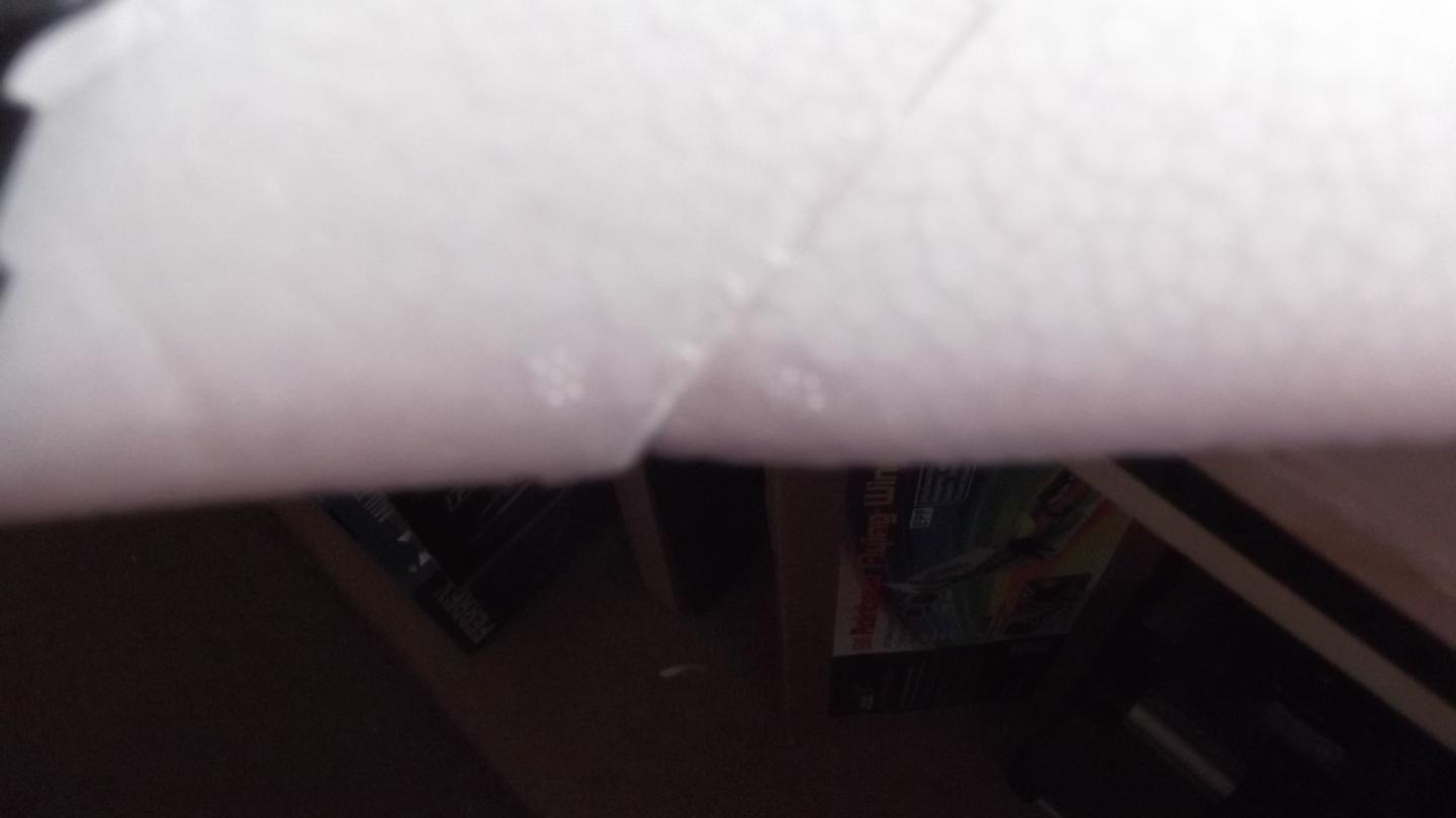

                      Well I was a bit slow with the picture`s.
                      Like others have said the finish is not fantastic, but this wing is not going to stay pristine for long!

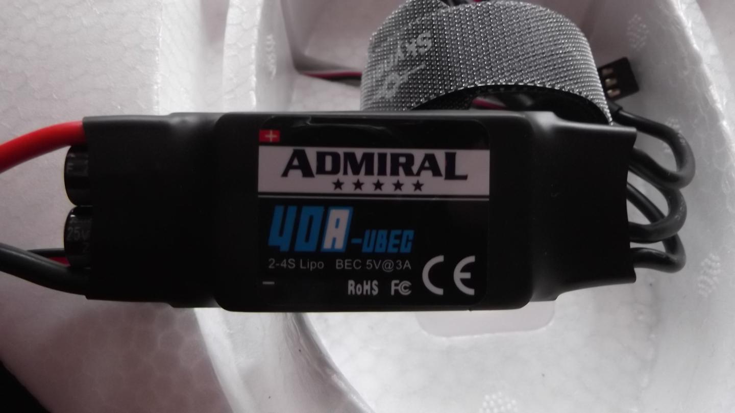

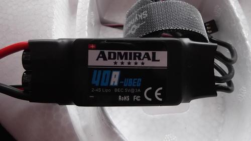

                      It also came with a 40Amp ESC.

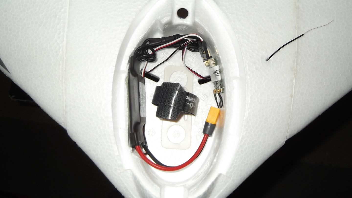

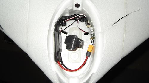

                      The battery bay is small but with a few scalpel slices there will be enough.

                            I notice that the 40amp ESC that comes with my new Neptune EDF is rated for 3s or 4s. I wonder if the stock motor can handle 4s too? I like my Neptune quite well, but it would be nice to get a little more juice out of it. Has anyone tried running the new one stock on 4s?

                                #35
                                Several club members have changed the fan to 11 blade with 4S2200. I had to change the ESC to 55 Amps and provide an inlet scoop and bigger exit vent hole for better cooling. Still gets hot. It is now fast and stealthy. Sliding takeoff, no hand launch needed.

                                  #36
                                  Thank you Louie! Did adding a heavier EDF and ESC affect how the plane floats and glides? I love how this thing just floats. All my other EDF's have much higher wing loading and don't float like the Neptune does. Wouldn't want to lose that.
                                  • Louierc
                                    • Oct 2021
                                    • 21
                                    • North Carolina
                                    #37
                                    No difference at all, low wing loading unchanged performance.

                                      #38
                                      My history with the Neptune (who .... another (wrong) model. After a go around with Motion RC, I now have the correct sheet of decals and need to start building again.
                                      Thanks, Louie! Wow, that's quite a story! Is it worth the effort and expense to upgrade it to 4s? I love mine but it could use a little more power.
                                      Is this the motor/fan you upgraded to? Freewing 64mm 12-Blade EDF 4S Power System w/ 2836-3300Kv Motor [E7204] Motion RC​
                                      • Louierc
                                        • Oct 2021
                                        • 21
                                        • North Carolina
                                        #39
                                        Yes, that is the fan assembly, and YES, it is worth the upgrade, it is a simple bolt-in change to install the new fan assembly. I already had the ESC.
