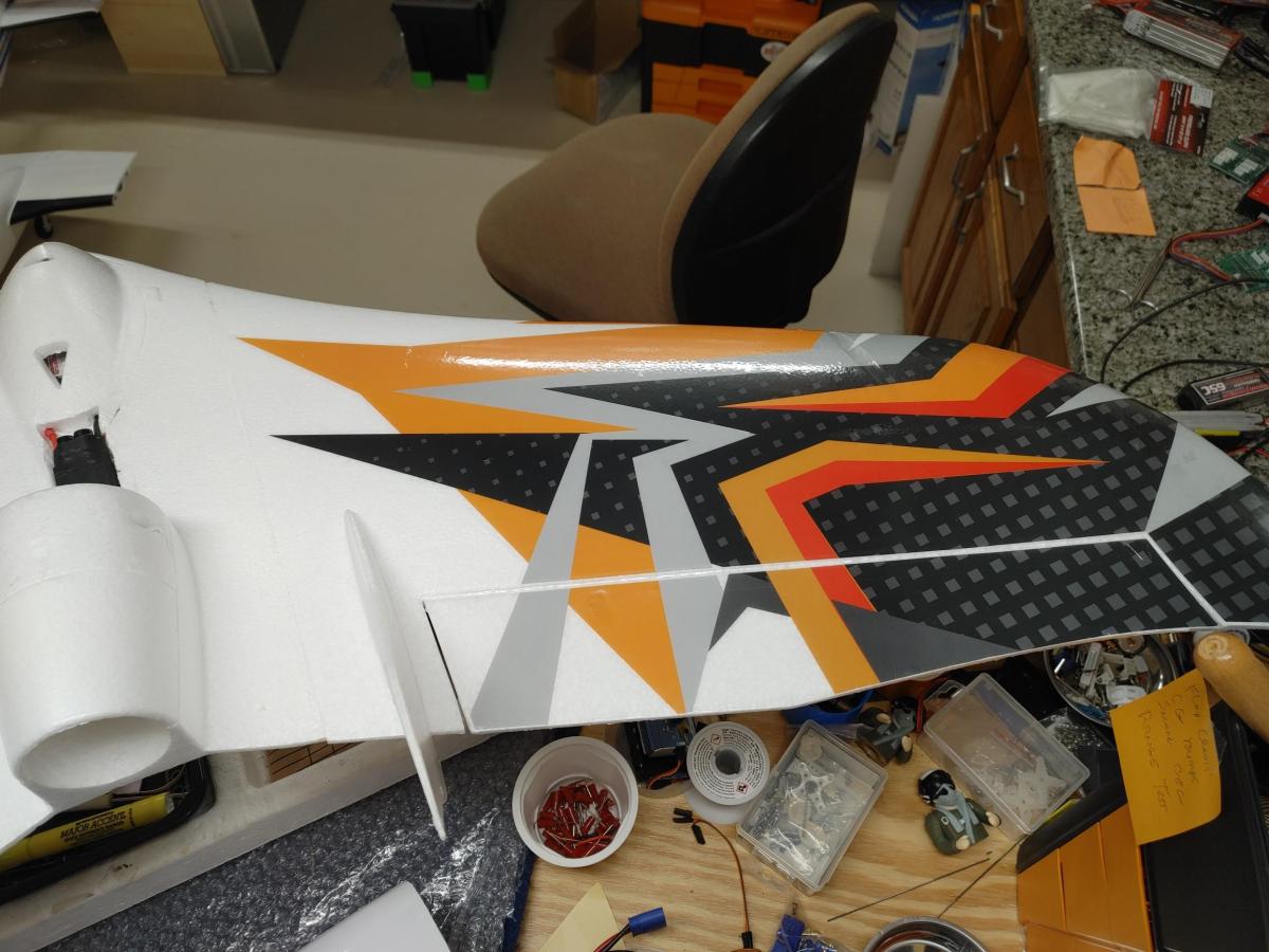

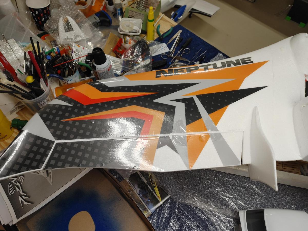

        Update - I have finished the assembly of a new Neptune. NOTE THAT THERE ARE SOME CHANGES TO THE LATEST VERSION OF THIS MODEL !
        The graphics are completely different now. Here are some of the changes:
        1. New graphics on the wing decals - the problem with these is that where they cross over the elevon hinge gap they have been slit. When flown, air under the leading edge of the elevon decal will lift and peel the elevon film right off. The film has minimal adhesion to the foam. I taped the leading edge of the elevon film down into the hinge gap. I am sure that the decals are needed to stiffen the wing and prevent flutter - that's how I lost the last one.
        2, The servo arm protection covers on the bottom of the wing have been replaced by a plywood skeg. Unpainted raw ply, it looks awkward, but can be painted.
        3. The top front fins require cutting a slot in the decals in order to glue them into their slots.
        I embedded a 60 Amp ESC ahead of the fan and changed to a 12 blade fan on 4S2200.
