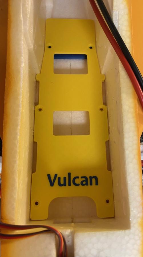

            Lost my 1st Vulcan in San Diego Mission Bay due to Tx/Rx signal failure. Such a fun model, had to get another. Upgraded the battery tray on this one to place the satellite Rx aft of the battery.
            Printed tray adds height for electronics below, length to support aft placement of battery and most importantly better battery strap placement. A little extra width makes a huge difference when securing the battery.
            The print file is available here.

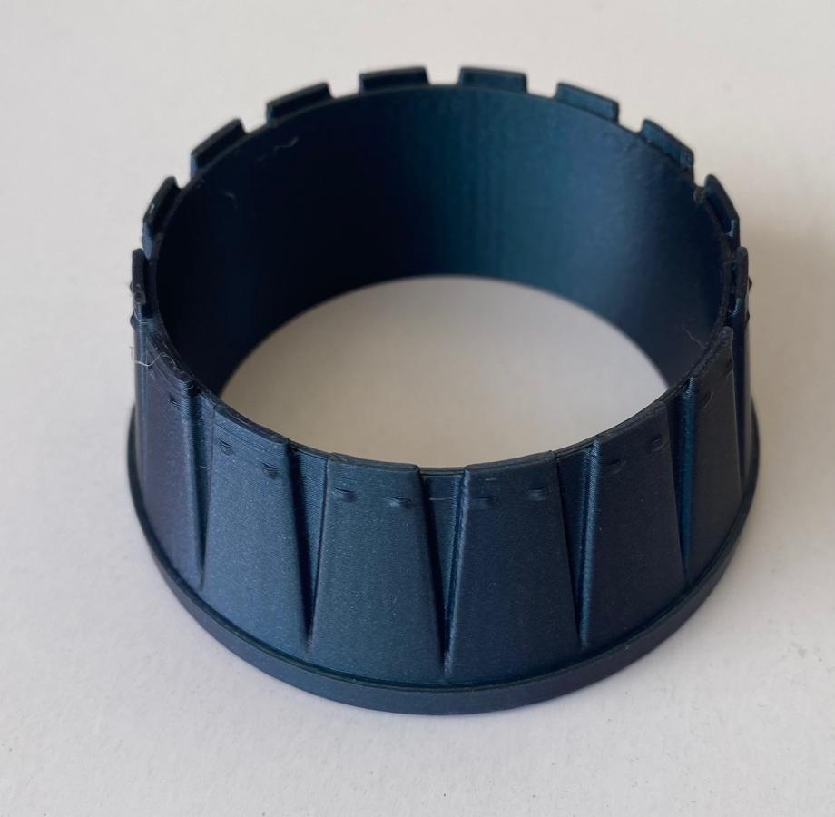

            Also did a remix nozzle which I find to be whisper quite and to look awesome printed in Burnt Titanium ASA filament.
