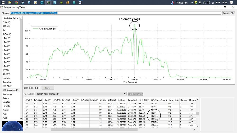

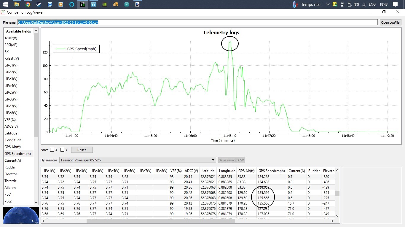

    • I have a few flights on my Vulcan now.
      So far I have been impressed and have begun to explore the speed envelope.
      That`s 135.566 mph from a 3300mAh 6s. (probably not completely accurate but I will take it.)
      • I'd say it's probably correct. I estimate mines 140 out of a dive or doing a loose pylon course.
