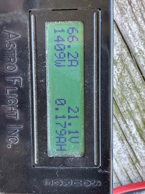

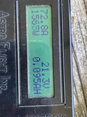

                                      ok tested the freewing T1 with the 2210kv in runner and 100a esc vs the vulcan with same 2210kv in runner and the stock 80a esc the 66a/1409w was done at full throttle and 24.9 volt battery and 80a stock esc the 72a/1565 w was done with a 100a esc both had same edf and a 24.9v battery

                                        So you are saying?
                                        The Vulcan’s motor has an issue?
                                        The bigger ESC allows the T-1 to make more power?
                                        One has more restrictive flow?
                                        • Ron1950
                                          Retired ATC
                                          • Oct 2015
                                          • 887
                                          • brandon ms
                                          #140
                                          I dont know evan. Today they both flew well in a 10 to 12 mph wind down the runway. Not fam with what the results should be. Just know the t1 with same edf as vulcan but had a 100a esc had higher watts and amp draw then vulcans 80a esc with same battery reading. Normal? I dont know
