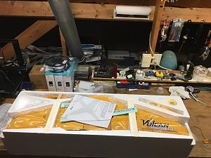

ID:	323805Click image for larger version
ID:	323806Click image for larger version
ID:	323804Click image for larger version

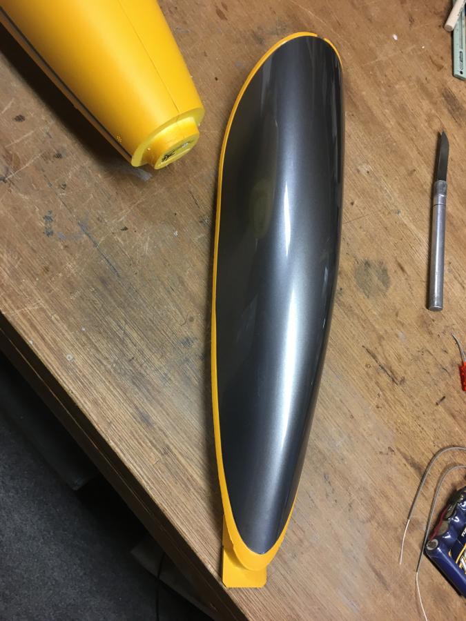

ID:	323807 I am very very impressed with the Vulcan. The first thing that I saw in the online pictures is the silver canopy which I assumed was just silver paint, it’s not, it’s a plastic canopy over the foam, very nice. I’m unboxing mine I don’t see anything I don’t like. Very well done Free Wing and Motion RC.

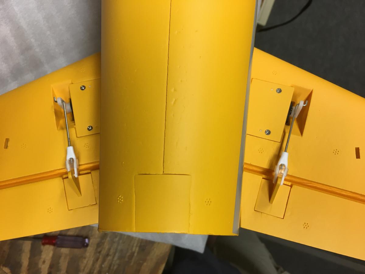

                          Mine is built and ready for tomorrow. Complaints are super minor. The decals that are sticky back had to be smoothed back down at the ends, super minor but I hope they stay down, may have to tape the ends. The other is the best alignment for the elevator and rudder pushrods. To get the best alignment they need to go into the servo arm from the rear and to do that I had to pull the servo covers and the servos out.
                          Both these things are very nit picky, the quality is that good!
                          Oh, and I put a 7ch receiver in for separate steering adjustment. There are really cool spots in the turtle deck to put the receiver if you are putting it towards the rear. I didn't use the BB and used Y's for the Ailerons, flaps and elevators and a triple for the LG. I put a satellite in the nose gear retract well. I am using a 575g 5000 pack and was surprised by the size of the battery bay and that I didn't have to shove it way back to balance. Nice engineering.

                            Great to see these in the wild! Excellent report and things to keep in mind. Looking forward to the flying reports.

                                      [QUOTE=Evan I am very very impressed with the Vulcan. The first thing that I saw in the online pictures is the silver canopy which I assumed was just silver paint, it’s not, it’s a plastic canopy over the foam, very nice. I’m unboxing mine I don’t see anything I don’t like. Very well done Free Wing and Motion RC.
                                      I wondered about that, I have sprayed clear canopies silver from the inside before using spare car wheel aerosol to get similar finish. Cheaper and lighter than pilots and leaves more space for batteries and radio gear out of view. Also less prone to accidental damage using the foam carcass. !

                                          These are a bit different, they are the chrome strips... They did not stay stuck checking on them this morning. I did a light dab of the glue that FW includes in most kits, I find it perfect for things like this and as a thread locker for screws into plastic, and other uses...
