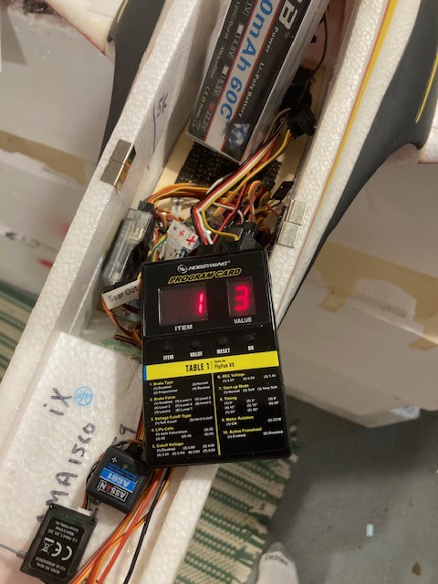

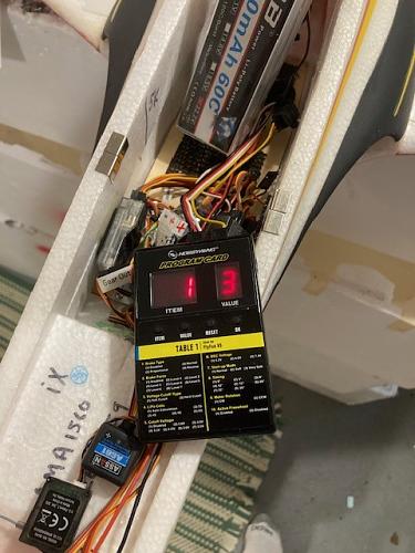

            • #26
              Originally posted by Sotm View Post
              This will NOT/does NOT work with the Freewing 100AMP reversing ESC!!! Won't even show selections on display!!
              Oh yes it does.
              Works fine with the 80A Freewing reversing ESC. I bought one from Motion just 2 weeks ago and programmed it tonight using the Hobbywing card.
              It is VERY fussy about the order in which you plug things in. If you don't get it right it doesn't work. Follow the Hobbywing instructions exactly.
              EDIT: Just tried it with the Freewing 100A reversing ESC in my Avanti. Worked fine there too. Image shows reverse brake enabled.
              Click image for larger version  Name:	IMG_0059.jpg Views:	0 Size:	85.3 KB ID:	409838
              Clearly you or your informant connected one up incorrectly.
