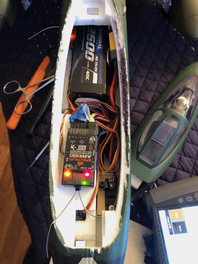

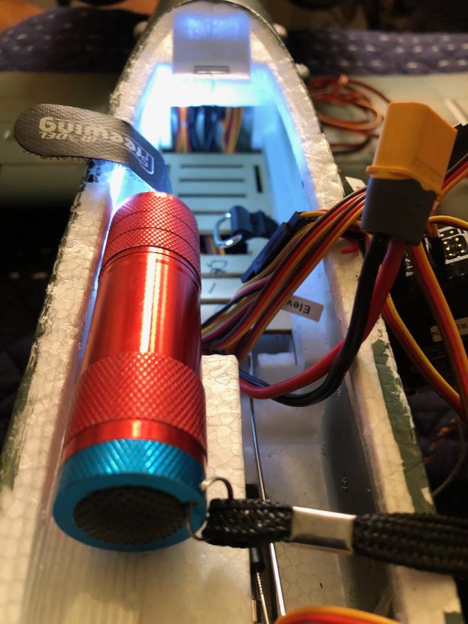

        I really like the A-10's I have 4 now, counting this one. I received this one yesterday at 2:30 pm unboxed went over the inst. manual and started working on it. Finished assembly, and did some changes with the wire extension routing. Instead of running the three Y harnesses from the back to the front on top of the battery tray and along side the the battery. I rerouted the Y harnesses underneath the battery tray. This makes battery accessibility much easier. I also had to add a 3" extension to the Elevator connector for easier receiver placement (installed elevator extension to short) The battery strap installed is too short for any of the recommended 4s batteries. I do like the thrust reverse setup already programmed just plug in the thrust reverse connector into channel 7 set it to your desired switch to operate it

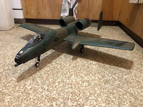

                Finally ready to go, with the suggested 4s 3600 where I have it in the photo balanced at 50mm from the leading Edge. Know for some decent weather and I can go test fly this one, can't wait to try the thrust reverse. I sure like this new feature for the EDF's to help slow them down after landing. The thrust reverse option on the prop jobs is awesome and much more effective in slowing and stopping the plane
