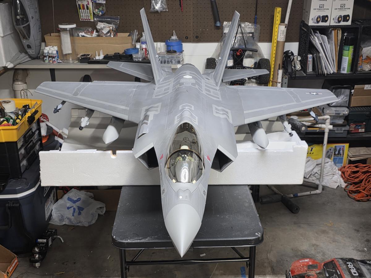

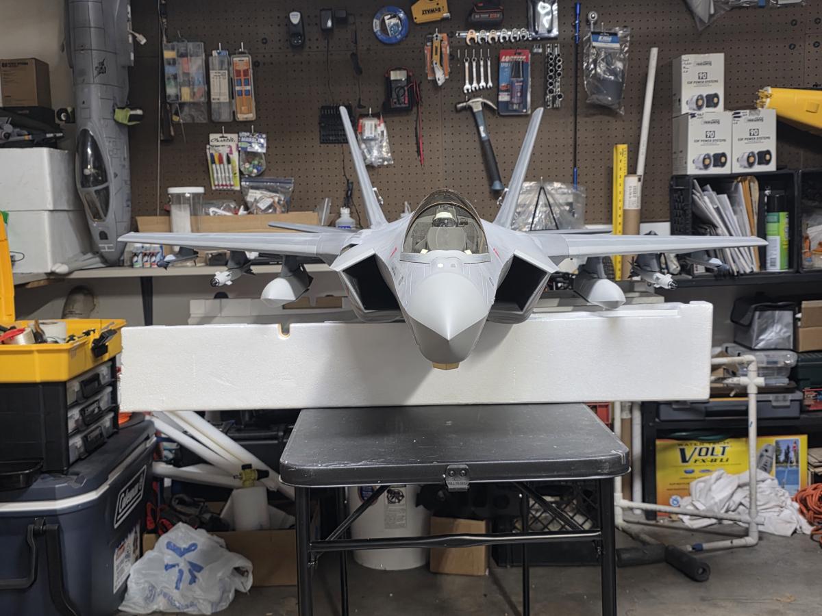

                                        Got it together. I must say. This thing is a beast and nicely done. Kudos to all that took part. Now, maybe Freewing (MotionRC) will offer more this size. Hopefully I can get the maiden out of the way within the next couple of days.

                                          #100
                                          Does it come with all the missiles and tanks or did you add them from other planes?
