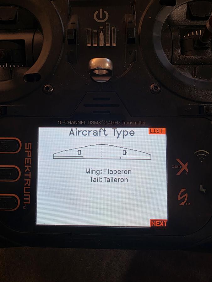

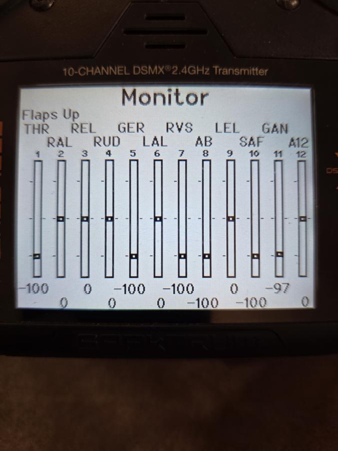

        I would like to know the setup for Spektrum in order to get Flaperons and tailerons. I have the 110mm F-35C with the Freewing gyro that came with it.

          Airplane type: Wing: Flaperon - Tail: Taileron. Install a Y lead to join the flap and aileron on the wing coming from the bluebox in the plane. That worked for me. You will need a 10 channel receiver and completely bypass the stock gyro.

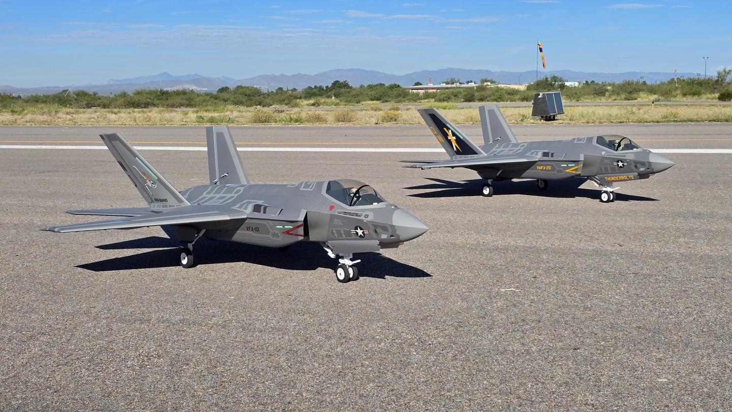

                              Maiden flight day for both of our 110mm F-35s is complete. What a great jet. Check out our tandem flight. I hope that this time MotionRC will show our jets on their next livestream.🤞🏾
                              Best jet on my hangar so far. Thank you Freewing and MotionRC for this jet. You all have a great rest of your day. Greetings from Douglas, Arizona, USA 🌵🌵🌵😁👍🏾🇵🇷
