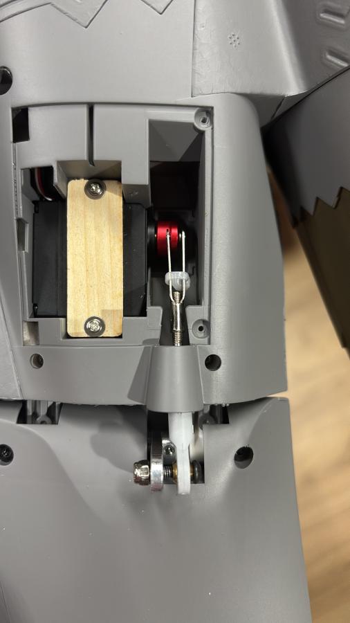

                    Putting the model together and have some questions about elevator position.
                    With neutral elevator stick the elevator position is 10mm above the reference mark on the airframe.
                    according to the manual the flap to elevator mix needs some 3-6 mm below the reference mark.
                    this is a trim change of 13-16 mm from the current neutral position.
                    Have any of you adjusted the control rods to achieve less movement or just trimmed using the radio?
                    Any pictures of neutral elevator position appreciated.
                    I will be setting it up for a CG of 25mm behind the factory position.
                    Below is the elevator at factory neutral.

                      Removed the nut on the elevator push rod and saw that the horn was adjusted nearly all the way up the thread. Now it has a more neutral position at neutral elevator.
                      If I had not checked this and not had extended trims , there may have not been enough elevator trim to achieve a satisfactory position!

                        Elevator on fuselage mark is correct. The first picture on the first post is an emergency stop right there no!!
                          • 5417
                          #132
                          Use your subtrim to get the servo arm 90deg to the push rod. Then adjust the linkage to get the surface at the manual neutral location. Then check that the throws are per the manual (or your desired throws).
                          I find it amazing people don't understand how to set up a plane.
                          If someone does not have experience flying EDFs I would never recommend a starting balance point 25-30mm behind the factory CG. After flying you may decide it flies better at that point but please don't start there.

                            Thank you Evan for your advice. I consider myself to be a pretty experienced pilot of EDF’s and this is not my first plane. But it thanks for your kind words.
                            I was wanting to see if anyone else had this issue, I am happy setting up an EDF myself. My friend and every person who has this plane has flown it behind the manual CG. I am more than happy that they have done the test flying for me and happy to launch at that position rather than on the book suggestion.
                            Hopefully someone who is searching for answers may see that FW does not always leave things in the best position, in my case it was a push rod that was not well placed. Luckily i an able to search for information that confirms what I already suspected.

                              Re reading that I was a bit harsh, sorry.
                              FW usually give you rods that are close but always need a twist or 3 or 4. Eflite does a little better but usually still need minor adjustments.

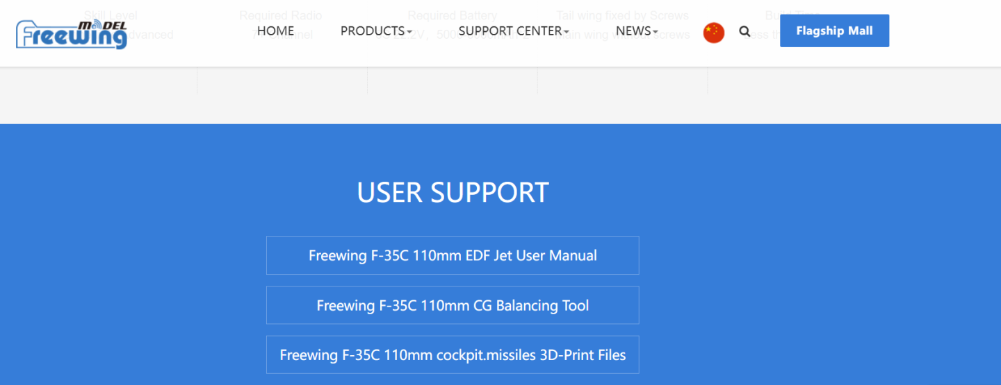

                                I don't know if this would help anyone, but I was cruising the Freewing website and discovered Freewing offers a balancing tool for the F-35 for those of you needing a little help. I found the weapons and pylons on the Motion website, but Motion does not list the balancing tool. Just thought I would share. https://www.freewingmodel.com/res/so...0278669497.zip

                                  Mine came with two wooden templates to add to the wing roots with holes to place a string or wire and balance it like that. Not sure if yours came with that.
                                    I'll have to recheck my crate, but I don't think it did. Maybe the download is the file to laser cut the template. I 3D printed it just to see what it was like. Sure beats denting the foam trying to balance the heavy plane with the fingers or small CG tool.
