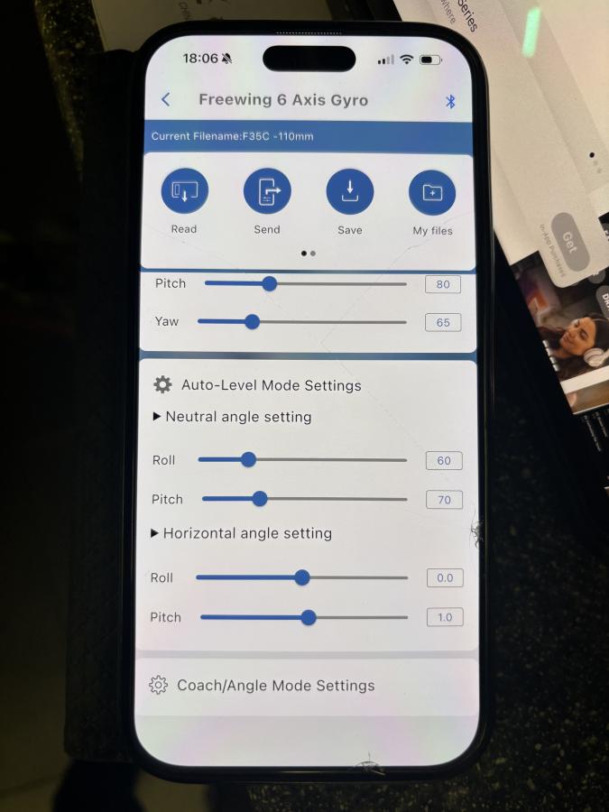

                What is interesting is that the stock gyro setting are not enough or were not correctly set from the factory. He reported that it was pretty unstable in roll , not so much in pitch.
                He did not have a program box at that stage so I lent him mine and we looked at the settings and adjusted them upwards. He has flown it since and is much happier.
                i enclosed his settings. The CG is better with both batteries side by side rather than split as suggested. The CG is at least 15-20 mm behind the factory recommended mark.
                Nice and floaty is his feedback to me.

                          You cut off the top and the basic roll gain. We can see the auto level settings, but not the basic gains above.
                          • 400driver
                            • 58
                            #93
                            Thanks for spotting that , they have now been raised to 50 on each. Better results.
