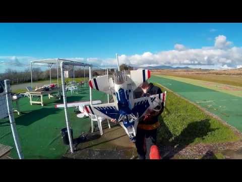

    Quick question to goniac33: That video of the T-bird F-16 you posted on a few posts....is that modified or stock? Thanks
    That one is stock. My buddy and I will be flying today and I will get a video of his Stock Thunderbird F-16 with his fan that was balanced by me. It is an impressive bird when you fly it right...
