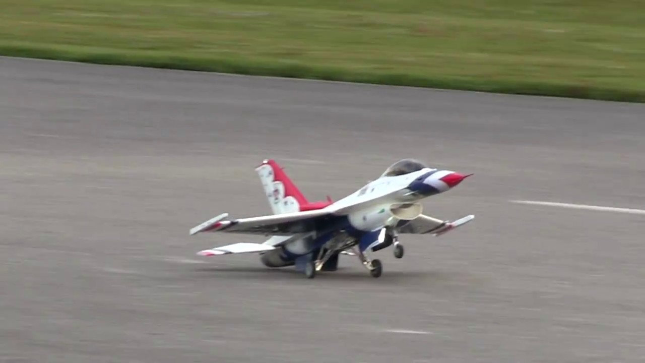

                  I have both, the Thunder B and the standard gray and have lots of flights on both. They fly great, I don't know what some of the others are saying about it being slow but its plenty fast, flies great slow or fast, I've had the F-15, F-14, F-5, T-45, F-86, F-104, Eurofighter, and my all around favorite is the F-16, it just does it all, once you get the landings down and the cg right. It loves to yank and bank or do really slow high alpha passes. I fly mine all stock as is out of the box. I use Pulse 5000 45c or Gens/Tattu 5000 60C. If you want to do some high speed steep scary turns, kick in some rudder along with the ailerons. I do fly the gray version with all the missles but not the drop tanks, faster without of course but looks great on those low flybys. I sold my F-15, it was slow to me and I didn't like the paint job, might get another one one day, but the F-16 will out fly it, my opinion of course.
                  Get the 90mm F-16, I will be more than glad to share my CG and all that to get you to try one, you just have to figure out the landing, but once you do, it will be your favorite.
                  • DCORSAIR
                    • 1918
                    • Selma, Ca.
                    Lots and lots of flights on these two..

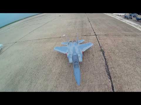

                            This is a flight from a couple weeks ago. I am flying my Modified 90mm F-15 and my buddy is flying his modified 90mm F-16 and there are other freewing 80mm F-86s in there as well. My F-15 has a Leopard 4092 1730kv inrunner in a freewing fan running on a 6s 40c 5000mah pack. My buddy is running a Leopard 3674 1700kv motor in a freewing fan on a 6s 5000mah pack. A pretty significant boost over stock but still using the same 6s battery. I need to take a video of my friends stock Thunderbird F-16 as well because the plane flies wonderfully in stock form if you get the CG right! I also balanced his fan and it sounds amazing!! But here take a look at this video... 6s can be made to perform really well if you use a different set up.

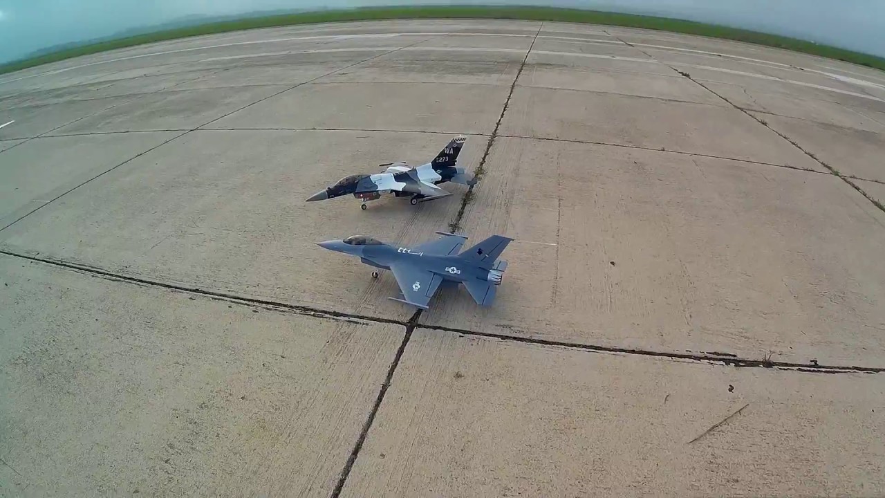

                              Here are a couple more of my 70mm F-16 flying with the 90mm F-16 with the setup I mentioned above.
