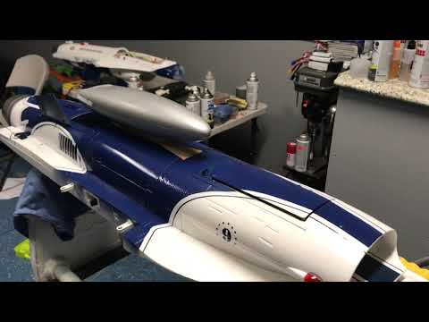

  • Scale Master
    Retract Test with Centerline Tank

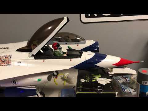

  • Scale Master
    Operational Canopy Mod Video
  • Scale Master
    Custom opening canopy mod

  • Scale Master
    Custom 300 gallon centerline tank fitted

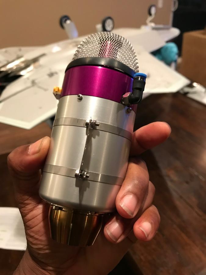

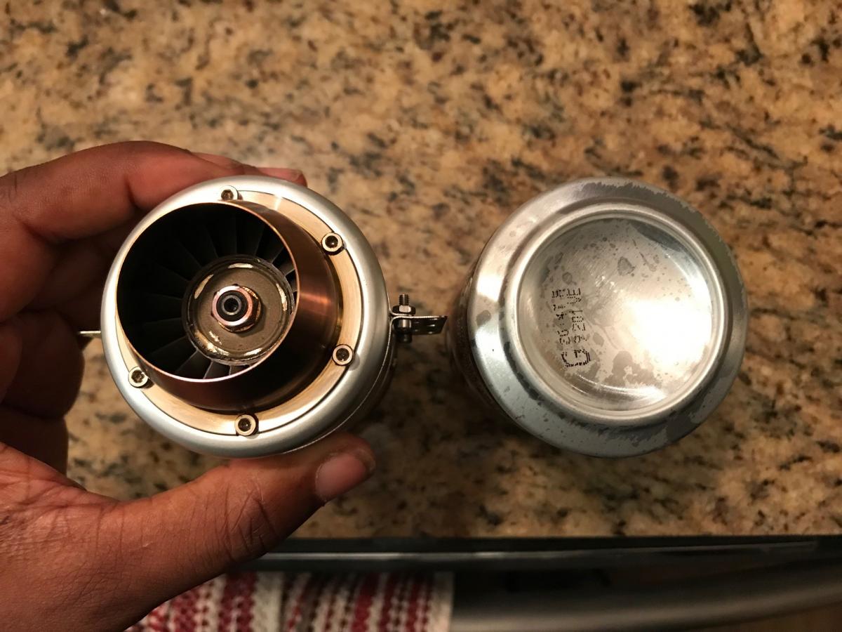

    Here are some pics of TWO Freewing Turbine Conversion T-birds I'm building
    First set of pics show a 2.5" pipe
    2 Tanks (24oz + 11oz internal taxi/smoke tank)
    UAT = 2oz
    JP 55mm Wheels and brakes.
    All for a k-45 turbine (my calculation show the jet will easily have 5-6 min flight time at mostly full power (Total fuel on board = 39oz)
