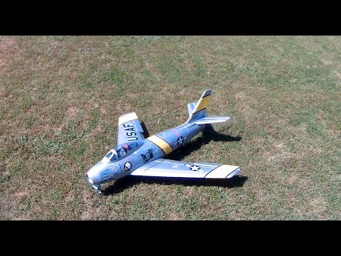

    ​ I maidened my F-86 this past Saturday with no problems. I used a CHL 6S-4K batt, with battery pushed back to the ESC retainer. The F-86 was slow to lift off and climbout, but flew great. No horrible landings. On the maiden landing, I actually had two good landings, as we say at the field, or a touch-n-go and landing 15 ft later. LOL
    Second flight was great, with a greaser of a landing.
    Third flight was wobbly. I think that my LemonRX receiver may have been loose (I'd turned on stabilization due to the gusty winds). The left gear popped out during the third landing, but that was a 5-minute repair.
    Love the F-86. You guys did not steer me wrong. Here's a dust-in-the-sky composite video of my first three flights: https://youtu.be/qqaqDMmYryY
    Over in the 'what did you fly today' forum, I've gotten advice to move the battery back, to help with a quicker rotation and climb out, and probably a little less up elevator trim. I have moved the battery back on top of the ESC. Should I be concerned that the ESC will put too much heat into the battery? I also had to cut some foam out of the battery hatch to accomodate the aft position of the battery.
    [edit] I just put an Admiral 6S-5K in the Plane. The Admiral 5K is a bit thinner than the CHL 4K battery and fits much better in the bay than the CHL. Guess I know which battery I'll be flying from now on... :-)
    Are there any other recommended mods?
