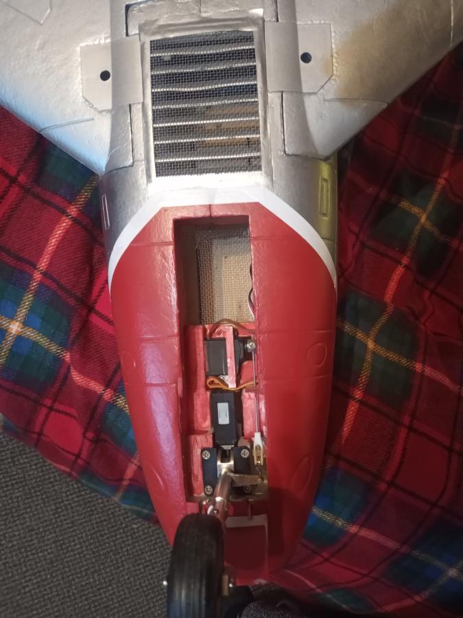

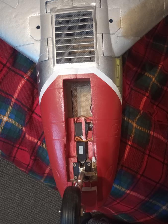

      • I need some help. I have a F86 Sabre. I punched it in and damaged the fuselage. I ordered a new fuse, only to discovere the new fuse did not have the small plastic brecket you would attach the steering servo. Without it, and my old one damaged beyond use, one can't attach the steering servo. Searching the parts avalible for the plane, there is none to be had. I opened a ticket with tech, but no response. Somebody out there has to needed the part in the past. Any ideas?
        • Jimbomck you could remove the bracket, glue a 1/16 ply plate on the air intake side of the hole where the servo goes then glue the servo in the normal position with foamtac or servo tape. Dry fit the servo to ensure it clears the nose leg when gear is up.as it should do so.

          • Originally posted by jimbomck1 View Post
            Remove the bracket, glue 1/16 ply plate to cover servo hole fitted from air intake side ( below servo and ply deck as you look at it. ) Fix servo with servo tape or foamtac , check clearance of nose leg with gear up

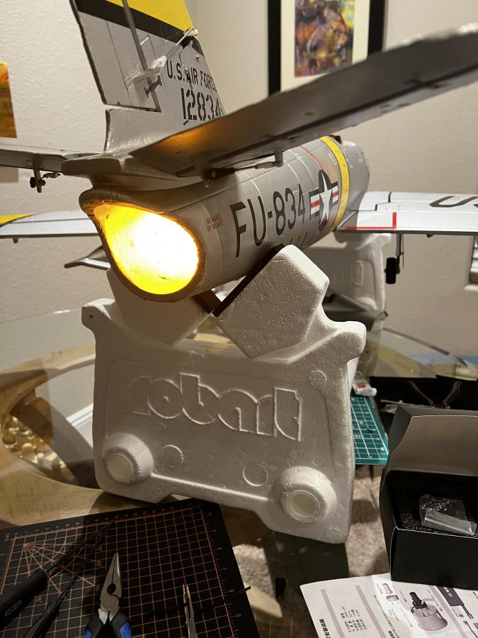

            • Just added the afterburner Kit! Taking it up tomorrow! 😎
              • Peajay5, looks FANtastic. Whose AB unit did you use? Best, LB
                  Thanks man! Tooo windy to take it up today hopefully the winds calm down sometime today or on the weekend.
                  I used the afterburner kit from motion RC: https://www.motionrc.com/products/fr...-edf-jets-e631
                  I think I am going with the KM one for my FMS F86: https://kmrcmodel.com/products/unive...otor-version-3

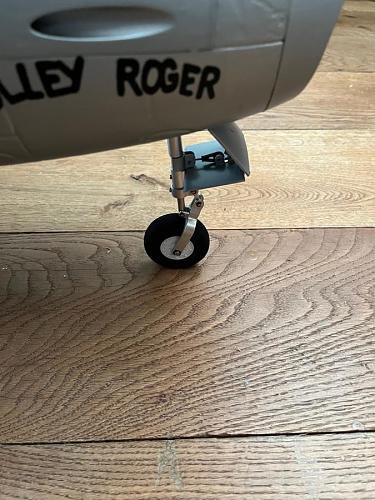

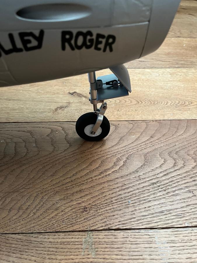

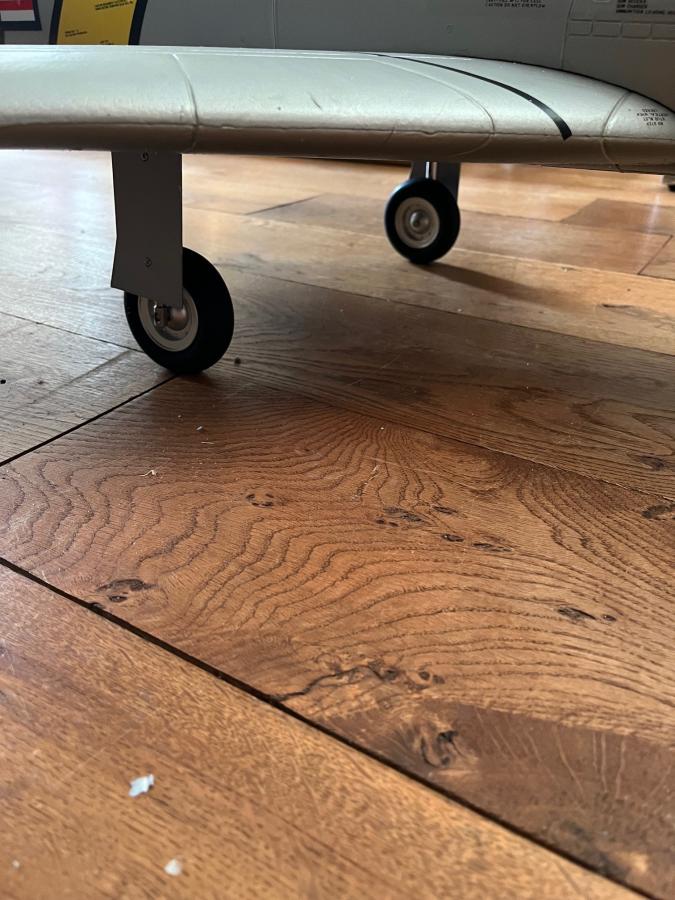

                                      • Wheel modification
                                        ​Pilots
                                        Thanks to Tom Hunt see also https://www.rcgroups.com/forums/show...postcount=7780
                                        I changed my wheels because flying from grass the stock ones are to small
                                        I used:
                                        front wheel from FW T33, SKU: W20110136-T33 (50mm, 1,96")
                                        main wheel from FW T33, SKU: W90114188-F4 ( 70mm, 2,75")
                                        I enlarged wheel well main landing gear, and hopefully I will take off better from our grass field
                                        regards Hans​
