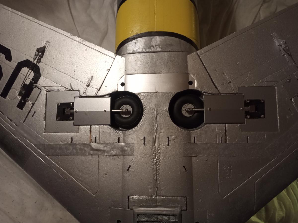

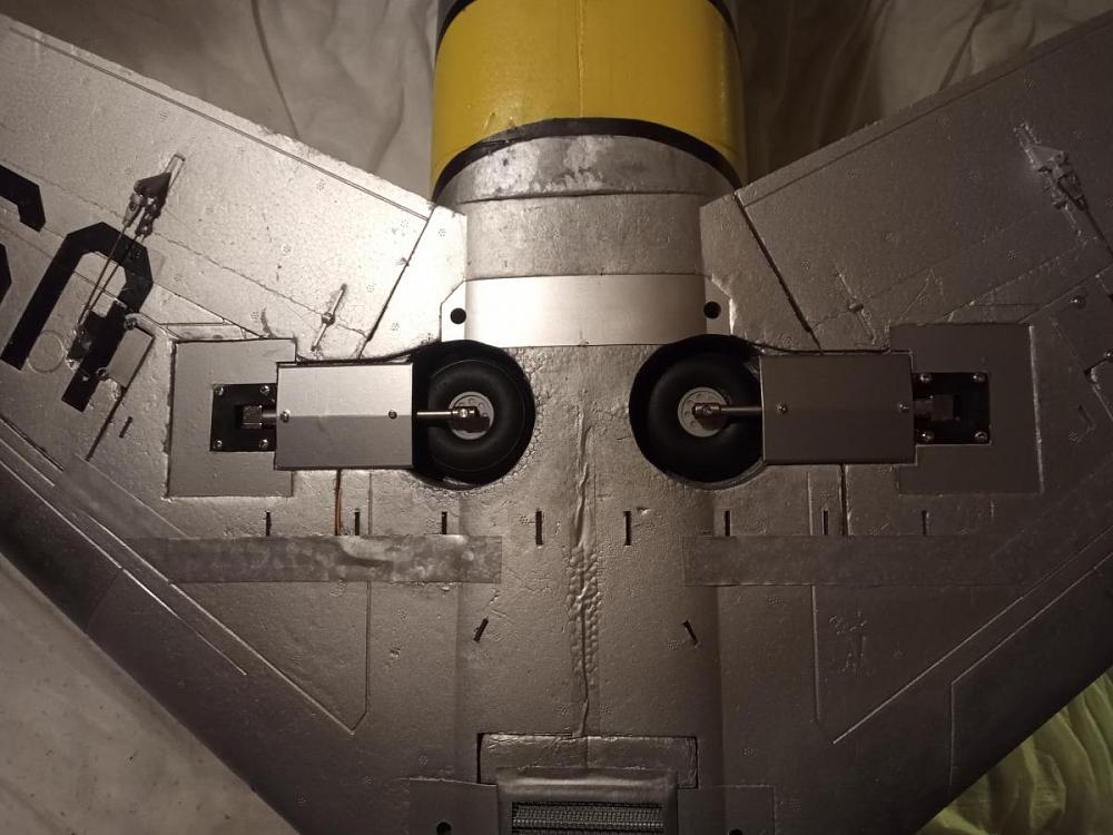

                      The gear back boxes do not have a big enough contact area with the surrounding foam and leaving the bottom out of the back box did not help. I re-fixed mine with gorilla glue and I also
                      replaced the thin cosmetic silver plastic cover strip with 1/16th ply U Shaped cover strips from a 70mmx60mm rectangle glued to the exposed surface of the back box and the surrounding foam in order to achieve an additional 10mm or so width of pressure spread from the back box to the foam surface. I fly off grass and so far so good. I just finished the ply surface off with peel and stick silver film. I also made the wheel wells a bit bigger and replaced wheels with 2.25 inch wheels and replaced the oleo covers with bent ply covers to match. ( these replaced the ones I cracked when one retract flew out on a pretty gentle landing mainly due to the lack of glue and poor contact area.)

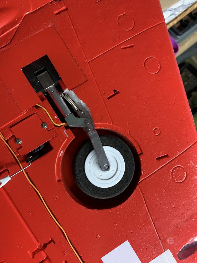

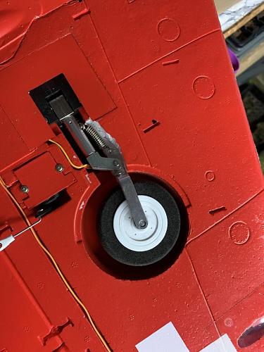

                                I was thinking of going this route. Do you remember which struts you used? Did you just change the strut and use the installed retract? How much foam did you have to remove?
                                A picture would be fantastic if you have one...
                                I thought I replied to this but it looks like nothing happened. I may have not clicked on the right button.
                                It's been a while but I seem to recall I got the struts for my Venom from the parts section of another plane - Avanti S or something like that. Since the retracts are the same size, I just used the existing retracts and just replaced the strut and used the same tires. Remember, this is on a Venom, so the length of the strut on the Sabre may not be the same and also, once you change the strut like that, the strut cover will no longer work. As you can see, the area where the spring is and the pivot joint takes up more room, so foam needs to be carved out.
                                PS. I flew my Sabre with the modded EDF (more power and thrust) yesterday and it flew marvelously. It can come in very stable and land very softly but if it runs off the runway and onto the grass, even with my retract mount re-inforcements, it may not hold up.
