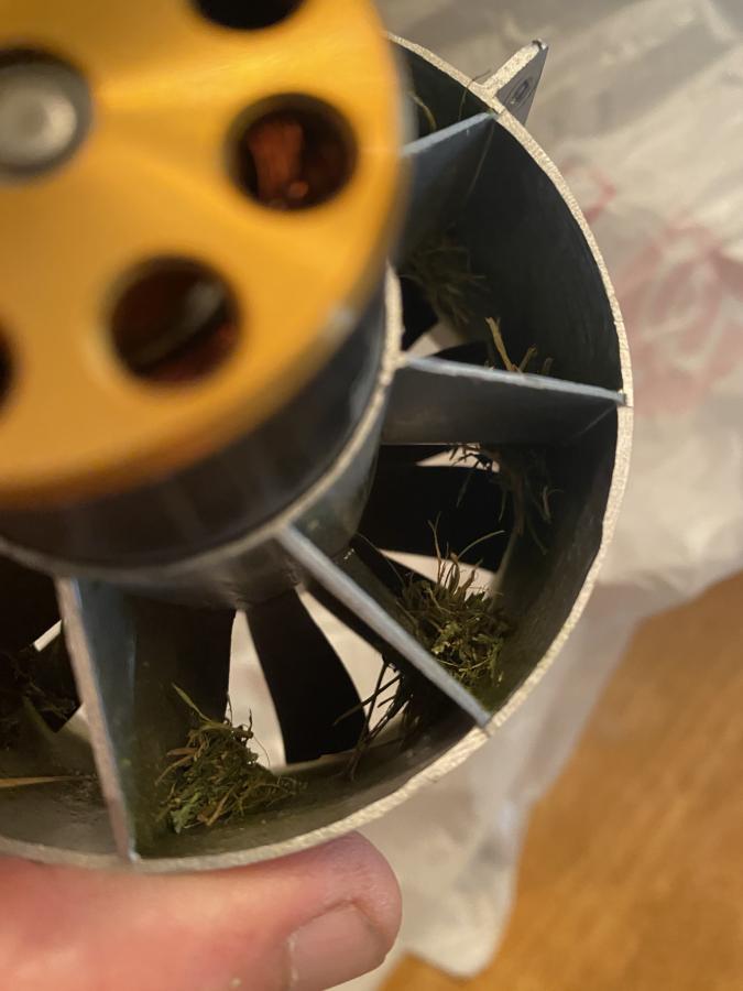

              I just got back from the field. I tried to maiden my F-86 and no luck. We have a well groomed 800ft grass strip cut very short and I could not get the F-86 to rotate. Just would not get enough speed. I have the HP version as well. I tried no flaps, half and full flaps. I also calibrated the ESC again to be sure I was getting full power.
              Anyone have any suggestions for operations off a grass field with this plane ?

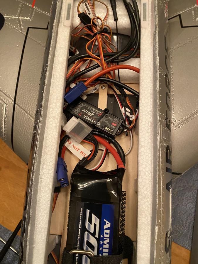

                  #728
                  I can’t get the nose up, it will not rotate. I have the CG set where it will rest on its tail and the nose will fall when you lift the tail about 1”.
                  I may have to see about modifying it for slightly larger wheels.
                  • C17loadmaster
                    Retired USAF Aircrew
                    • May 2018
                    • 371
                    • Auburn, CA
                    #729
                    This was almost expected when the attached pic was posted in one of your posts a while back.... It has to be extremely nose heavy or tail heavy (without the lipo installed) being as you stated the correct CG. Make sure the tires are not too tight and rubbing on takeoff, and of course... ESC Calibration.

                      I found my problem, a wet grass runway full of grass clippings. I had to pull the EDF unit to remove all the grass.
                        • 4877
                        #731
                        Waconut, That'll do it. Glad it was something simple. Looks like you might want to add some type of grass guard device to the bottom inlet. Hmmm.... Best, LB

                          I added aluminum window screen material over the cheater hole. I am also going to stiffen up the front strut to keep is from compressing during the takeoff run. I will try again this weekend to get the maiden flight in.

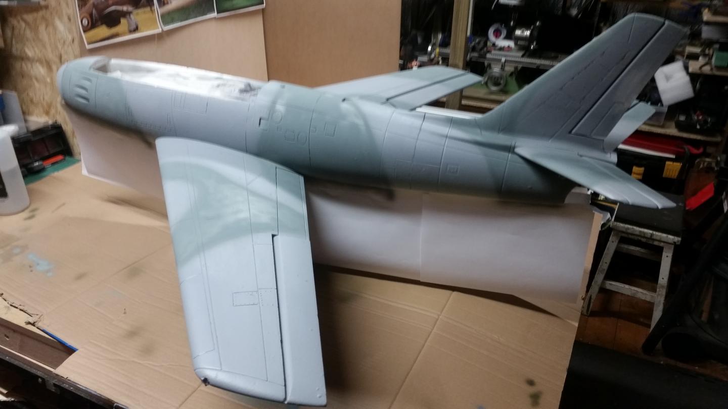

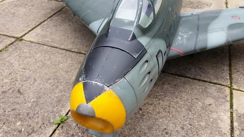

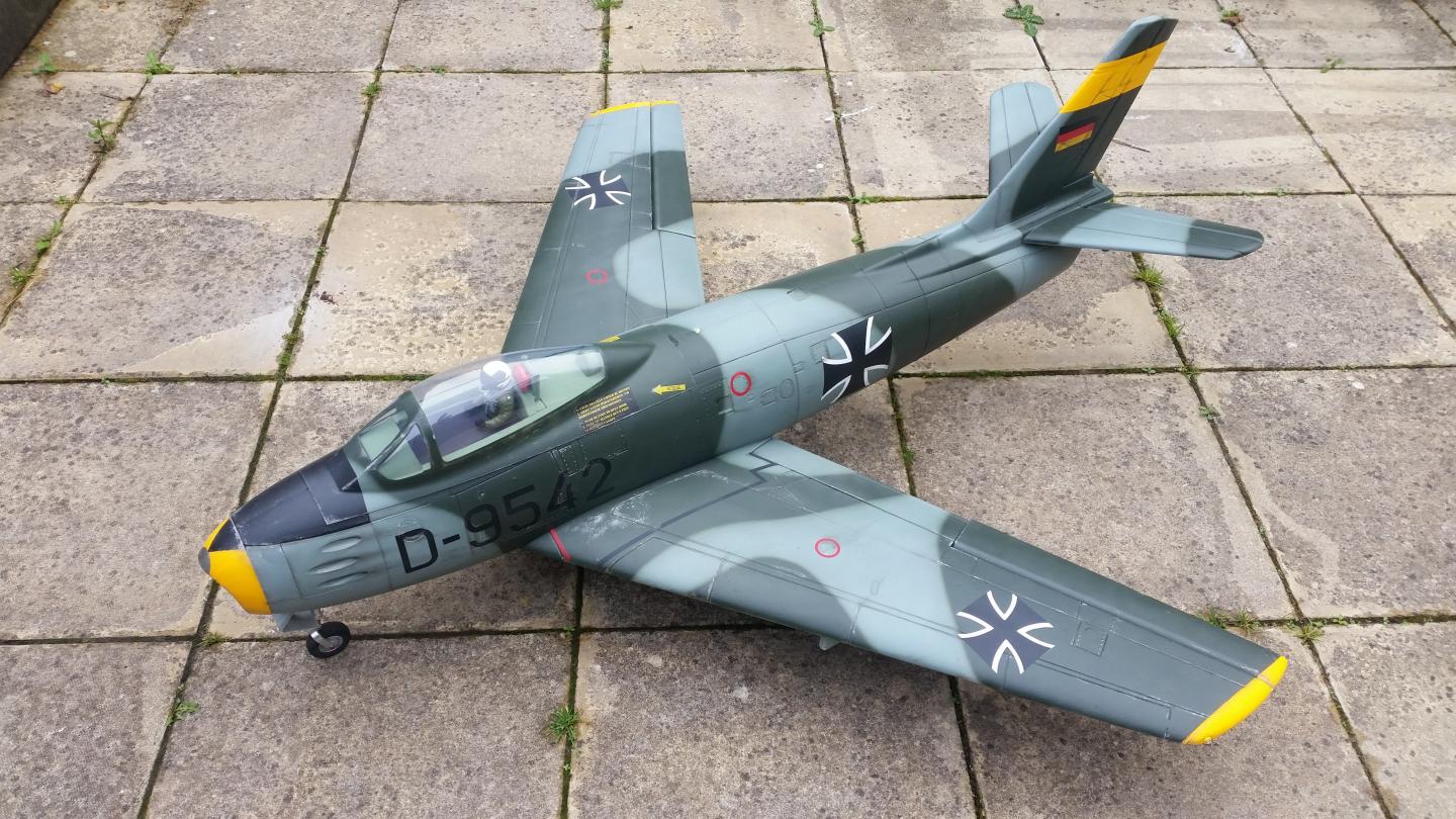

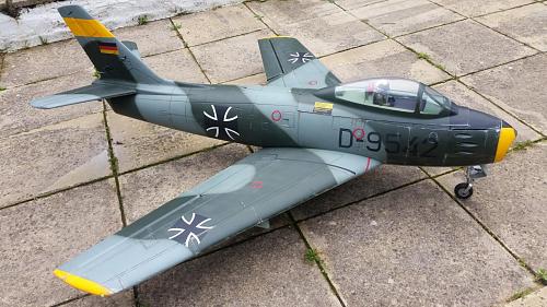

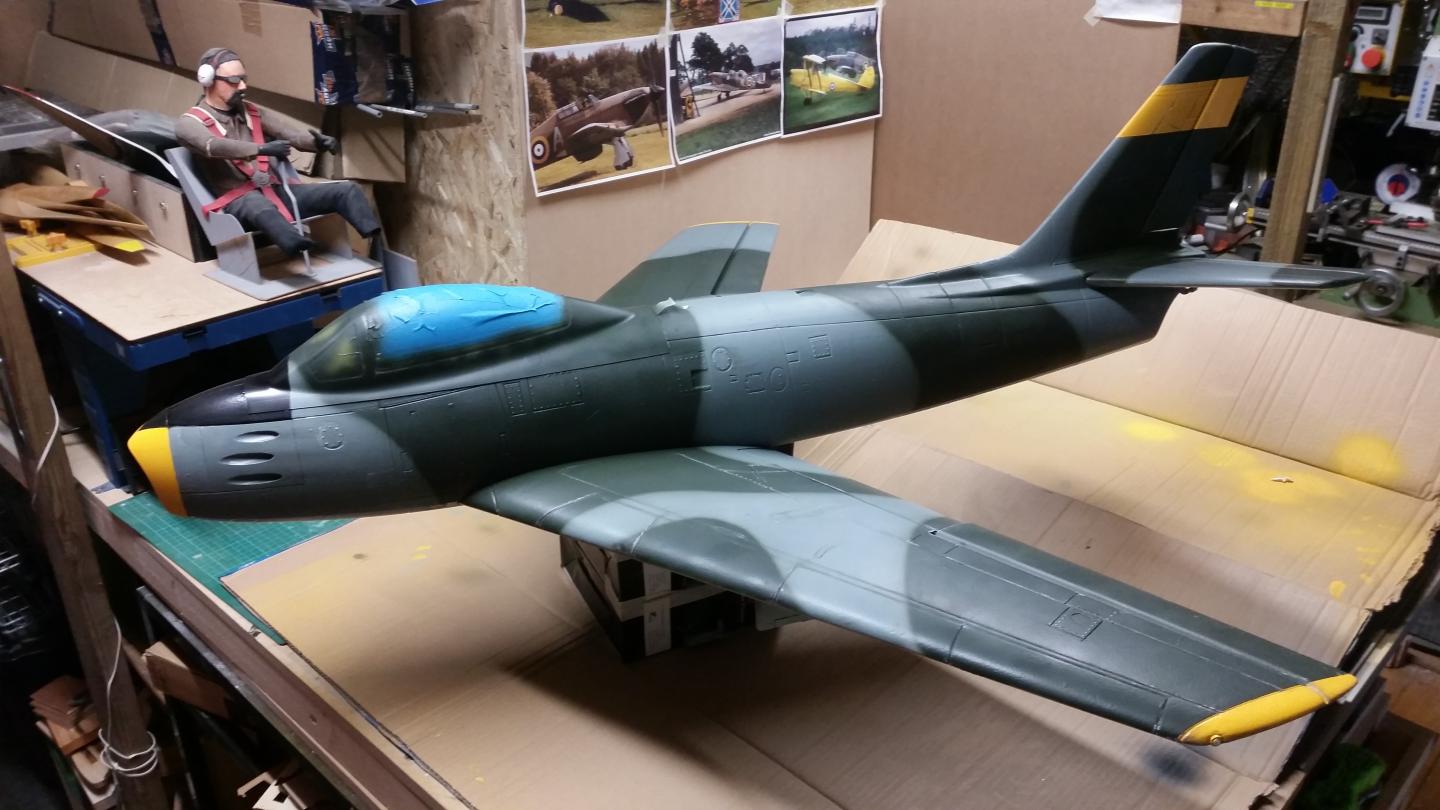

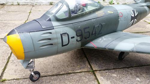

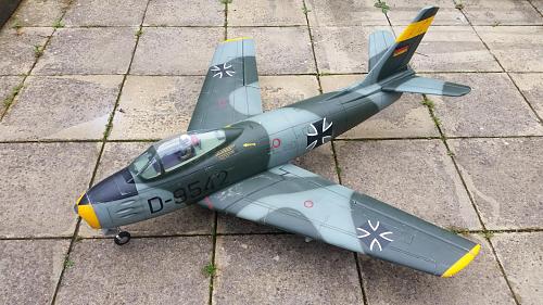

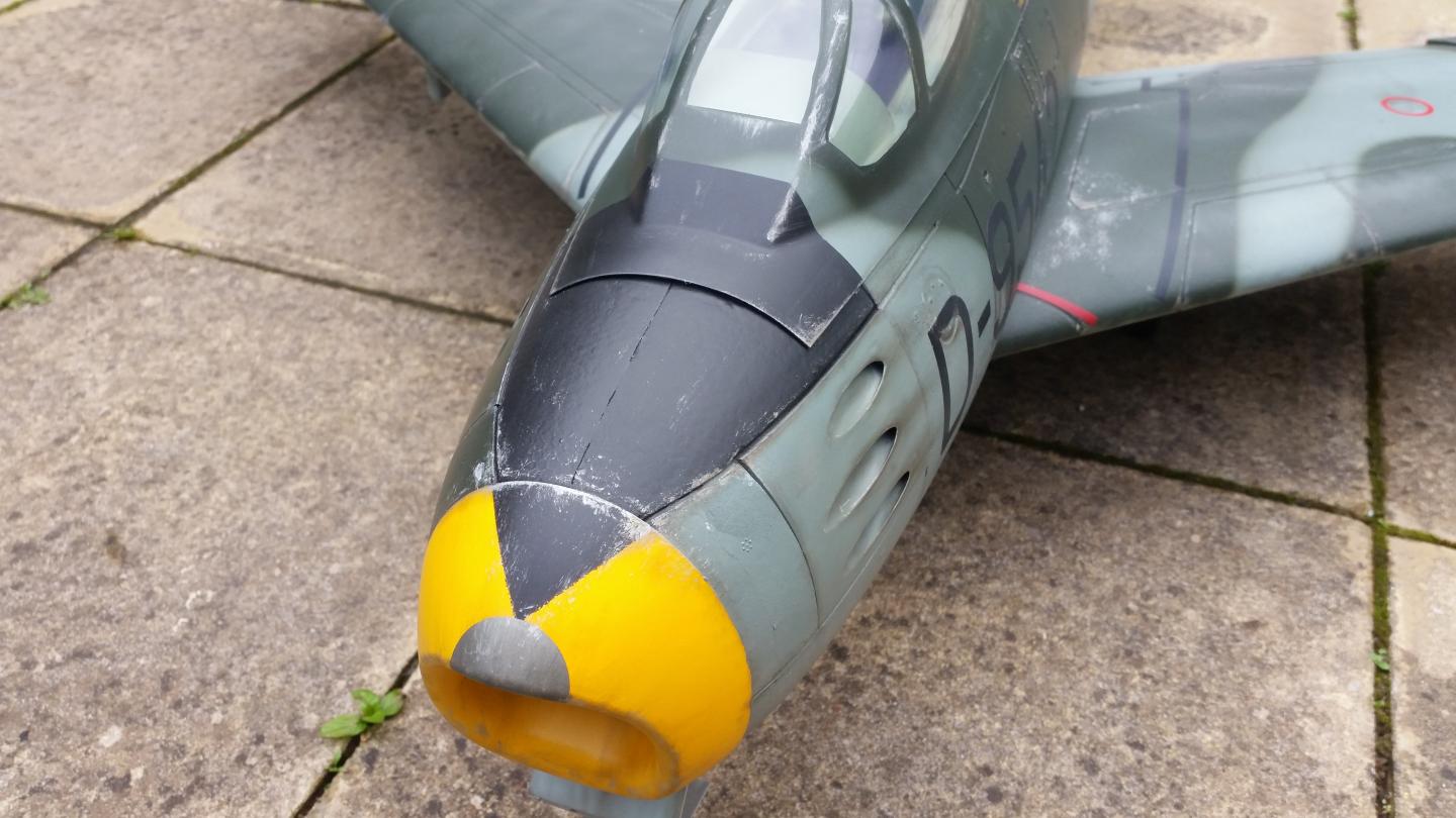

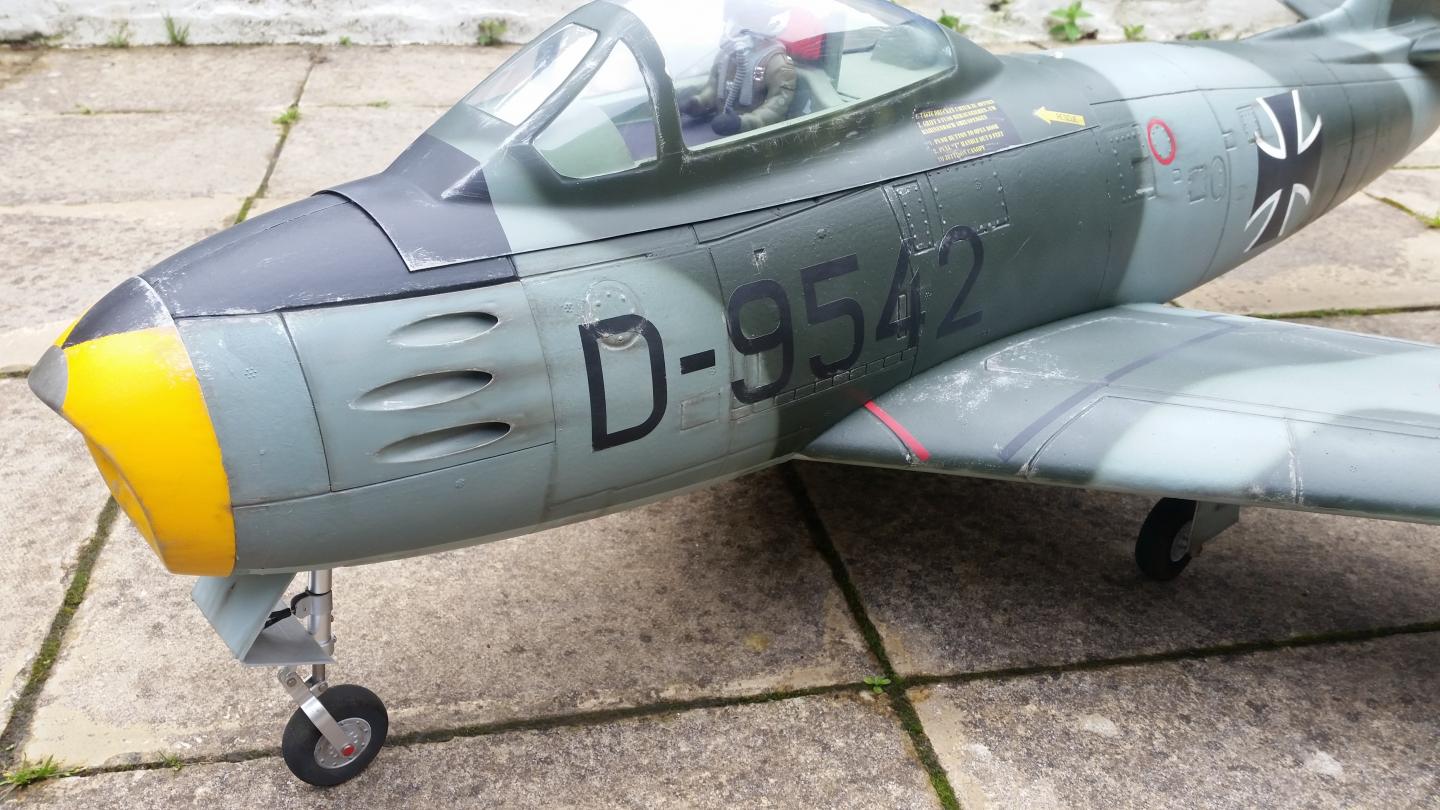

                                    While waiting for mig29 and saab gripen to arrive here in Scotland.
                                    I decided to repaint my 80mm F86
                                    Started with Tamiya primer over existing decals.
                                    Airbrush pattern with Tamiya paints
                                    Design and make my own graphics
                                    Weather and dirty with oil pastels
                                    then x2 coats clear matt acrylic varnish
                                    all done in x2 days
