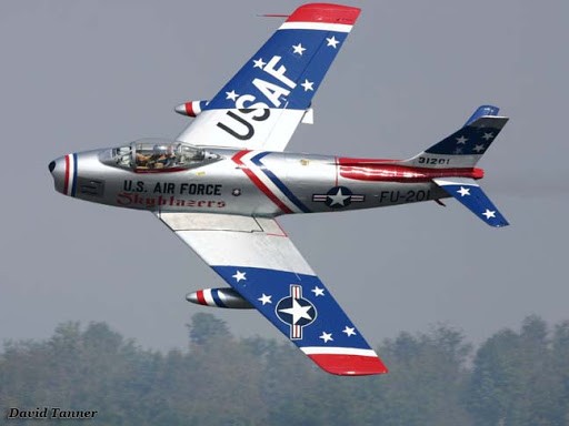

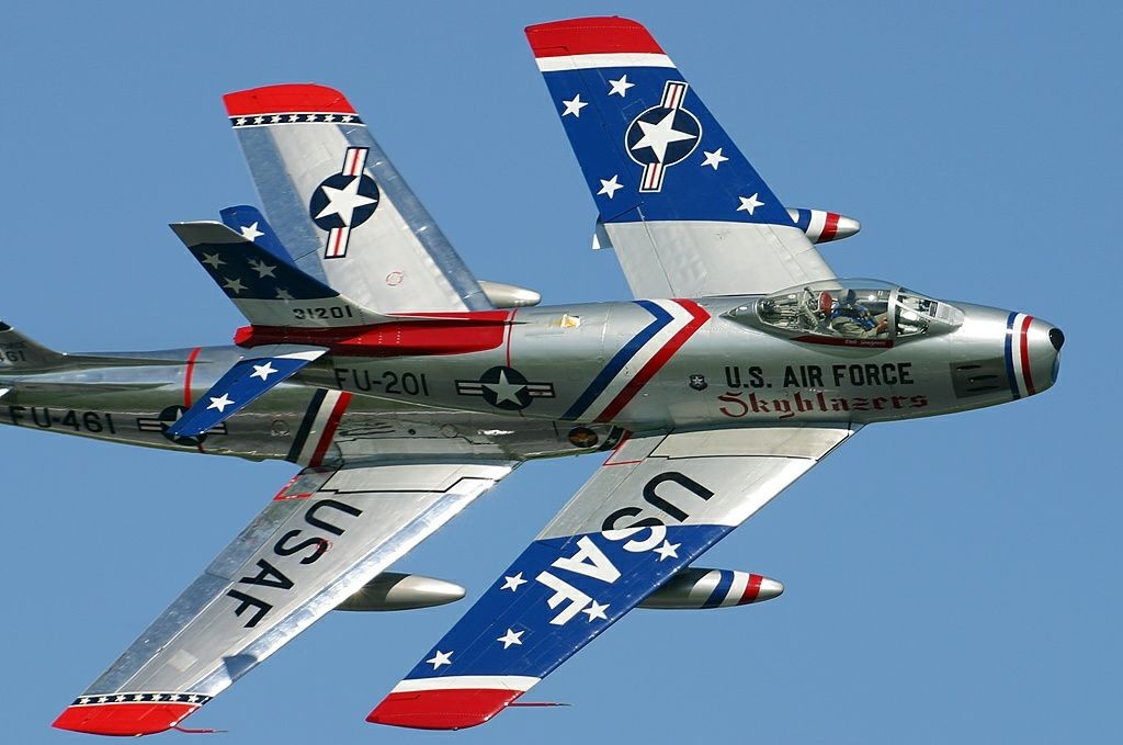

          I would paint it overall chrome then the red, white and blue Skyblazers paint scheme. Always loved that paint scheme.

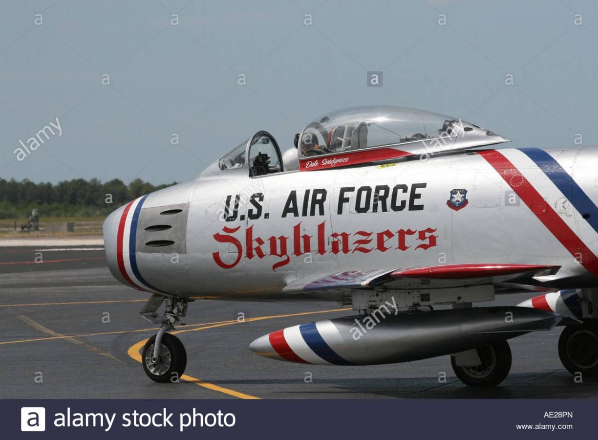

                    Hi guys,
                    I am trying to find some decent pictures to supply to Callie to get decals made for the Skyblazer paint scheme. There is a shield on the side of the fuselage and I cannot locate a decent picture to get decent details. Does anyone have a picture of this shield?
