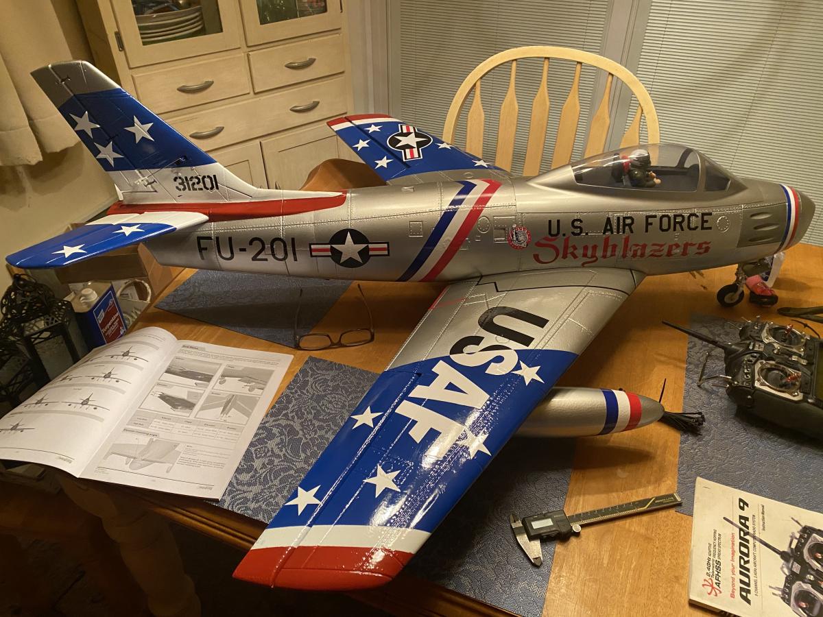

                  #648
                  Hi guys,
                  I received the Red, White and Blue stripes from Callie yesterday. They finish off the plane nicely. Now I can clear coat the entire plane and seal all the graphics.
                  Later!!
                  Anthony

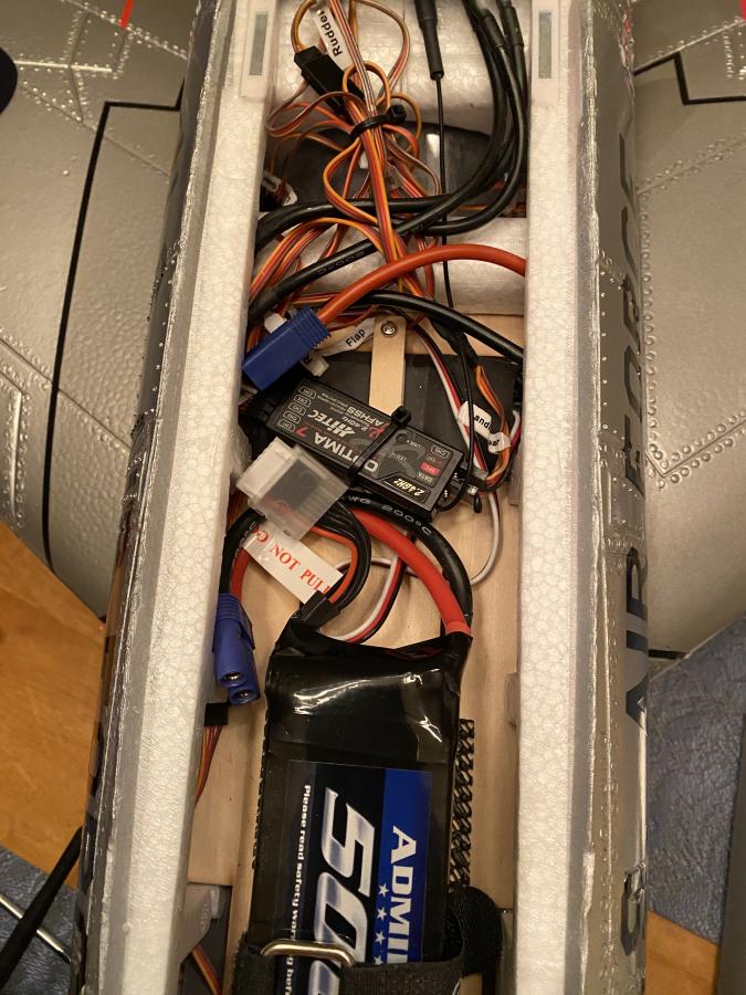

                                  #656
                                  I may do the mod to get the esc into the airflow, definitely can’t hurt.
                                  As far as CG goes I have the 5000mah battery moved further forward. The plane will rest on its tail and when I lift the tail about 1” it will gently fall forward to the nose gear.
                                  I put several coats of paint and Polycrylic on the plane as well as graphics which probably made it a little tail heavy. See the attached pic to show the battery position to achieve balance.

                                    #657
                                    That is way forward for an efficient CG.... even with the added weight. The lipo should be an inch aft at a minimum.
                                    just my opinion though...

                                      #658
                                      Wow, I've never seen a FW Sabre that would balance with a 5000 battery that far forward. Does your's have the new motor? Can't imagine it being that much heavier. I have my battery jammed all the way back almost against the fan intake shroud.

                                        #659
                                        I purchased the high performance version. Like I said it has several coats of paint plus 5-6 coats of Polycrylic. I am confident it is balanced correctly. If I moved the battery all the way back it will barely stay level on the nose gear. If you raise the nose a little it will fall on its tail.
                                        I sprayed 2-3 coats of Polycrylic to protect the chrome paint on the whole plane before applying the graphics and I sprayed 3 good coats after the graphics were applied. The surface of the plane is now smooth as glass.
                                        • Beeg
                                          • 1335
                                          • Texas
                                          #660
                                          From what you say the balance sounds right...
