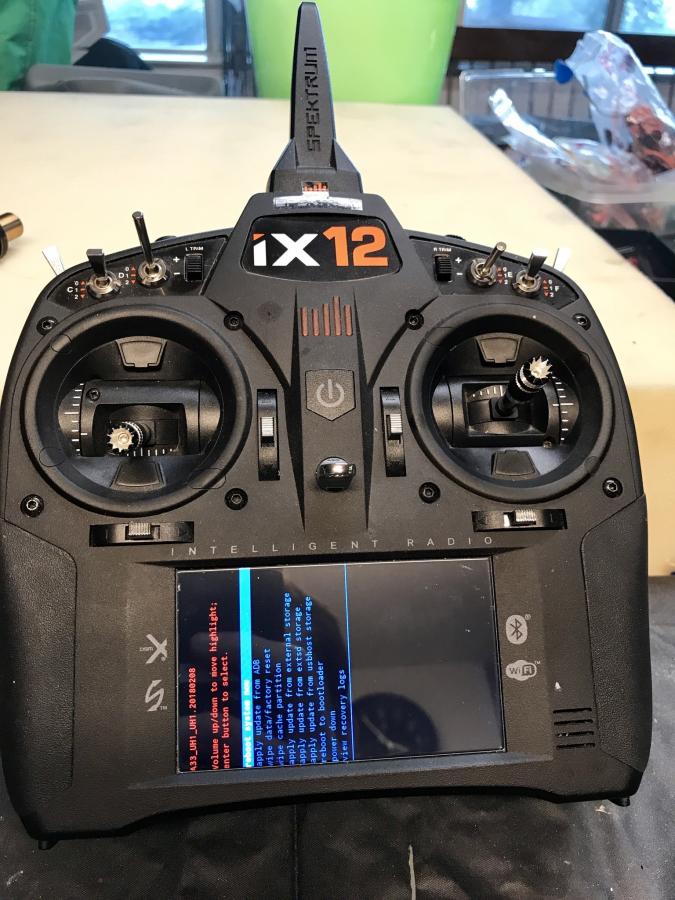

                                        hey C17 did you ever get the ix12 working correctly? everyone I know that has had that radio sold it for the dx9...
                                        • C17loadmaster
                                          Retired USAF Aircrew
                                          • May 2018
                                          • 371
                                          • Auburn, CA
                                          #480
                                          Yeah I have it going. It’s been a pain to deal with a few times in the past year. Other than that it’s been great. It always seems to be an issue after a firmware update. At least I didn’t drive an hour and load up a bunch of planes.
                                          ...and to think I sold a DX-18 to get it :frown:
