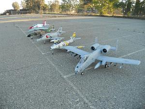

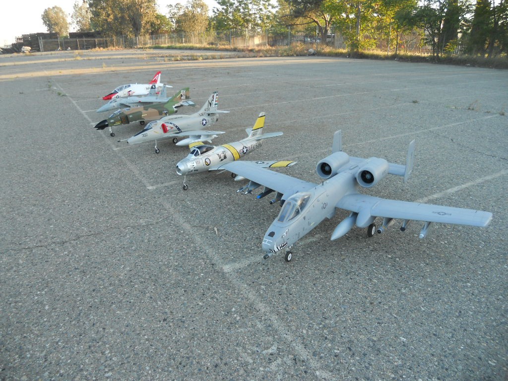

                    I never had an issue with mine doing that, mine was giving to me and was crashed, the guy flew it into a chainlink fence and broke it in half, he put several flights on it before that, I repaired it and it is still on the original retracts, they are so sloppy it wobbles down the runway like an old granny, we pass my radio around and let others fly it as well, we have beat the tar out of it and it is still going strong 2 yrs later, I fly it with a 5000 45c and 60c Gensace lipo, it has got to be the best EDF out there to learn on I would say for 80mm. You will enjoy it and yes I do use a little opposite rudder in a turn only when I want to do a nice scale turn but other than that, it's turn and burn for this poor little Sabre.
                    Here he is playing with my other big boys..............:Cool:
