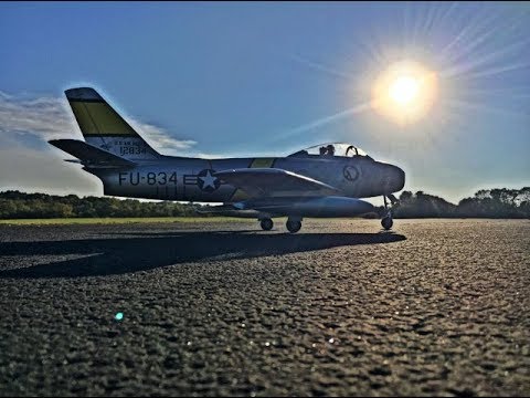

                                      New to this forum but long-time RCGroups user (RGS2010)...here is my last F-86 video...just isn't a smoother, great-sounding 80mm edf out there! Love it, love it, love it … recently upgraded motor/fan to FMS 80mm 12-blade version and now uses same amount of gas out of the tank but about 15-20% more power...Enjoy!

                                        #399
                                        Looks good! I love mine. Was the upgrade an easy motor swap? I’ve read several folks upgrading theirs.
                                          Gotta love the FMS fans! They did a great job with their design and I have upgraded a couple of the Freewing birds with this lighter more powerful fans! It is my go to fan and I use them in almost everything now.
