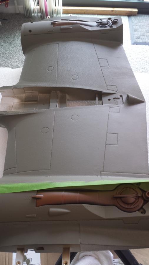

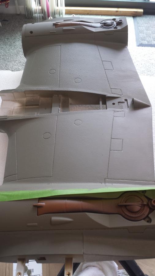

        I have had very good luck wet sanding the foam and laying up latex or primer coats. Wet-sand with 400 glued on a firm foam block. The water keeps the foam from building up heat which adds to the gator effect. the 2nd pic shows the lower side completed Click image for larger version
ID:	245340Click image for larger version
        good luck.

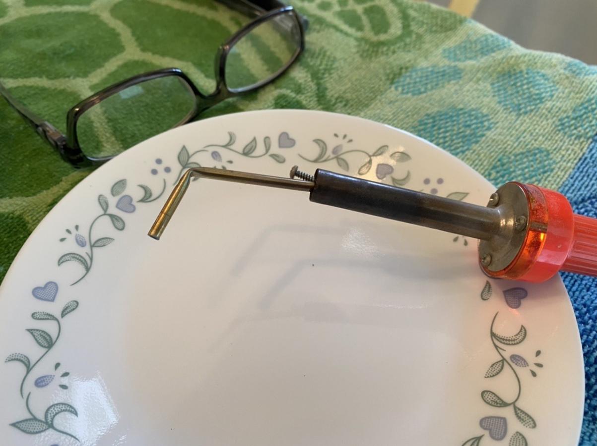

                  I have the fuselage all smoothed out. I am putting flush rivets into the fuse. I am using a piece of brass tubing inserted into a soldering iron. Just a quick light press onto the surface does the trick. I then press down on the rivet with my finger to set the surface back down. After I am finished they will get a light sanding with 400 grit.

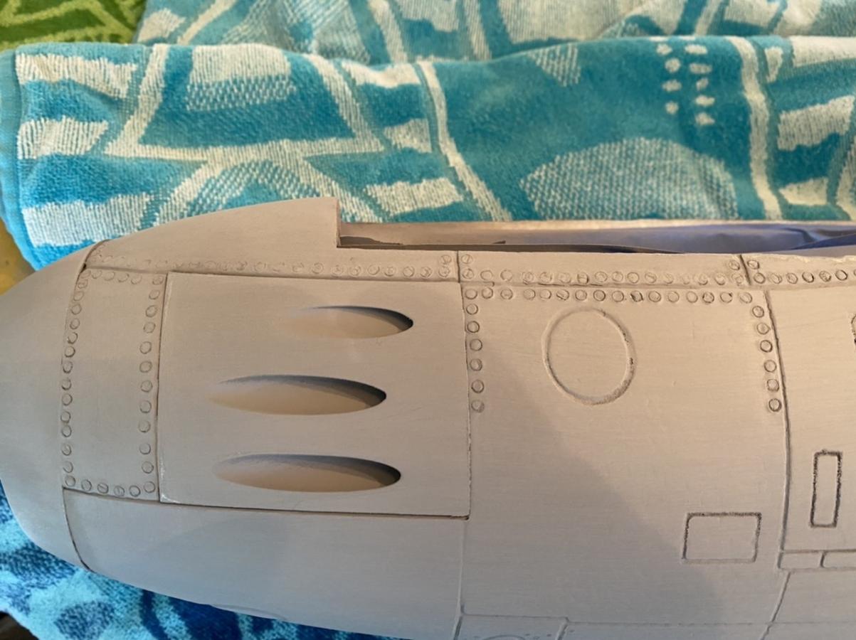

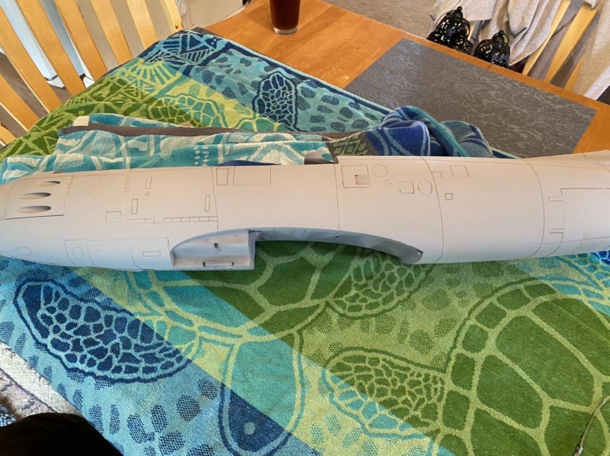

                      After a 4 hour eye crossing marathon run all flush rivets are applied to the fuse. Now a light 400 grit sanding.

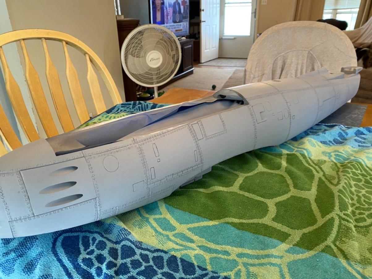

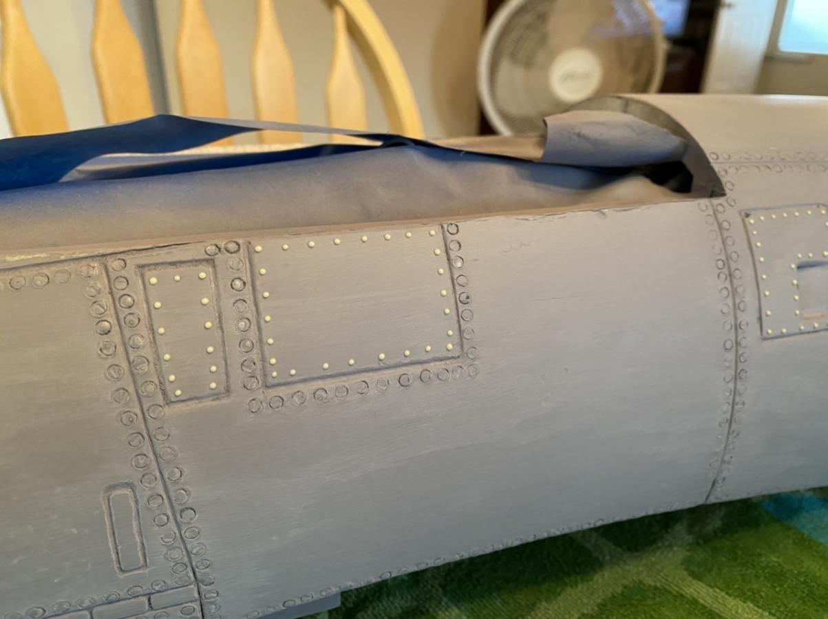

                          I cleaned the fuse and wiped it down with alcohol. I used a syringe and wood glue to reapply the rivets/screw heads that I sanded off while smoothing out the fuselage. Once these have dried the paint can go on.

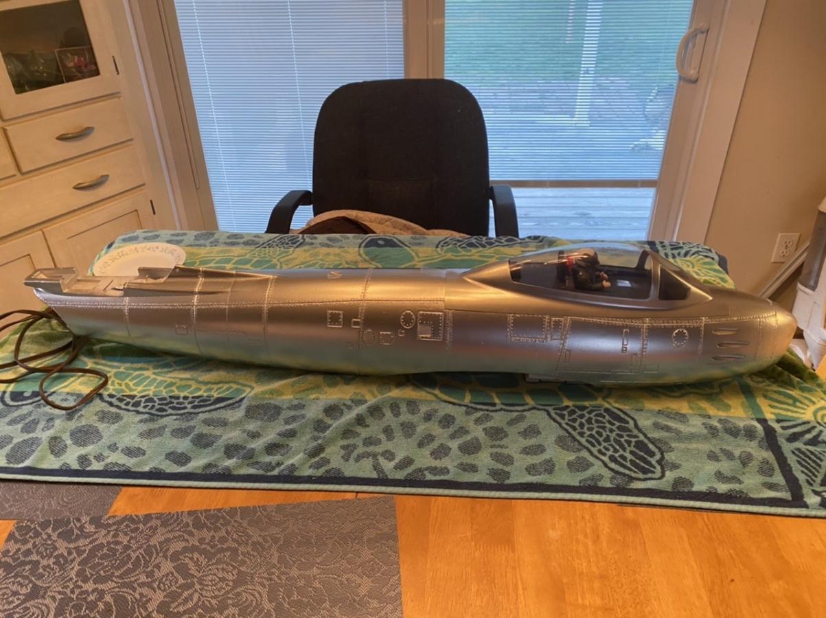

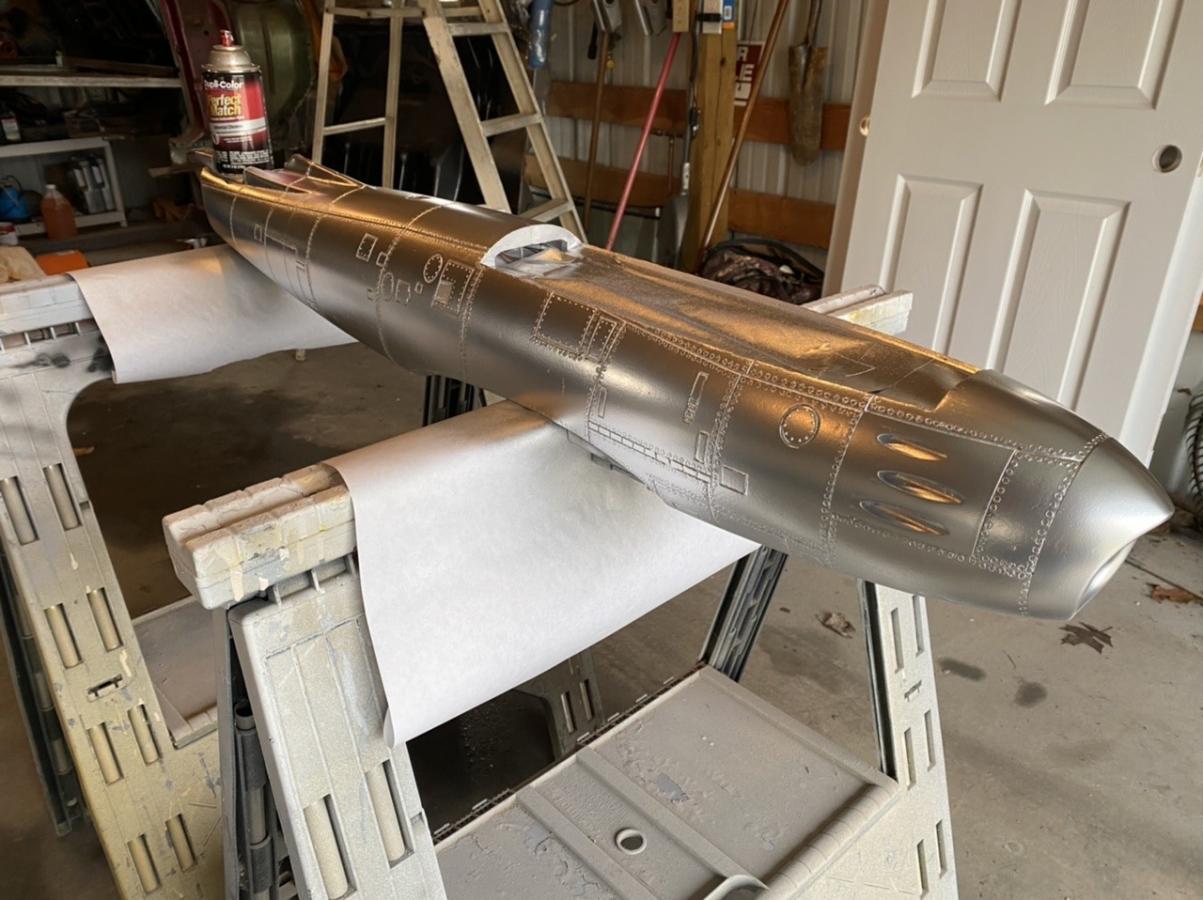

                            WOW,
                            Chrome paint does not replicate chrome very well but it does replicate polished aluminum almost to a “t”.
                            I can’t wait till it dries so I can hit the bottom side.

                              In my experience you will need to spray a clear coat over the chrome because the chrome spray is not very durable. It rubs off on your hands.
                              That will further dull it a little.

                                Some dulling might not be a bad thing. I would spray a test piece and run a fine scotch bright pad over it and see what find of effect you get .

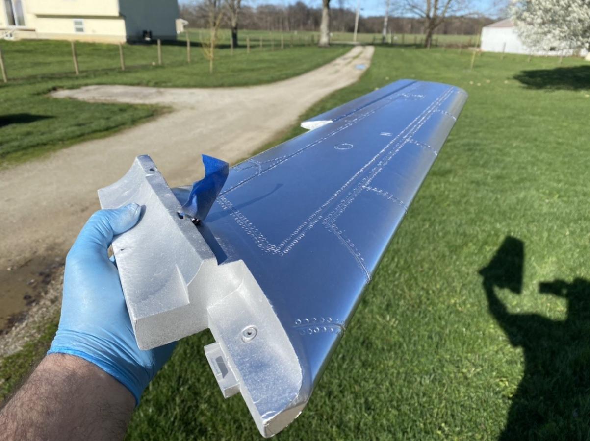

                                          #620
                                          The chrome is painted on the wings. I added the rivet details to the tail surfaces and have the chrome and white painted on them as well. The wings and tail surfaces will have to cure out for several days before I can mask and spray the blue and red paint.
