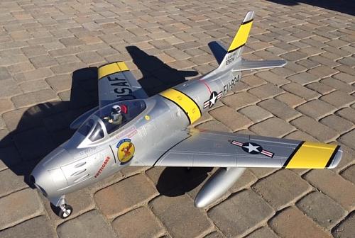

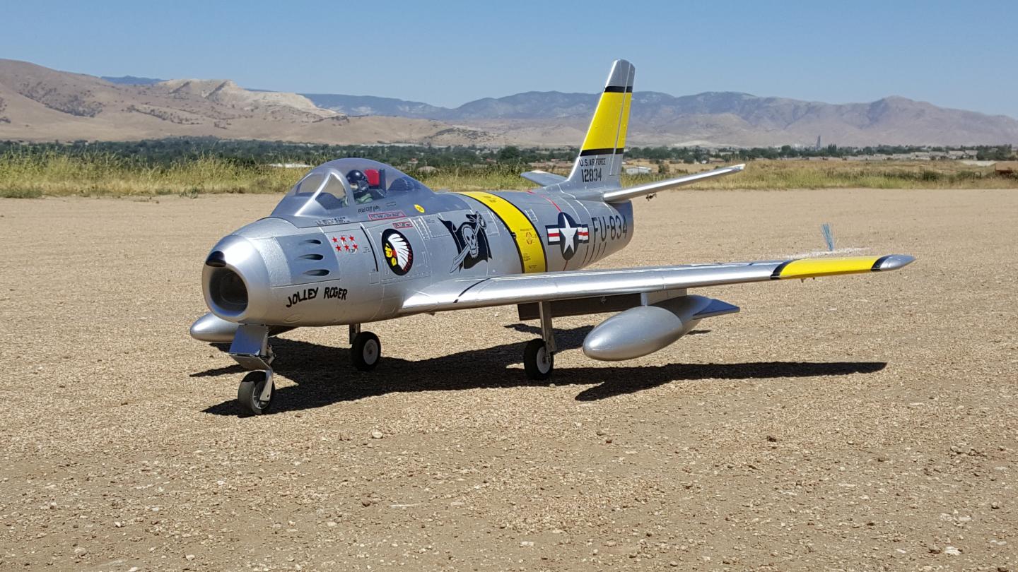

ID:	258370 My rendition of the 334th Fighter Squadron "Fighting Eagles" F-86. My Father was flying the F-86 in Korea when I was 1yr. old (1953)

      AJ, Great work on your Sabre, Sir. I thank your father, you, and your family for his service. Best, LB

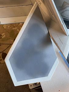

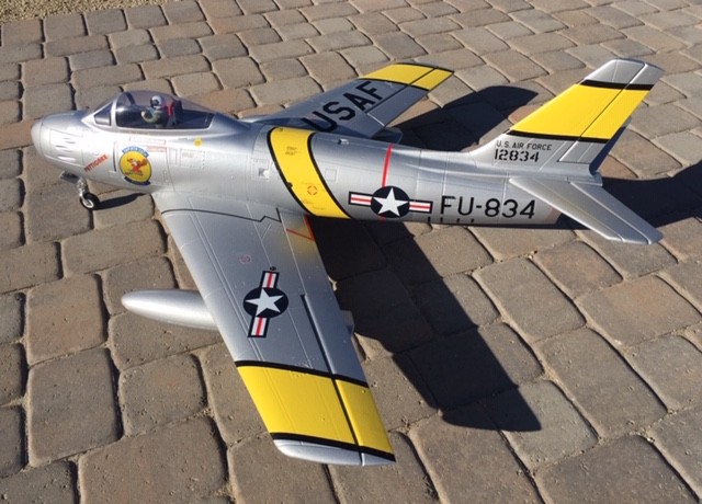

                          I finally got mine together. It is wrapped with Oracal 751 vinyl film and lettered with decals from Callie. With a little luck I'll maiden this weekend.
                          Sorry Ron... I looked back and found the post I was referencing. Time flies! Almost two years ago when I stole the idea from wvrailfan. I had used it before on a small scale, but now i use vinyl on almost every plane I repair or give a makeover.
                          You can use an iron, preferably a monocote iron, on LOW HEAT to get rid of all the imperfections. It covers holes, servo lead channels, and about anything you want covered. When the iron heats it the vinyl tightens up like a drum. You can paint it however you like afterwards...

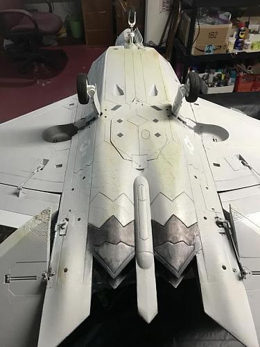

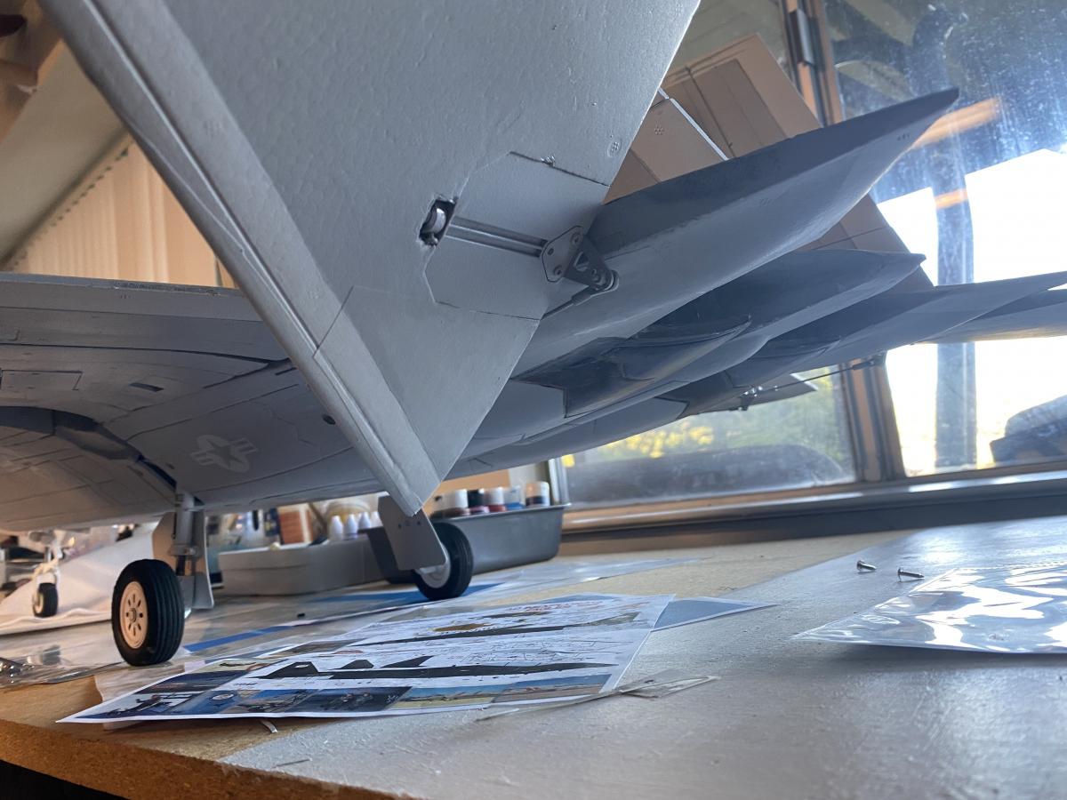

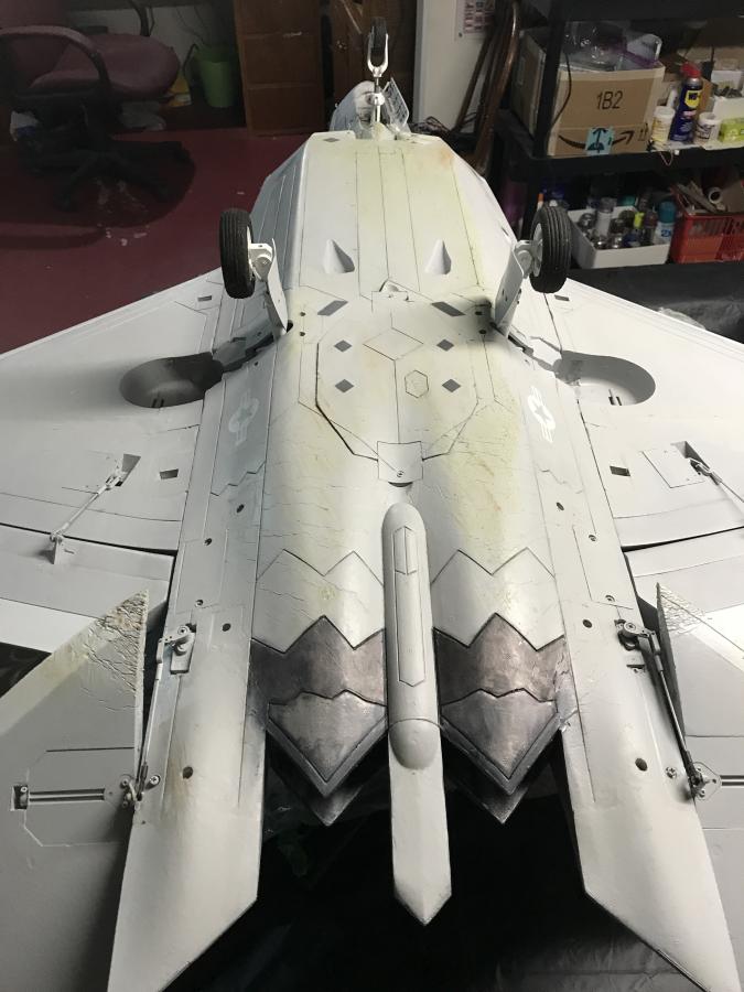

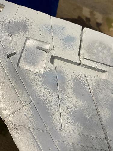

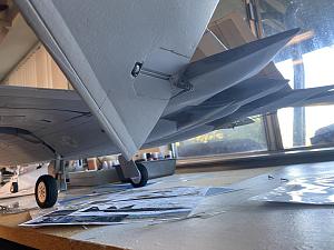

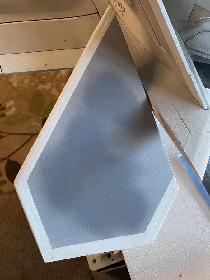

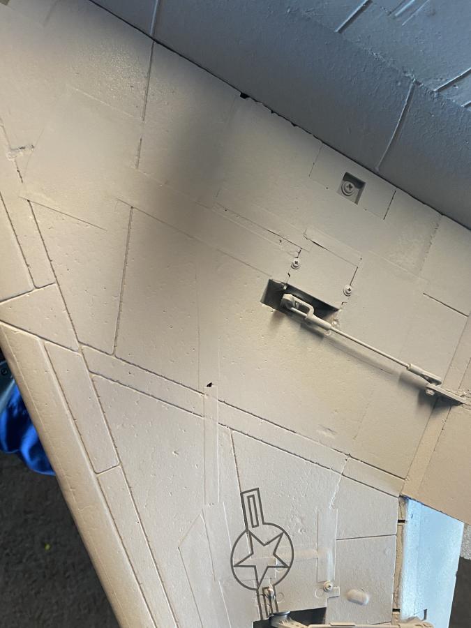

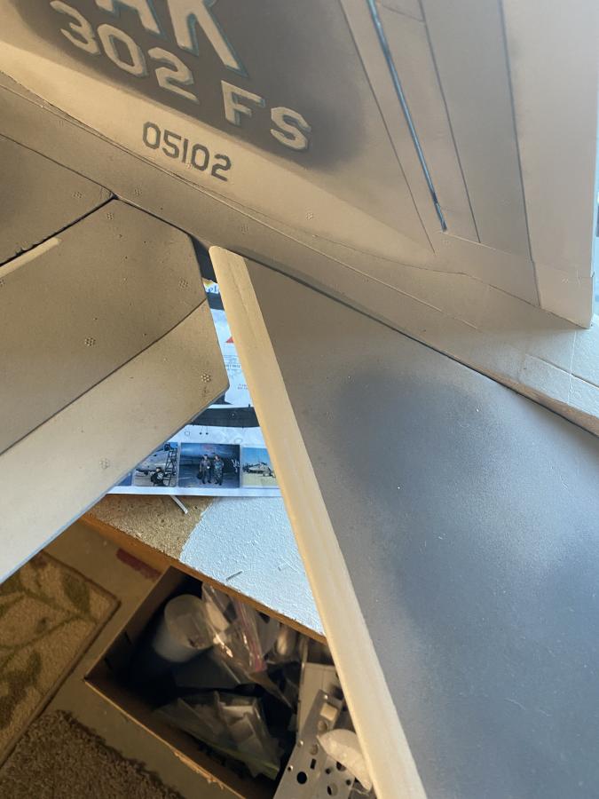

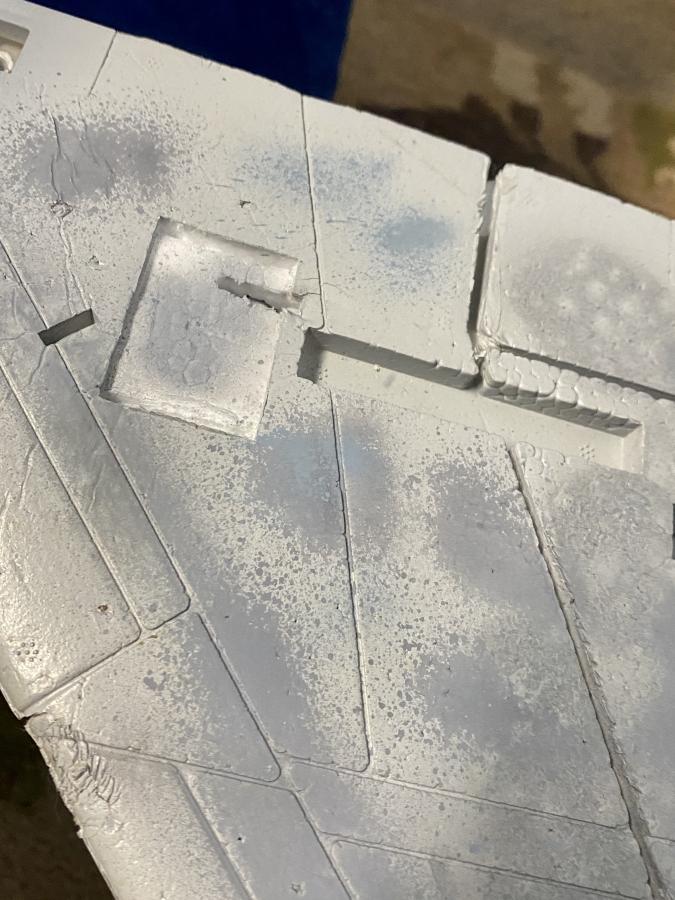

                            Here is some examples of what I was trying to explain... the first pic is of a F-15 I am almost done refinishing. The second pic is a wrecked wing, but it shows the open areas that are easily covered.
                            Then that's my F-22 I crashed flying when it was too dark. The only park I had to buy was nose gear doors. One of them broke. The entire top of the stab now is covered in vinyl. Also, you can see where I repaired the forward section of the bottom that elevator. It's much stronger than before...
                            Here is the crash
