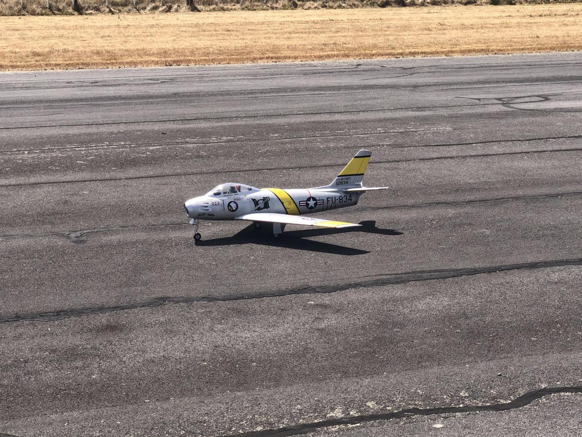

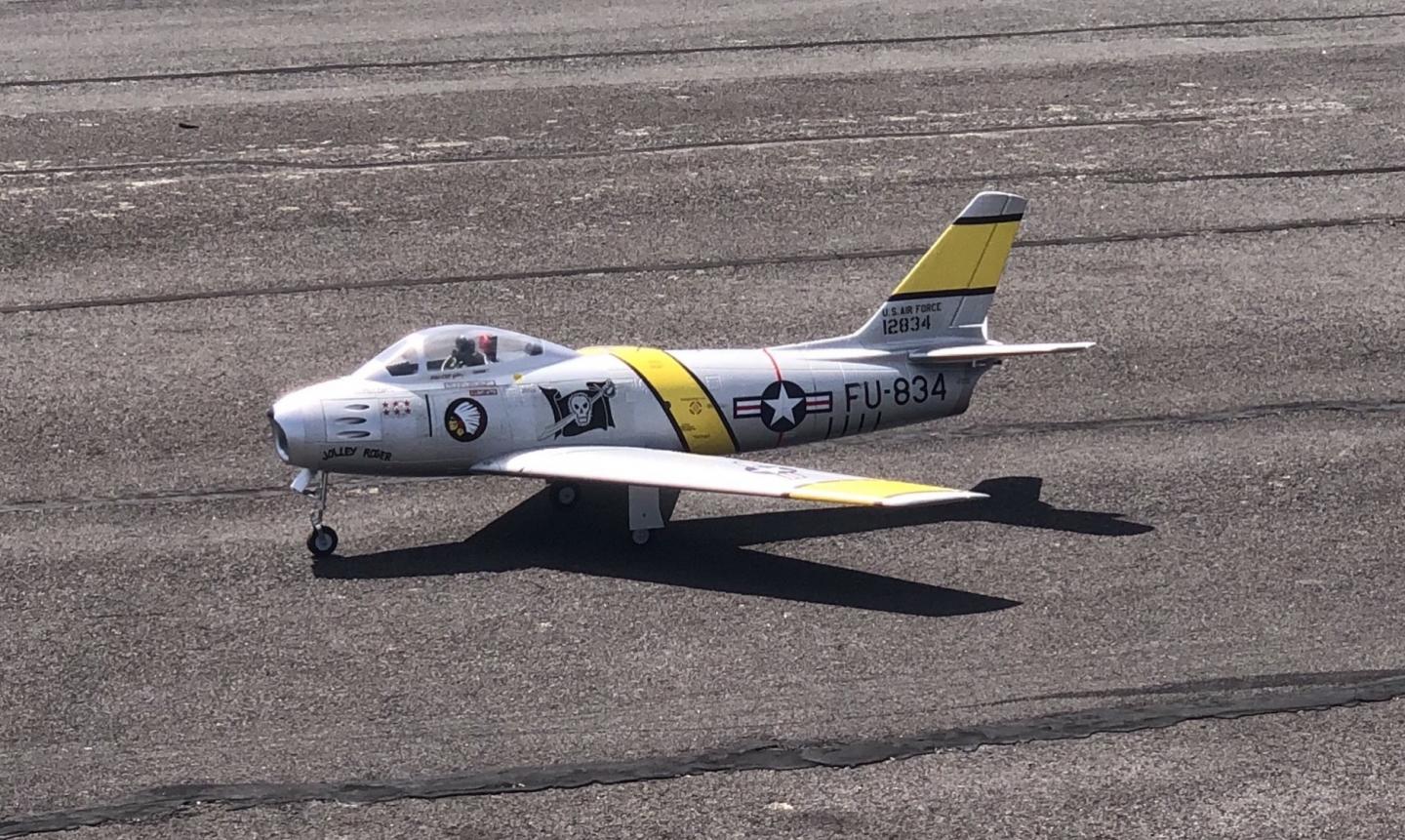

      I never got around to adding my drop tanks, and now i prefer it without them added so possibly never will-had mine 4 years, fantastic plane! No plans to swap the fan, the 12 blade outrunner works just fine. Photos on the runway at Tokoroa, NZ last summer.
        Looking good Builda, thats a lot of years relaxed flying ahead, enjoy them all.
