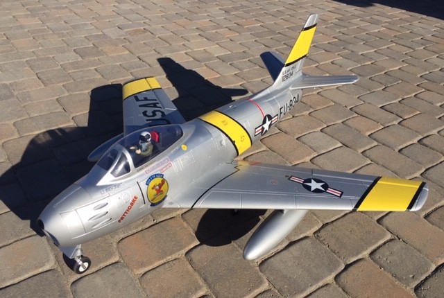

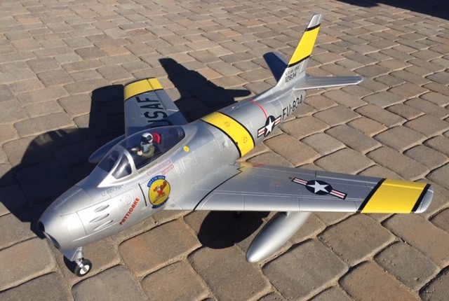

                            #793
                            I'm looking forward to Summer flying! Click image for larger version

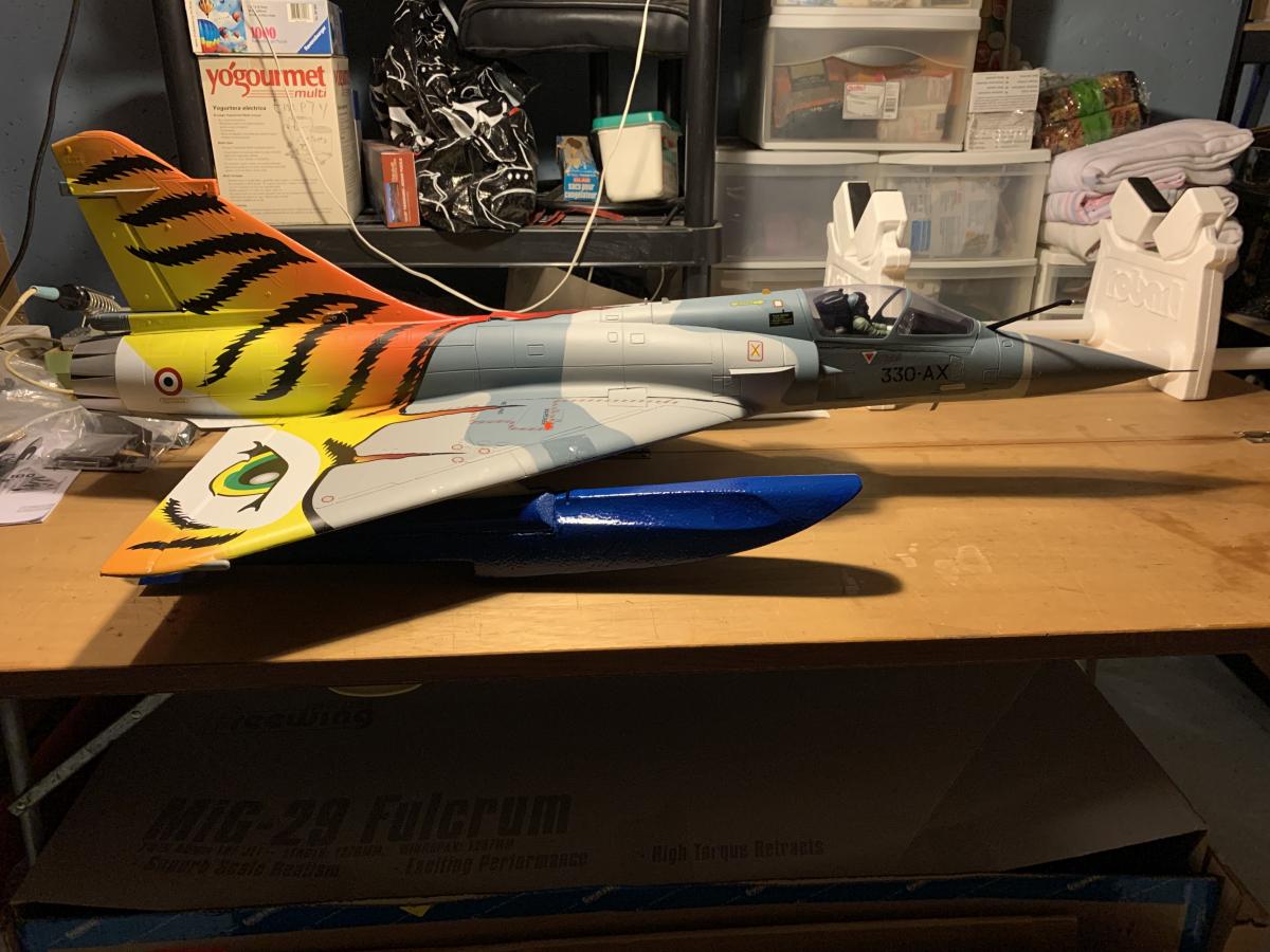

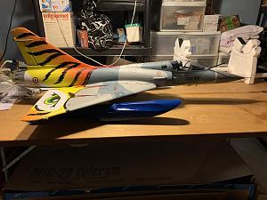

                                      #798
                                      Originally posted by C17loadmaster
                                      It would be awesome if it was as easy as gluing the oversized drop tanks on, but adding something to the bottom to strengthen them up and make them a little bit slicker of a surface to rotate off of. Like the plastic protectors that come glued onto the ME-262's nacelles.Only issue I can see is actually rotating for takeoff... You would be restricted by the exhaust port, which is only a few inches from the ground. You would need a good amount of speed.... but I'm sure it can be done.
                                      I think skis would work even better than the floats do on my Mirage. When the snow/ice is hard and cold, skis should slide really well. Thinking about it some more, it might be better to remove the wheels and adapt the skis to the struts - just disable the retracts so as to not accidentally retract them when the skis are on.
                                      Here's a video of one of my first flights of the Mirage on floats. It goes really fast on take off. It took me a few flights to ease up on the ELE so it didn't LEAP into the air and to also not high alpha so much on landing when the power is cut. That was all to do with practice with throttle management. BTW, not only was this the Mirage's maiden with floats but it was it's maiden - brand new plane, never flown with wheels. I used the stock wing tank mounts (reinforced) and floats from a HobbyKing Tundra. I cut out the mounting section from the Mirage's wing tanks to use for standard attachment (magnet) but reinforced with a little glue. The bottom of the floats were lined with clear Gorilla tape.
                                      This F-86 should be just the same when it comes to adapting floats and I've seen a Viperjet with skis, so that should be also an easy do.
