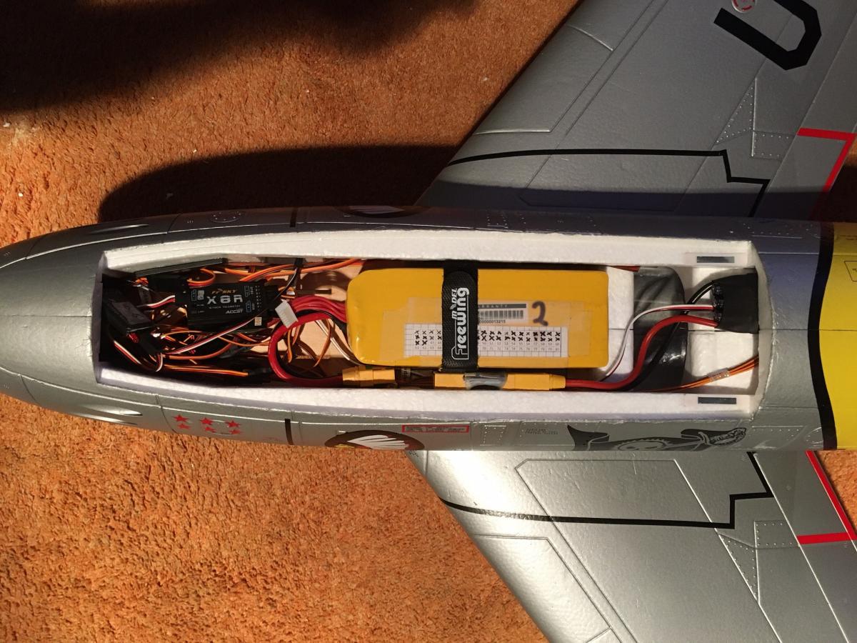

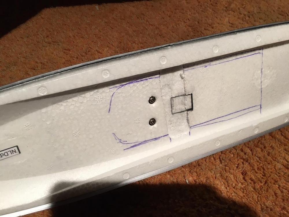

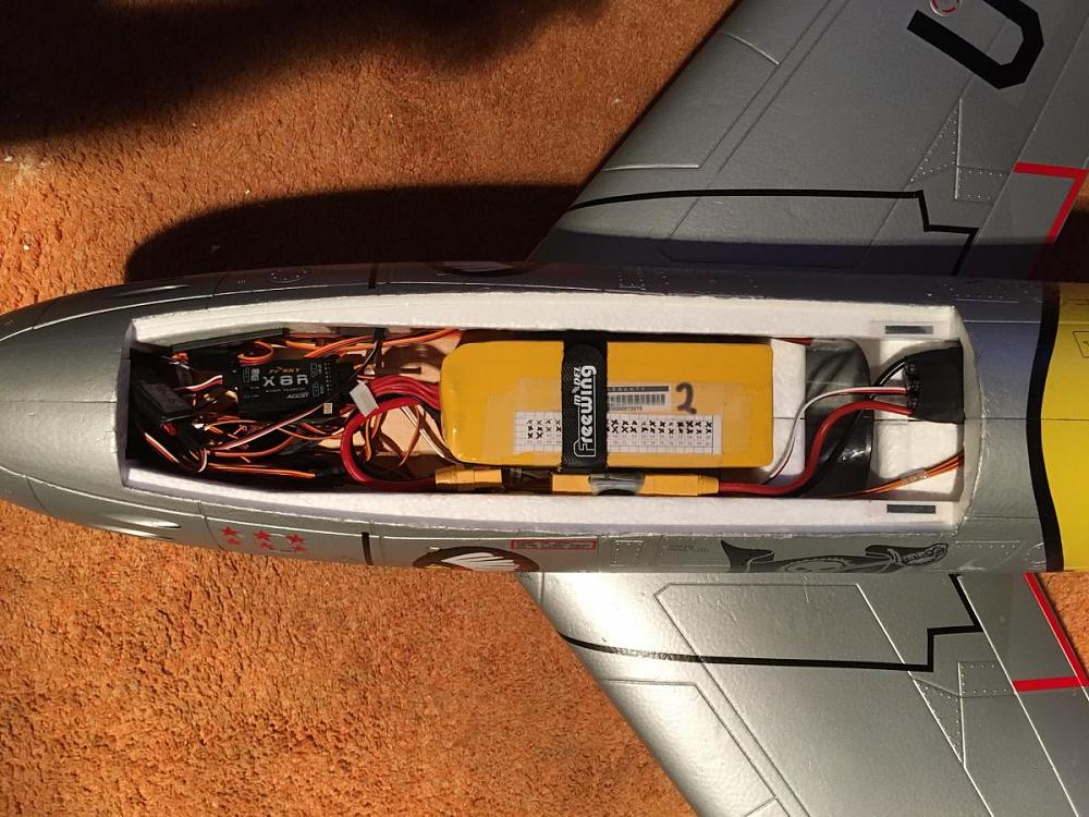

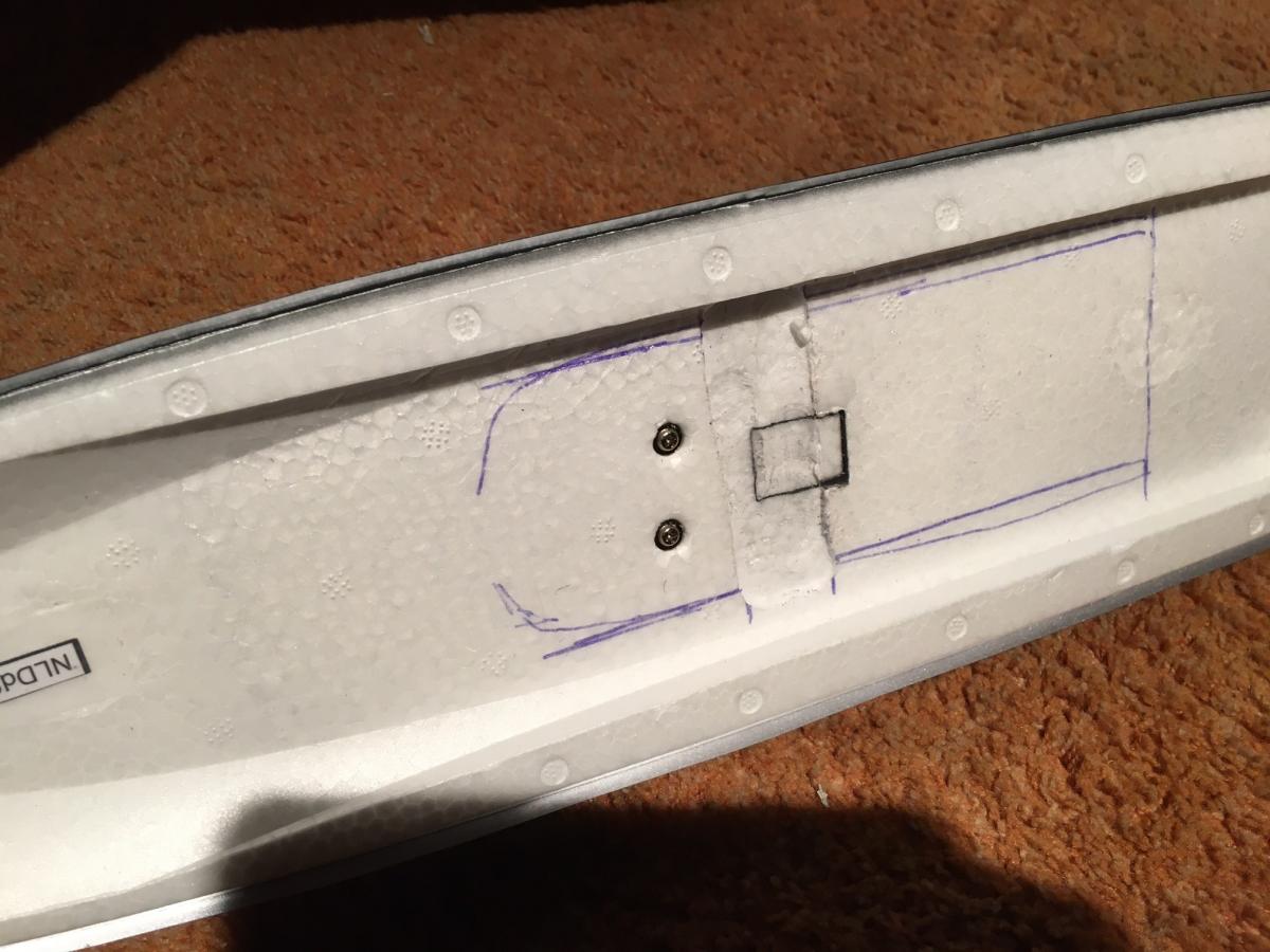

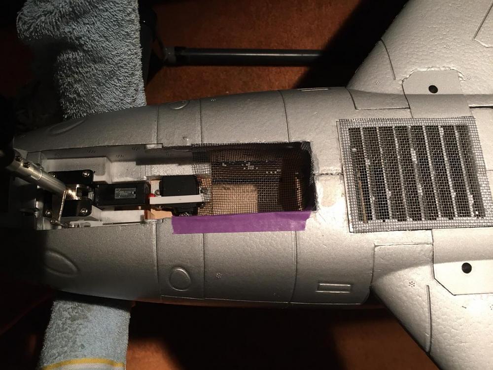

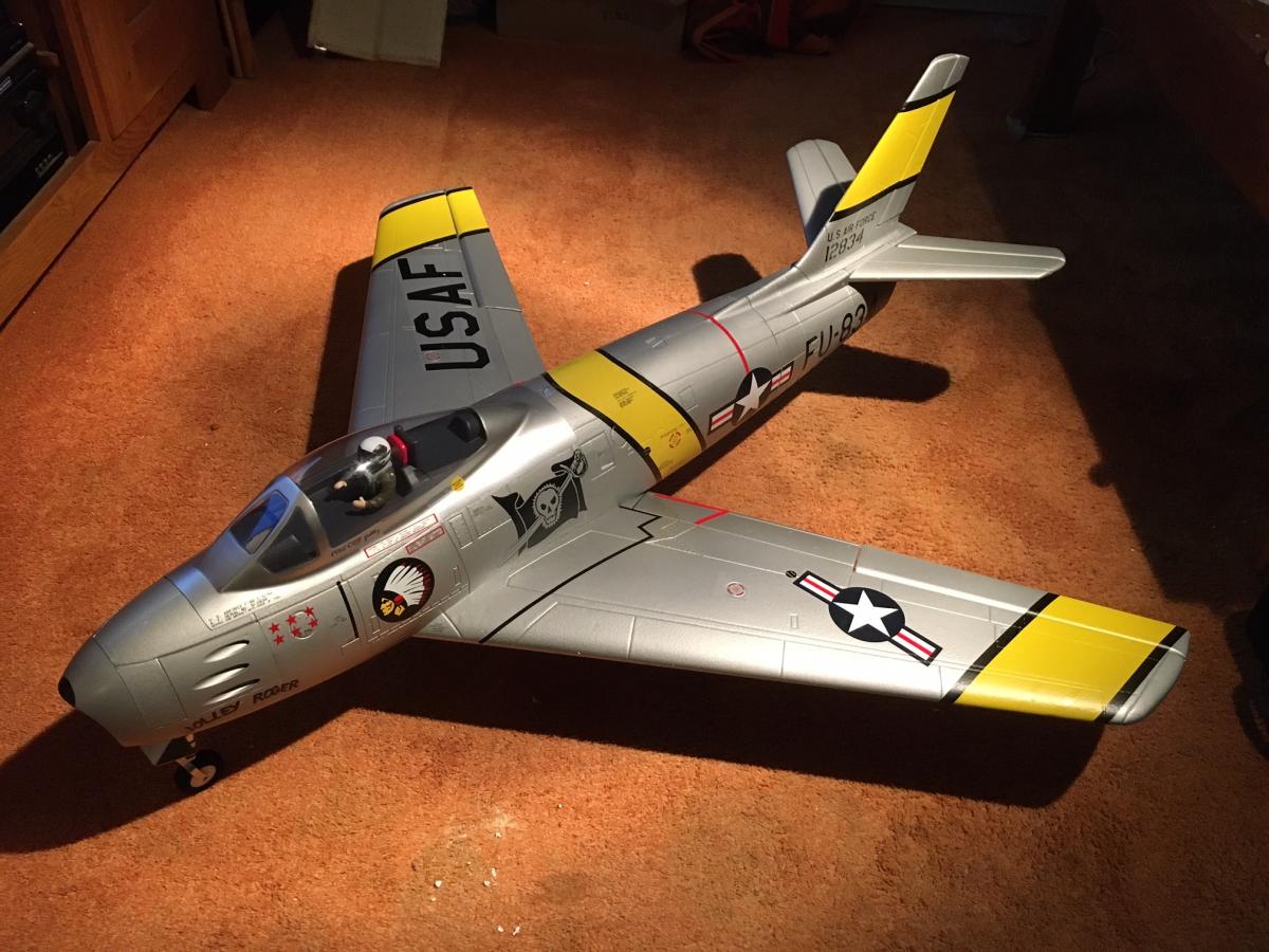

                              Update about progress F86
                              Originally posted by timmybeetle
                              Received my F86 High Performance
                              1. well packed and looking very nice.
                              2. know that I have it at home I noticed that wing is not easy to remove for transport, compared to my FW T33.( in manual looks easy ha ha )
                              Will see in practice with wing installed how I will take it to the flying field
                              3. I have 6S Rhino and CNHL they are heavier and bigger, so testing them in my plane for CG I have to get them as far back as possible.
                              6S5000-50C 900 gram, CNHL 6S-70C 850 gram and CNHL 65C 760 gram.
                              Plane balanced perfect with 6S Rhino at position see pic below.
                              4. ESC has to move it's position.
                              I think its now located at old ESC position, will check heat because no cooling there yet!
                              5. Canopy does not fit with my Lipo's will see how to get it done.
                              Checked with LIPO installed and noticed that strap was only thing to high,modified canopy wit a little removal of foam see pic.
                              6. Think I move my RCVR up front !
                              yep I moved it in front of nose, used longer servo cable to get there and this also improved my wing assembly

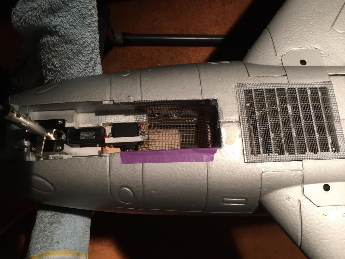

                              7. Cheater mesh cover because I fly from grass.
                              Installed mesh on cheater and front gear mounting place
                              8. Check LG in main wing for if its glued in well, same issue as with FW T33 ?
                              Pulled hard on LG's seems to be ok, will check after every flight to be sure.
                              Well take my time to get it sorted out.
                              Was a quick build once started 😂
                              Grts Hans
