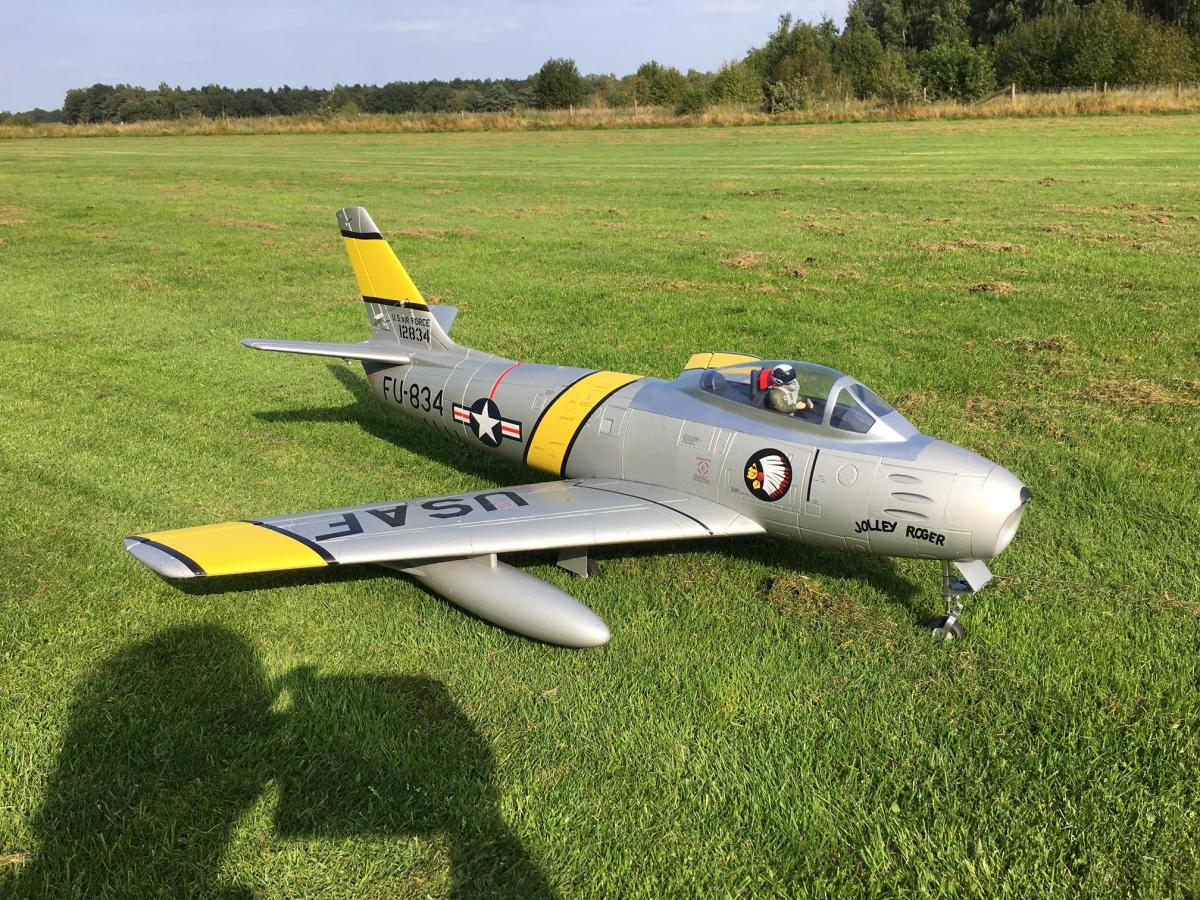

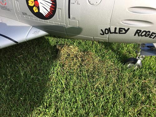

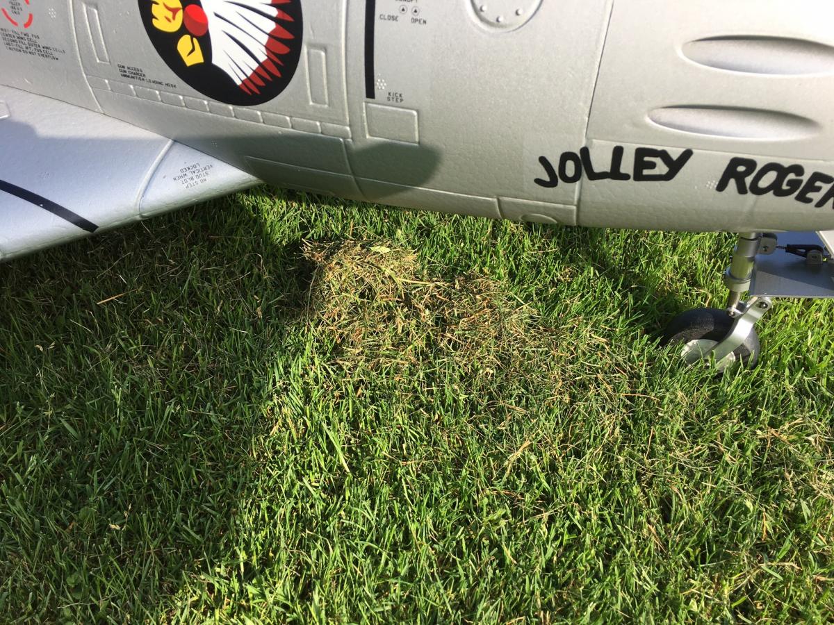

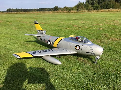

      Flew my F86 yesterday 20 sep 2021, grass as short as possible on a warm day.
      Flew great and a joy to fly, without and with tanks installed.
      Today 21 sep 2021 evening around 17Hr, used my heavier RHINO lipo just came into the air.
      A bit later dawn is already coming in and not able to take off any more.
      I had my FW T33 with me also, so flew with it, no issues getting airborne.
      Well what the difference between models, the T33 has bigger main wheels (68mm to 50mm and I already used 56mm wheels I had lying around).
      So for grass ops I think I will need to install the bigger main wheels of the T33 on my F86......
      Grts Hans
      ps I installed mesh in my front gear, I noticed A lot of air is sucked in there, loose grass is fallen out when I stop my motor

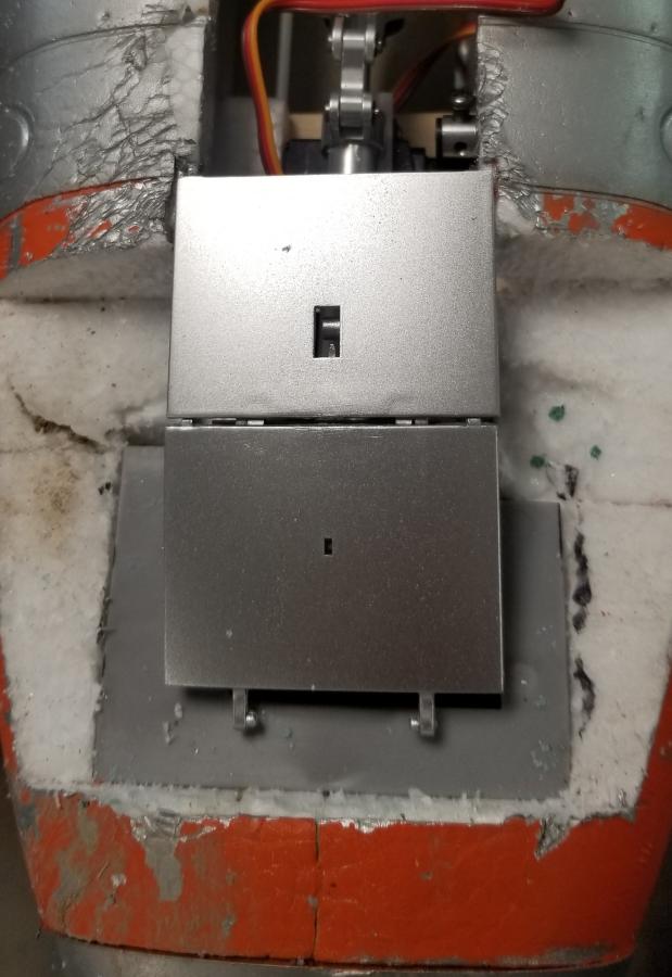

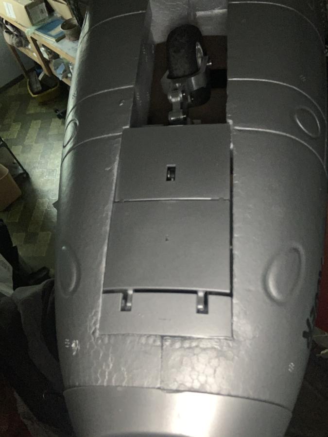

      I recently acquired the 80mm version where the nose gear and area was torn out.
      I purchased the plastic parts kit as well as the retract and strut units.

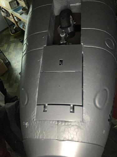

      I'm trying to see what the forward part of the gear door attaches to. The diagram in the instructions shows the pins fit into a plastic bracket which I don't have. Was this part of the fuselage or maybe a different version nose gear mount? Could someone post a picture of their gear door. Thanks

        You're missing a piece.

          That nose gear mount looks to be 3d printed, that's why it's different
            #886
            And looks like a large chunk of foam is cut away as well

              Ok, that's what I needed. I am missing a piece. Surprised it was not included in the plastic parts bag. I will see what I can do for a workaround to attach the doors.
              yes, I trimmed the damaged foam away to replace it all.

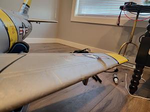

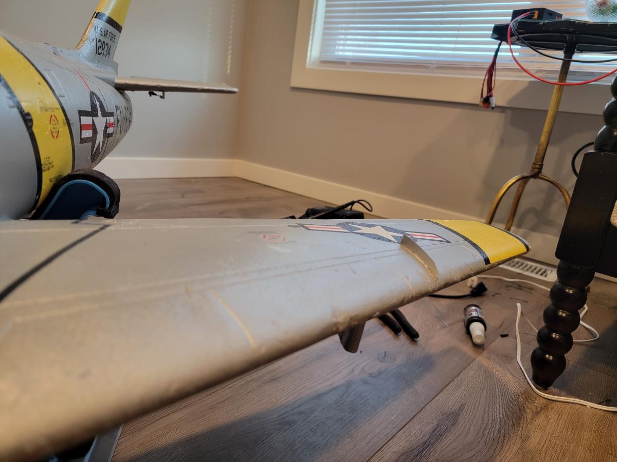

                                      i added some wing fences today to aid in a slower stall speed. The ol onterwebs show the older versions f86 use to have them so i figured why not. made them from an old credit card placed as close to a factory setting i could find on google, sanded it to my liking and a little silver paint. looks like they were suppose to be there. ill test it in the morning to see if it makes any difference.
                                      Click image for larger version  Name:	20220303_164934.jpg Views:	0 Size:	146.8 KB ID:	338890Click image for larger version  Name:	20220303_164926.jpg Views:	0 Size:	102.8 KB ID:	338891 RIFLEMAN, thats actually a good idea, if i tear the gear out, i think ill go that route. i have plenty of ultra light carbon material in my shop that i use to repair a few fiberglass planes.
