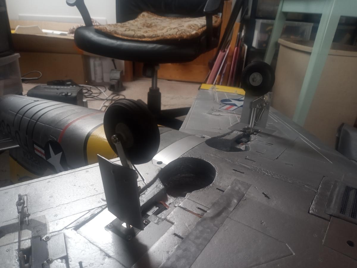

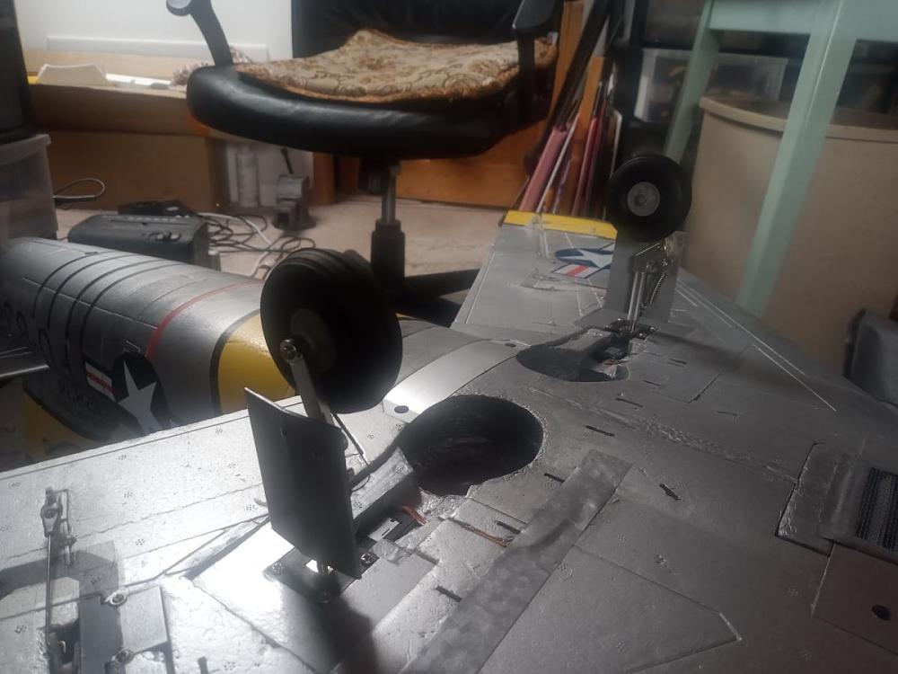

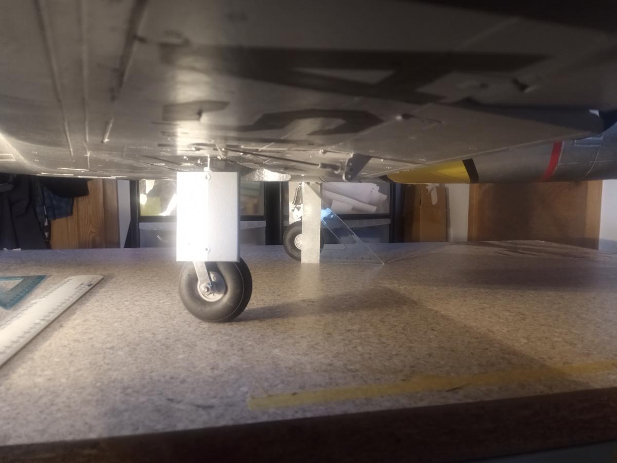

                              Also for those who are interested I have just added Freewing F5E trailing link oleos,55mm dia wheels to mine using 25mm long pins. You will have soft suspension with the standard spring and the plane weighing 2.8kg all up incl 715gm battery. Photos below. I would not go any heavier with this set up
                              Click image for larger version  Name:	F86 trailing links 1.jpg Views:	0 Size:	89.6 KB ID:	347233
                              Click image for larger version  Name:	F86 trailing links 2.jpg Views:	0 Size:	92.7 KB ID:	347234

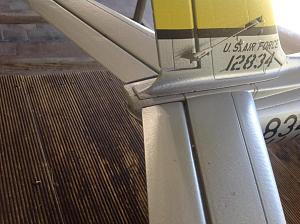

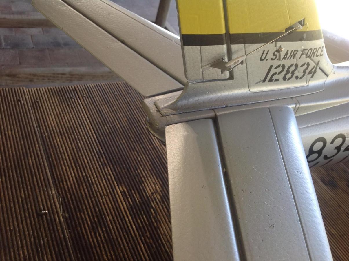

                                      Welcome to the F-86. Unfortunatly this plane has some things you need to learn (either through your own flying it or by the experience of others).
                                      As noted ALL ESCs need to be calibrated. They should be calibrated when you first set up any aircraft and recalibrated if you change set up, receiver, TX set up etc.
                                      The book balance is not right for the F-86. We do a balance test called a tail sit test to get the right CG. To do it put the battery in the plane and put the canopy on. Lift the nose until the tail touches and let go. Adjust the battery until it will stay touching the tail to the ground if you let go. Once set touch the nose lightly and the nose should drop and touch the table. This is a stock plane with stock landing gear. Swapping out the main struts for trailing links changes this.
                                      To get a proper balance many of us have had to reposition the ESC to be able to move the battery further aft. Be careful using large batteries as there is limited vertical height under the canopy.
                                      The neutral positions of the elevators is critical too. Most align them along the line of the horizontal stab and then find they need a lot of up trim. The proper alignment is to have the top edge of the elevators evet with the top edge of the fuselage. I found this picture to show you.
                                      While we are at it also do a good range check on your airplanes and please set a throttle kill switch for safety.
                                      Click image for larger version  Name:	001.jpg Views:	9 Size:	131.2 KB ID:	347236
                                      Good points on the F86 Evan. I used the sit test to set my F86 on the stock setup and also had the elevator set as your photo. The Freewing F5 Tiger trailing links have the axle vertical in line with the legs ( see photo below )and do not affect the sit test on a hard table as I tried it with my battery set as in my standard setup. Near as I can measure using my fingers, upside down with gear up this gives me the 195mm measurement so I included it in my post for clarification.( fingers may vary ) The trailing links I have installed do not deflect under static load with the plane all up weight at 2.8kg on the hard level table but they are more forgiving than the straight oleos. Not all trailing links are the same however so those with a more rearward axle would as you say not be good for the sit test .
