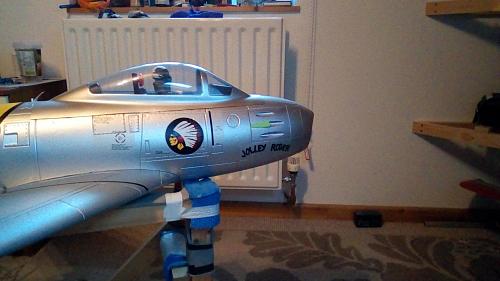

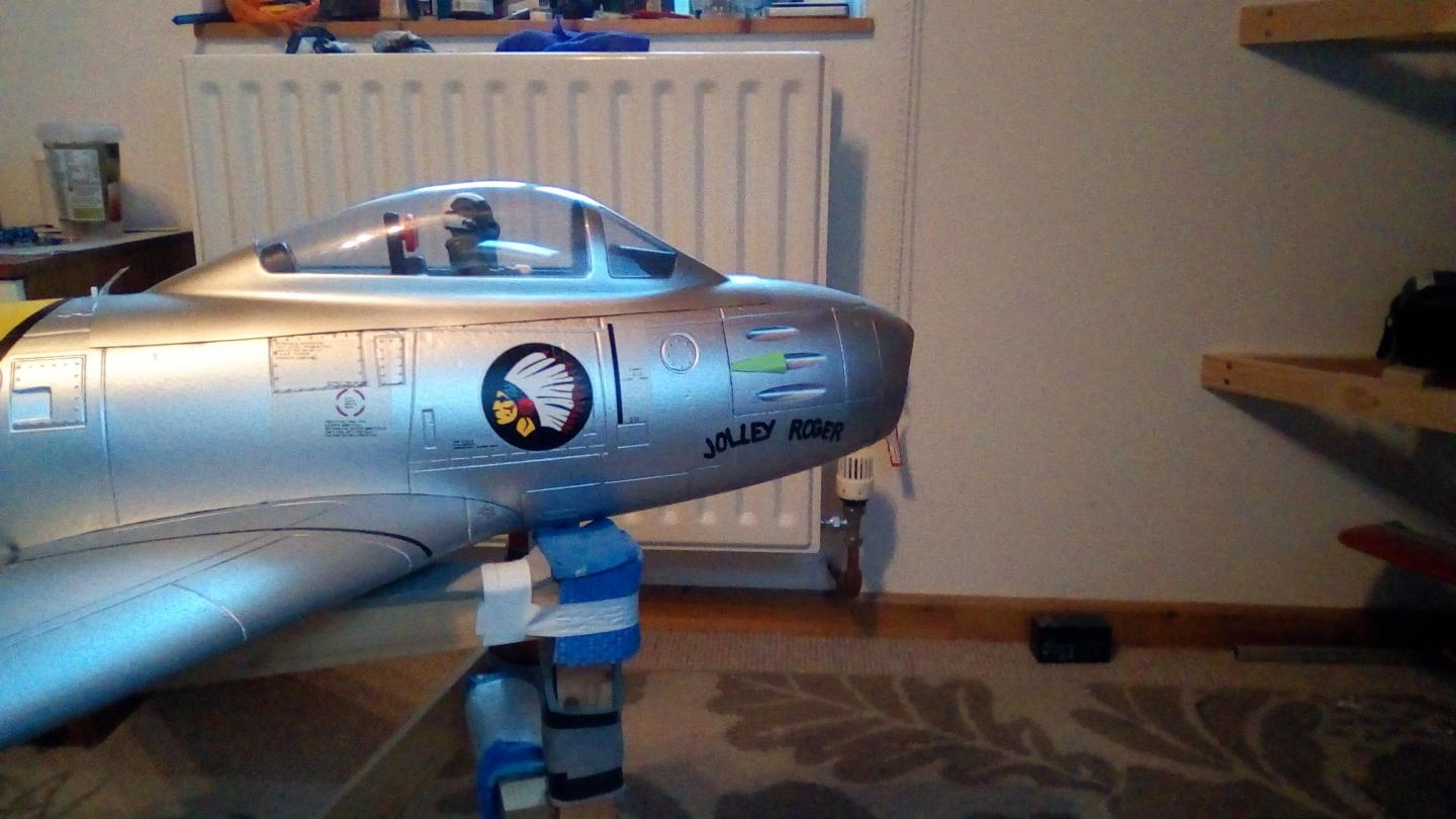

    Originally posted by coyote137
    While waiting for mig29 and saab gripen to arrive here in Scotland. I decided to repaint my 80mm F86
    Started with Tamiya primer over existing decals.
    Airbrush pattern with Tamiya paints
    Design and make my own graphics
    Weather and dirty with oil pastels
    then x2 coats clear matt acrylic varnish
    all done in x2 days ​
    C1, and where exactly is your workshop there in Scotland? I believe I'll be wantin' to send a Corsair your way for a quick turnaround repaint. Beautiful work, Sir. Best, LB

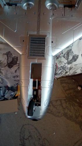

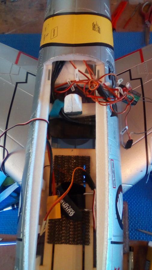

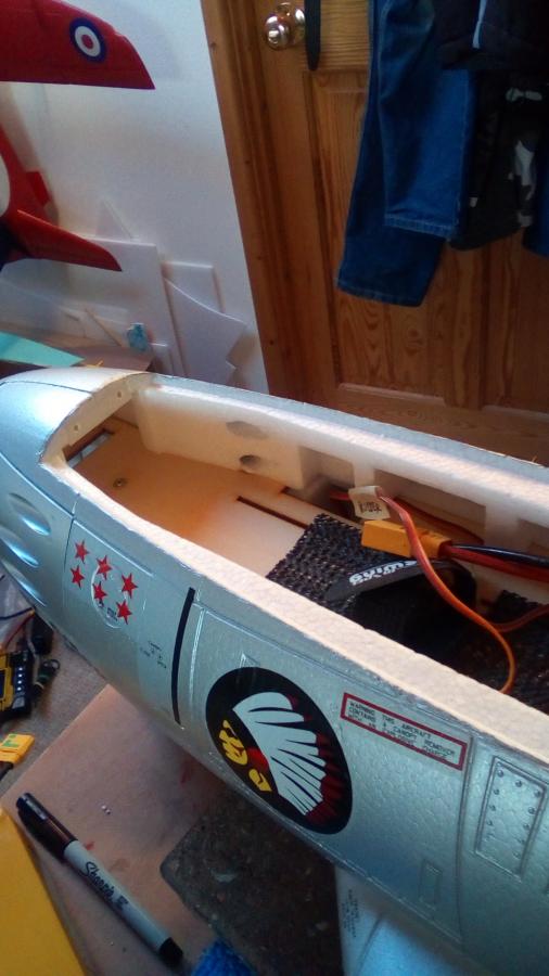

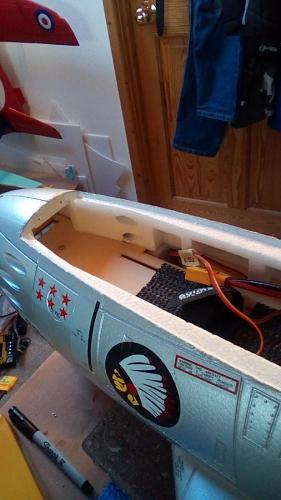

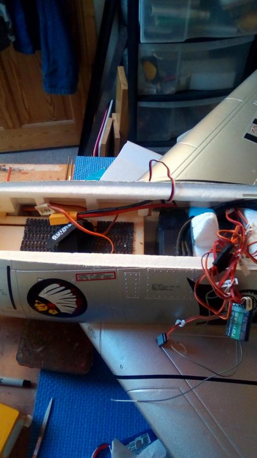

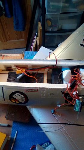

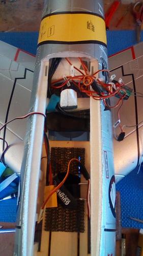

                        Battery and esc position mod.
                        in order to move the main battery back about 25mm I unscrewed the esc( black rectangle on photo) and pushed it back onto the plywood deck, still maintaining airflow from below and also adding airflow from above on both sides of the battery as I pushed it back until it just touched the esc.. I used a couple of cf rods to hold it down as per photos. This position also ensures a smoother airflow through the main inlet duct without interruption from the esc invading the duct. At the same time I created some holes in the top 2 front gun ports on both sides to allow more airflow into the battery compartment withut disturbing the main inlet airflow and this should be drawn through by the edf fan via both sides of the battery and the 2 holes now created by moving back the esc. I fly off grass so at the same time added 2 fod guards as shown, one to the cheeter hole one to the noseleg hole. The additional airflow created via the gun ports should also help compensate for the small amount lost by the fod guards. Moving the battery back has helped achieve the sit test cg position I was looking for without having to add tail weight. It works for me but be it on your own head​ Click image for larger version
ID:	286711Click image for larger version
ID:	286712Click image for larger version
ID:	286713Click image for larger version

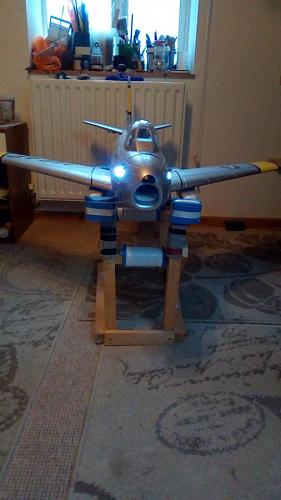

                              Video from 2014 to show sit test for CG

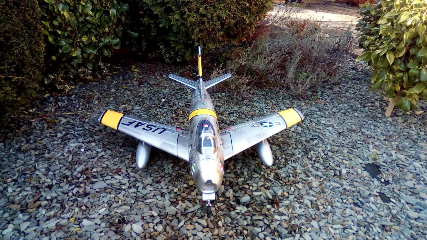

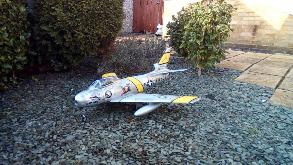

                                #755
                                I just love the new big motor version, but wish they would update the plane, Compared to my T-33 it's a little crude. However it is still my all time high favorite plane. Here is my new one done up as a CL-13 Mk6.
                                • paulrkytek
                                  • Jun 2019
                                  • 542
                                  • North of England
                                  #756
                                  Very nice PHF, its definitely been worth the time and effort

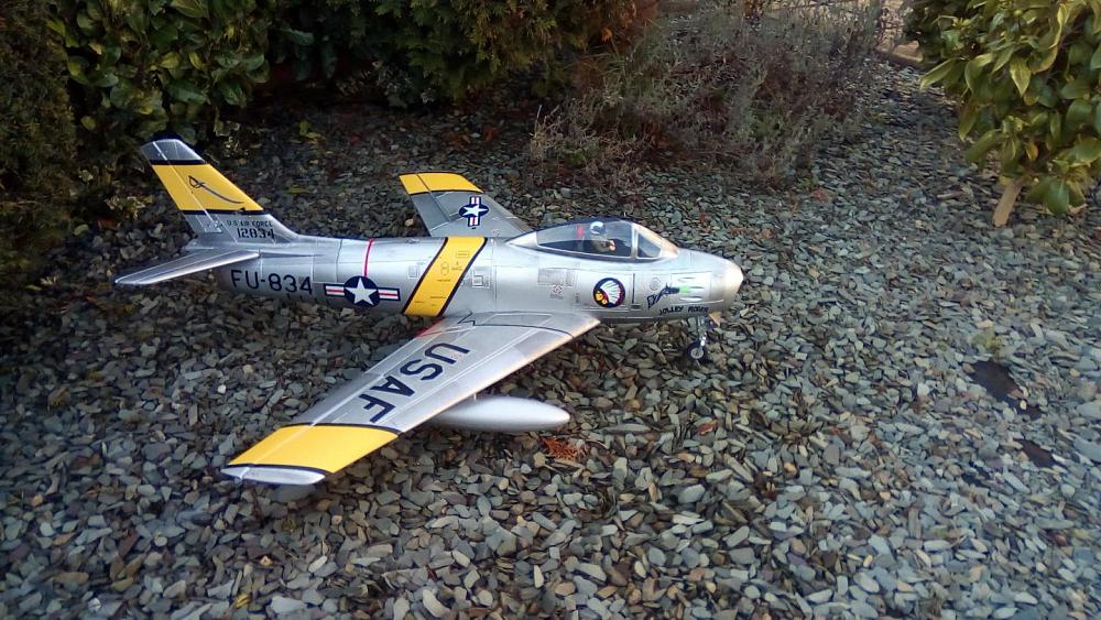

                                    #757

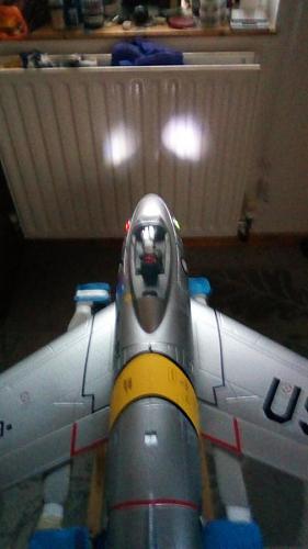

ID:	288817Click image for larger version

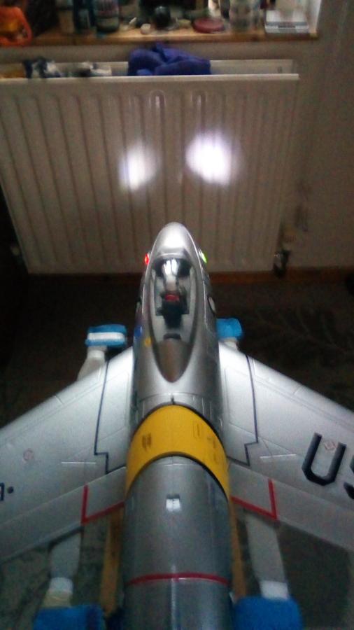

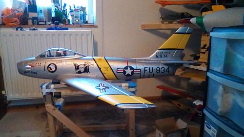

ID:	288815 lights fitted, just the weathering to sort out now, the photo gives white out to the red and green but to the naked eye it works well, hence the green with lights off Click image for larger version

                                      paulrkytek , Nice modification. Could double as a 'gun fire' mod as well Best, LB

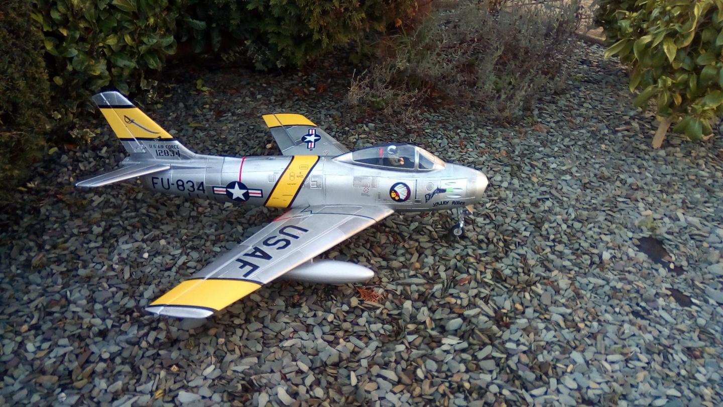

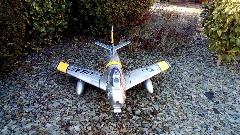

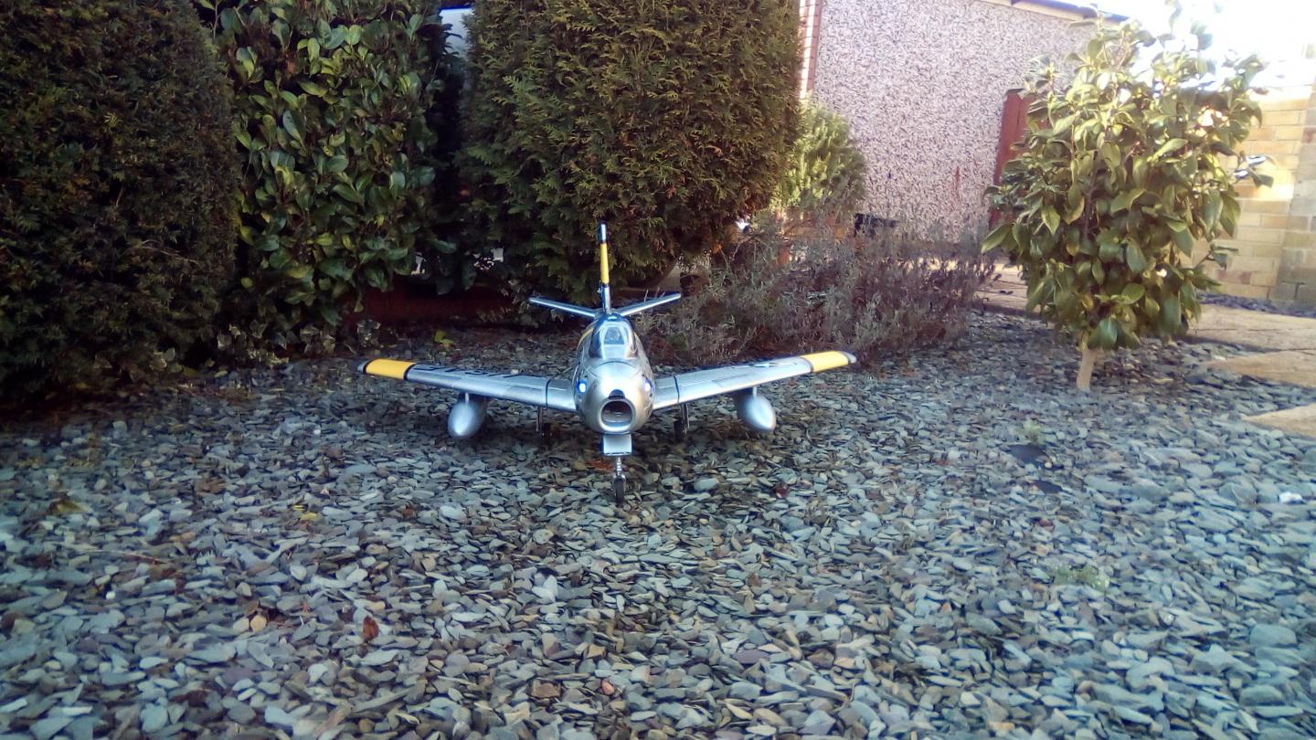

                                        Here is my F86 Sabre Ultra High Performance version converted from Mig Killer to Covid 19 Killer complete with not one but two top secret totally unproven magic blunderbusses of ultra sonic light and virus seeking death rays. Cannot wait to get those little covid kill stickers mounting up next to those little red stars!!!! If it doesn`t work I suppose they will have to do for landing and position lights. Oh yes and seasons greetings to one and all from Paul.

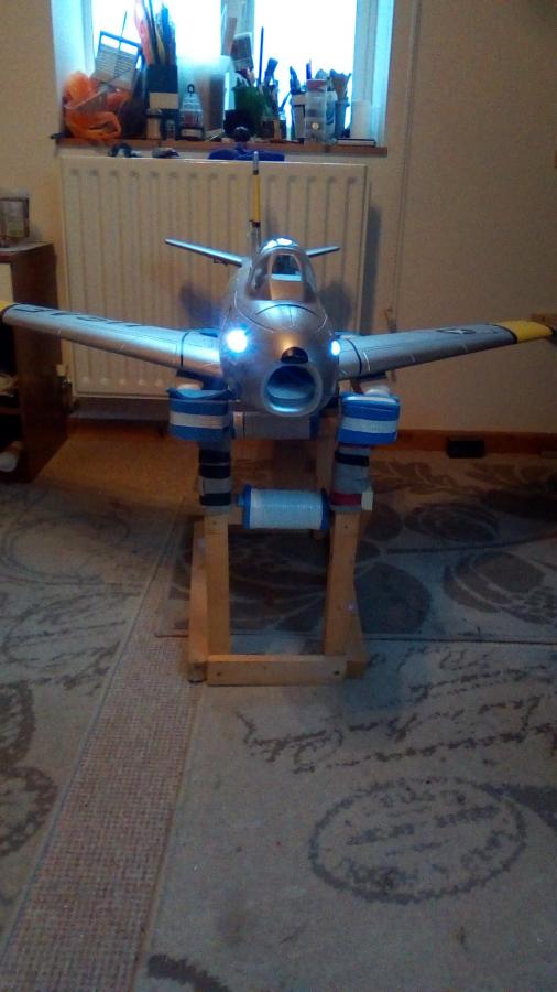

                                        • paulrkytek
                                          • Jun 2019
                                          • 542
                                          • North of England

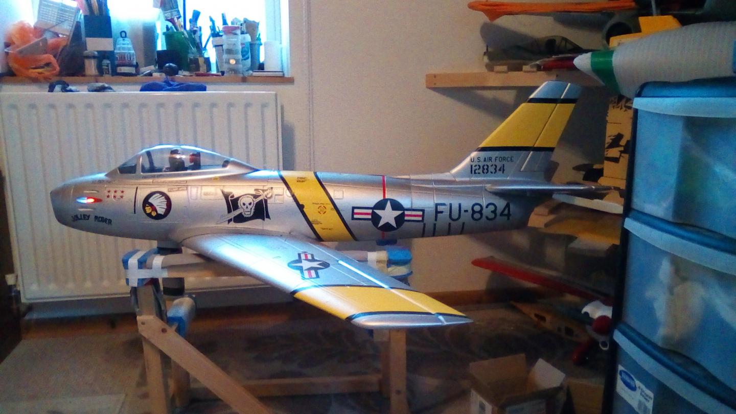

                                          #760

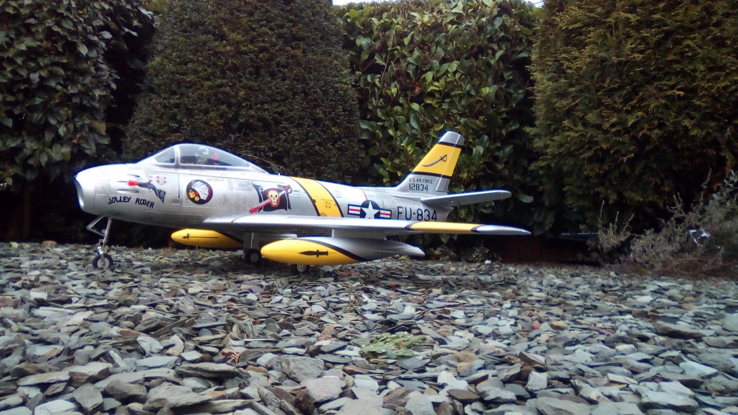

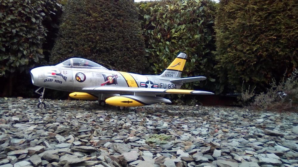

                                          Decided to paint the drop tanks for better visibility in our grey sky
