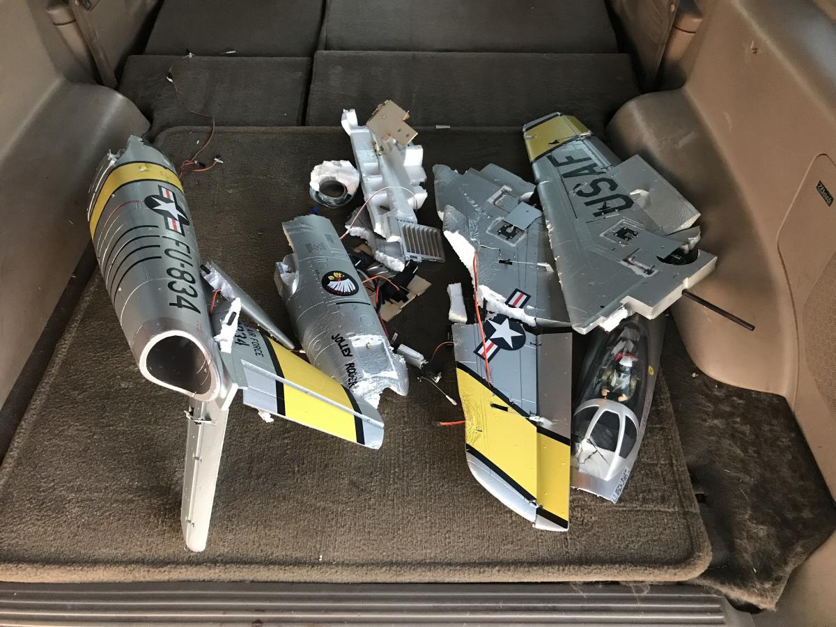

    I bet that can be fixed. Near boiling water and joint compound where needed. Sand n paint.

    I loved this edf but it need a lot of runway off grass with wind. I even upgraded from stock to a 1850kv motor and fan and went with larger wheels.
    Today she flew her last flight. Dead calm full flaps and it took forever to roll out. Anyways she took flight and then my depth perception went bonkers... dead into the trees! Oops!!
    She is an awesome flyer once airborne!
    I think I’ll hold off on buy another until the make a larger one with more power.

    Sorry about your loss. I also recently crashed my T-28. But after a closer look I realized the wings were salvageable using some good old Foam-Tac glue. Then I just bought a new fuselage.
    In your case you could just rebuild it by just getting a new fuselage if you can't salvage the right wing. But a new fuselage and wings will only cost you $118. I would say its worth rebuilding it.

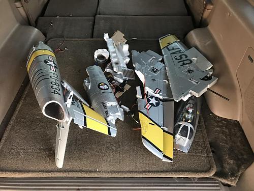

    Ohh no....sorry man.
