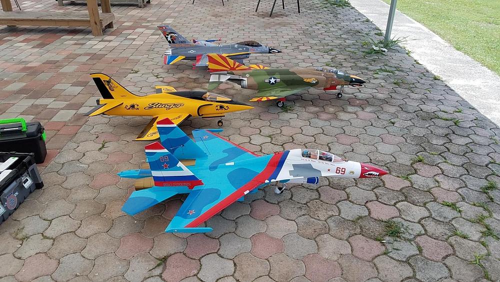

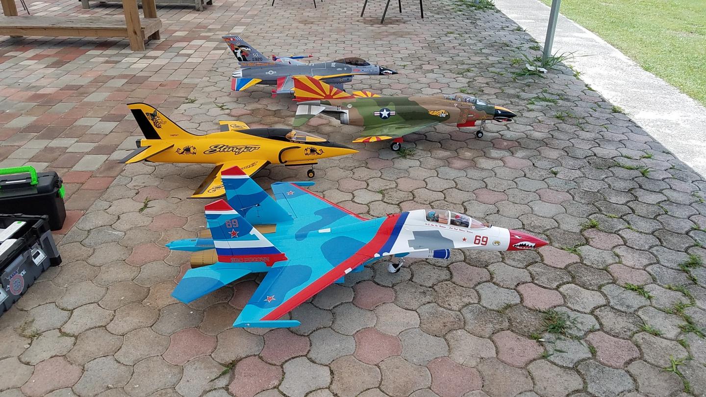

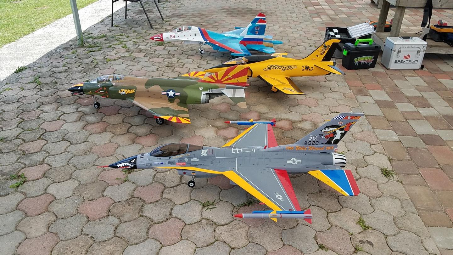

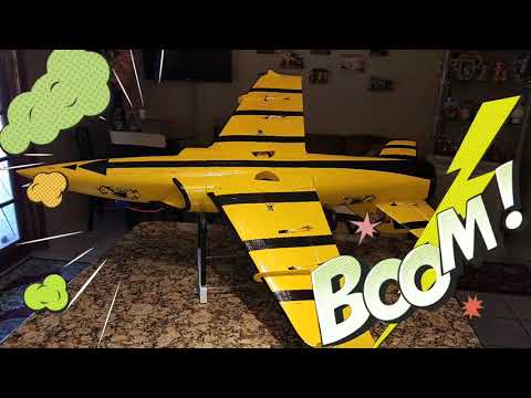

                    Got 20 flights in today on 4 EDF's, with 5 on the Stinger 90. I'm now flying it with the RT 6250 35C battery and am getting 5 minutes of aggressive flight time. :hugging: I think I'm finally getting to the point where I can fly it with a lot of high end maneuvers with 0 pucker factor. It only took about 60 flights to there though. :triumph: This was my 1st EDF and man, it's come a long way since that first flight. Haven't had to do any "repairs" for quite a while now. 2 point high alpha landings have finally become the norm. I think it flies better than the Avanti and just as easy, but it wasn't always so. Can't believe how bad I was when I first got it! And I love the sound of the 12 blade EDF (and the 12 blade inrunner in my F-16). One of the turbine guys at the field said they both sounded almost like a turbine. On the other hand, the 9 blade stock outrunner in the F-4 sounds like :poop: in comparison, way to whiny. But damn, the F-4 does fly nice, so I just put my headphones on and listen to a little Country while I'm flying the F-4!:cowboy:

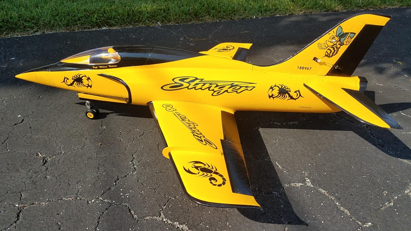

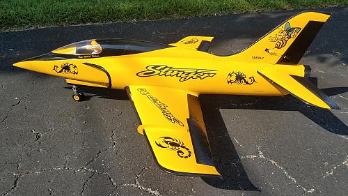

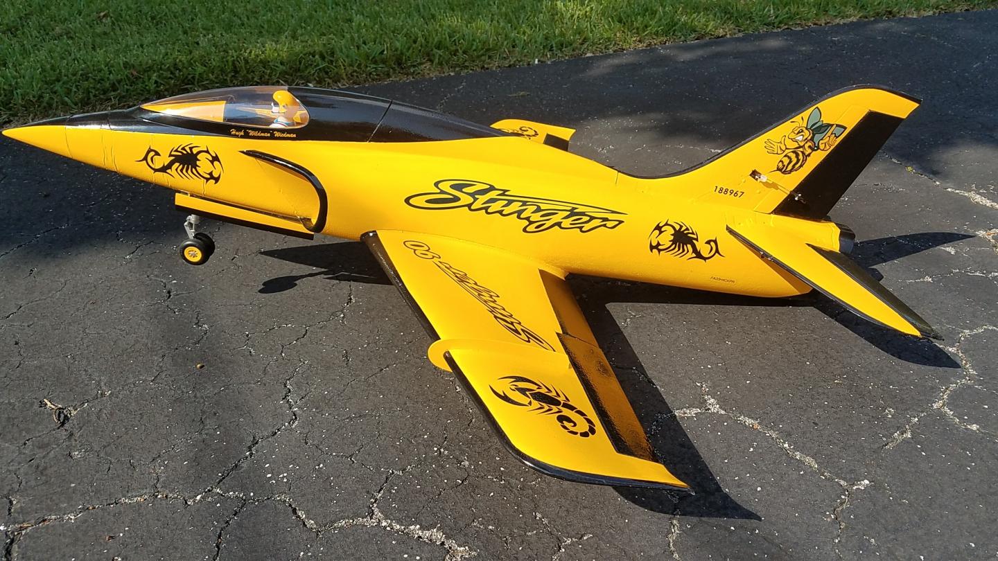

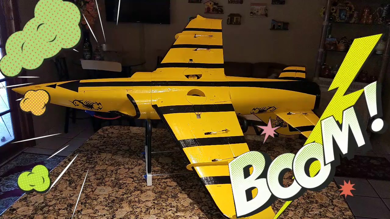

                          Did you remove the red pain from the stinger or paint over it with the yellow and black?.
                            • 2716
                            #93

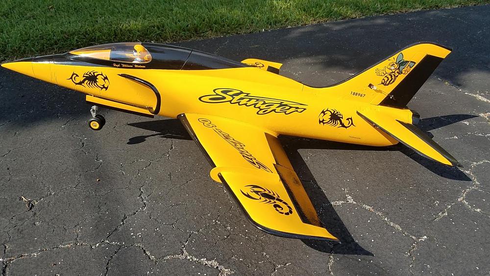

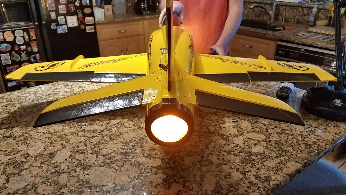

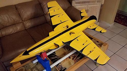

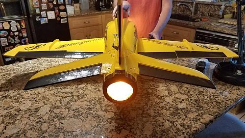

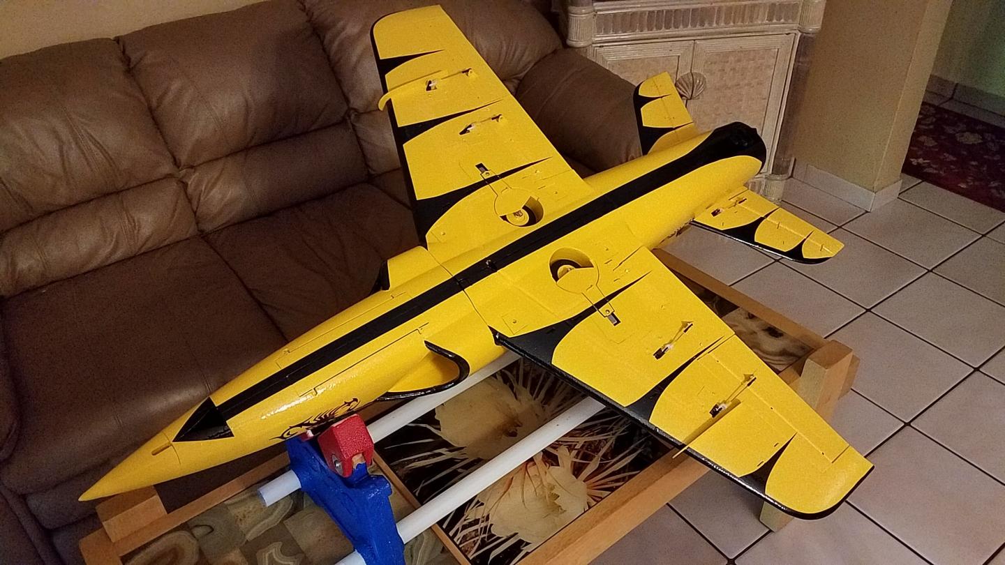

                            I assume you are directing that question to me. First I removed the decals that would come off easily with tape which were the decals on the underside (decals on the red painted surface did not come off easily so painted over those). Then I put 2 coats of Varathane Spar Urethane water based clear gloss as a "primer". Then spray painted both sides with Rustoleum 2 in 1 white primer, followed by Rustoleum 2 in 1 gloss Golden Sunset. Final paint was with testors black enamel, hand painted. I sent Callie Graphics the designs I wanted for the Stinger logos, Hornet on the tail, 2 different scorpions, etc. and she printed them better than the designs I sent her. Final touch was 3 coats of the Exterior clear Gloss urethane.
                            Actually did 2 of them (only difference was the underside and top of the elevators), both with afterburners. Definitely one of Motion's best flying sport EDF's along with the Avanti, 5 minutes on a RT 6250. This is a great frame to customize to your liking and IMO really needs it!
