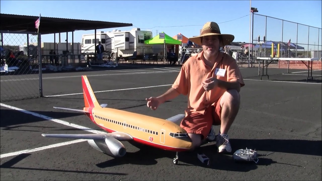

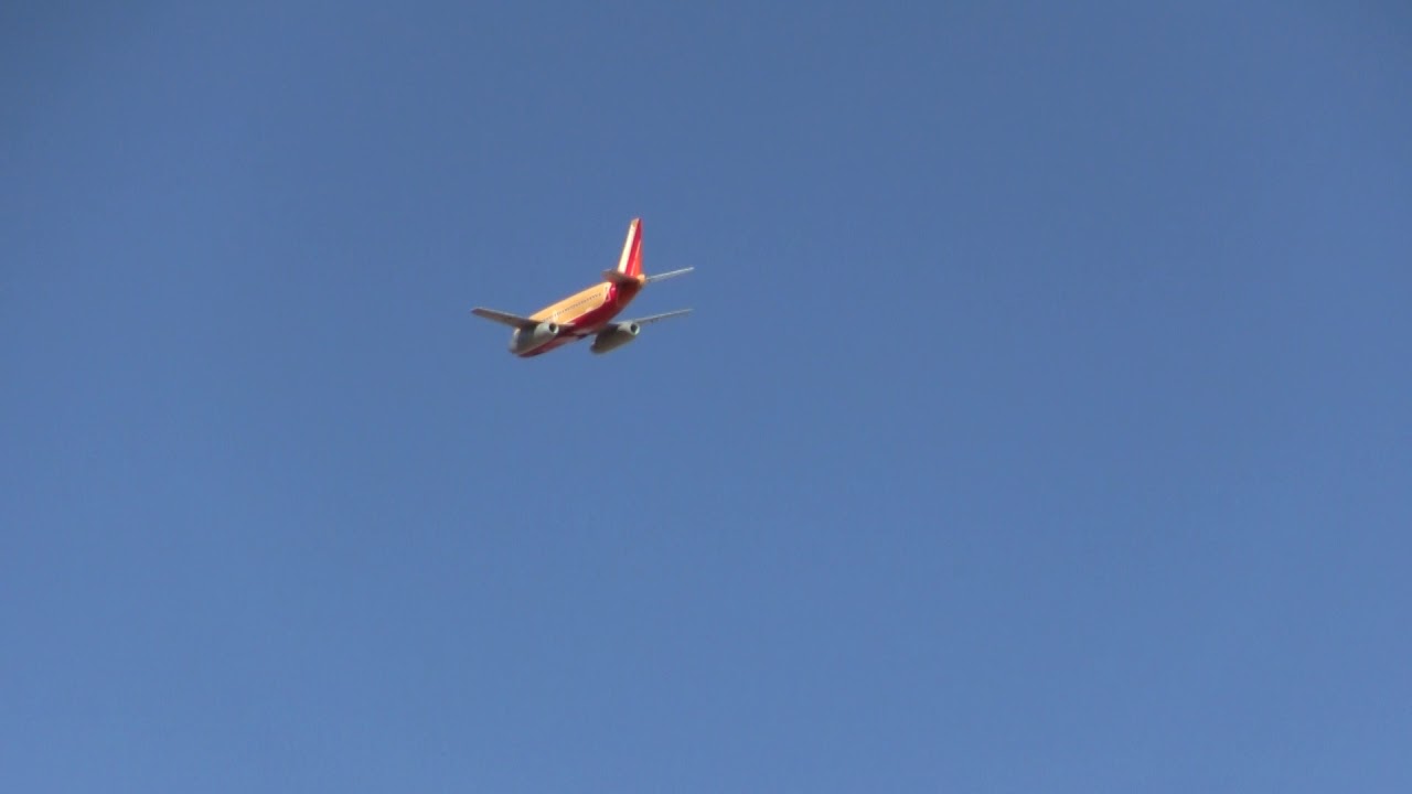

    Here's another video of Barrett Hochhaus' beautiful scratch-built airliner utilizing the wings/motors/landing gear from the Freewing Me-262 that I shot at AEF last weekend.
    This one's a bit different than Pat's as it was shot during the Southwest Airlines "Heritage Flight"....
    I personally prefer the older tan color over the newer blue scheme...it's what I grew up with!
    Watch as Barrett absolutely GREASES the landing, and then stay tuned for an impromptu interview with Barrett about where he got the inspiration to build it, and HOW he built it!
    I especially like the fact he calls it a "Boeing 737-262"!
    Blue Skies!

    That really is cool and very inventive it sounded like one of the people talking in the video was an airline pilot I’m sure he was interested in one.
    Somebody liked it so much he commissioned my friend to build 3 of them for him and his buddies!
