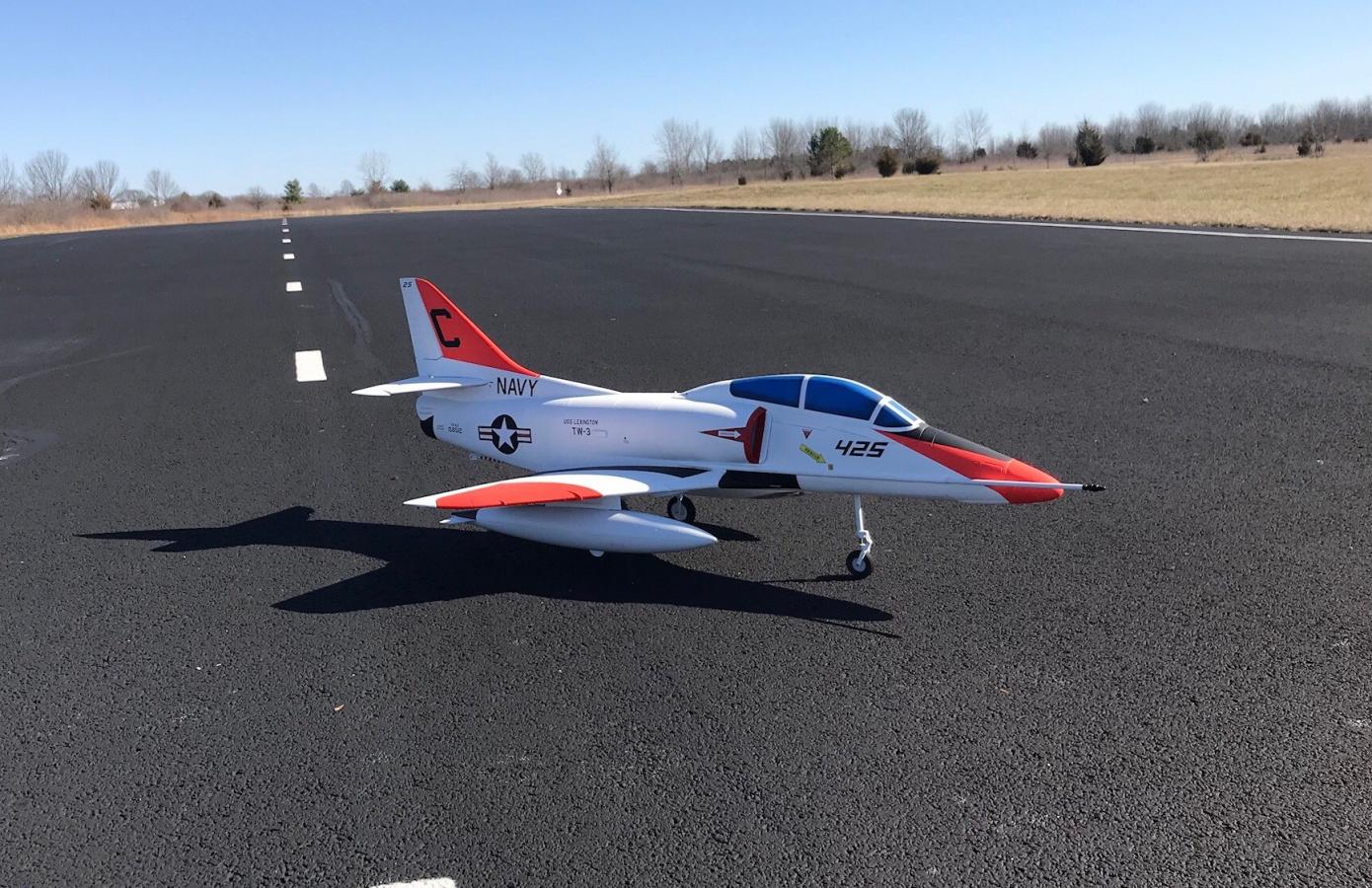

        Great weather here in Ohio today. Finally got the maiden in on my TA-4J! Amazing how well these FW jets fly. Balanced per the instructions, required a couple clicks of down trim, nothing more. Its going to be a fun flying season.
        Hey Seaviper! We need to put these two training command jets in the same place sometime!

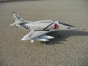

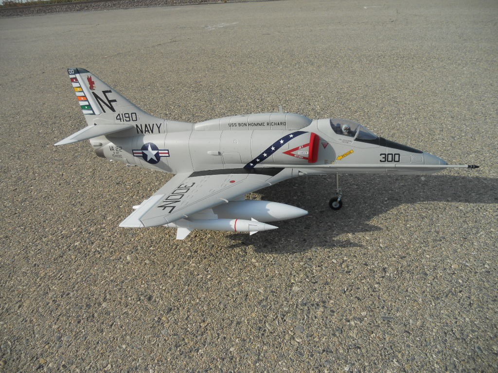

                                      I find mine moving around a lot in the wind as well, it likes calm air better that's for sure. I also added nose weight and even moved my power board forward to get the battery forward more, I am forward on the CG and use ony low rates to fly this bird, even less on the ailerons and not much elevator needed to land, now it fies like a dream....
