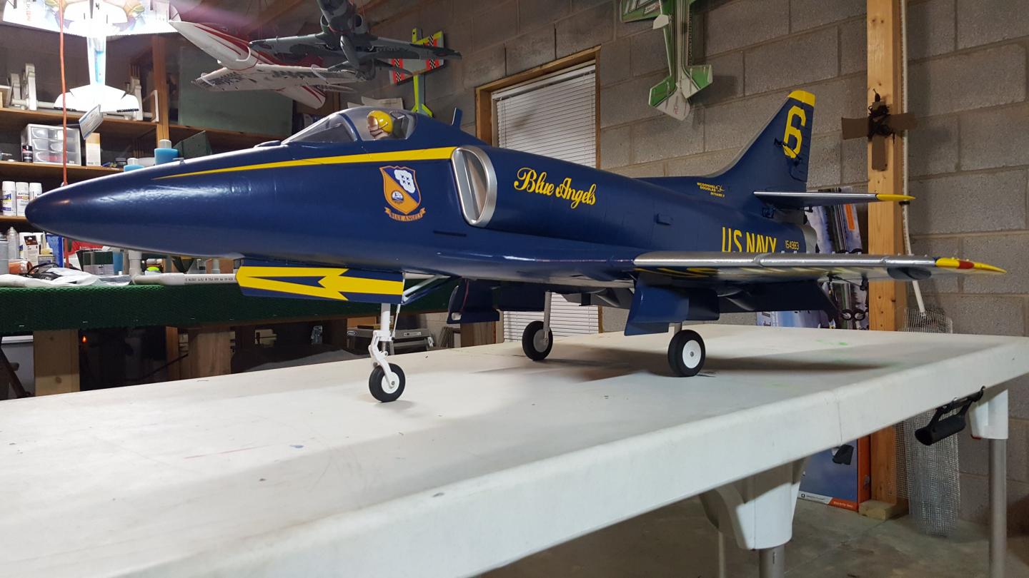

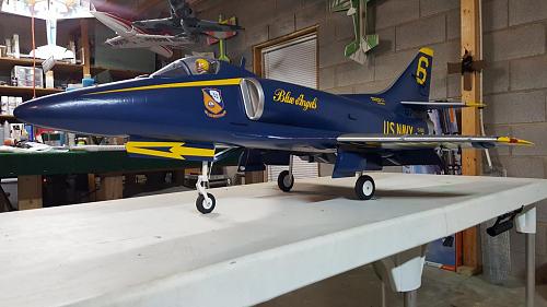

              Welcome to the Squawk. The plastic covers are easy to remove. Complexity and cost are largely why they don't add those details to some planes. Besides, it causes us to find our inner modder...
                Click image for larger version Name:	20171127_184946.jpg Views:	1 Size:	132.0 KB ID:	106711
                Thanks.........beautiful job on the Skyhawk. Can you post some detailed pics of your gear doors (main and nose)?

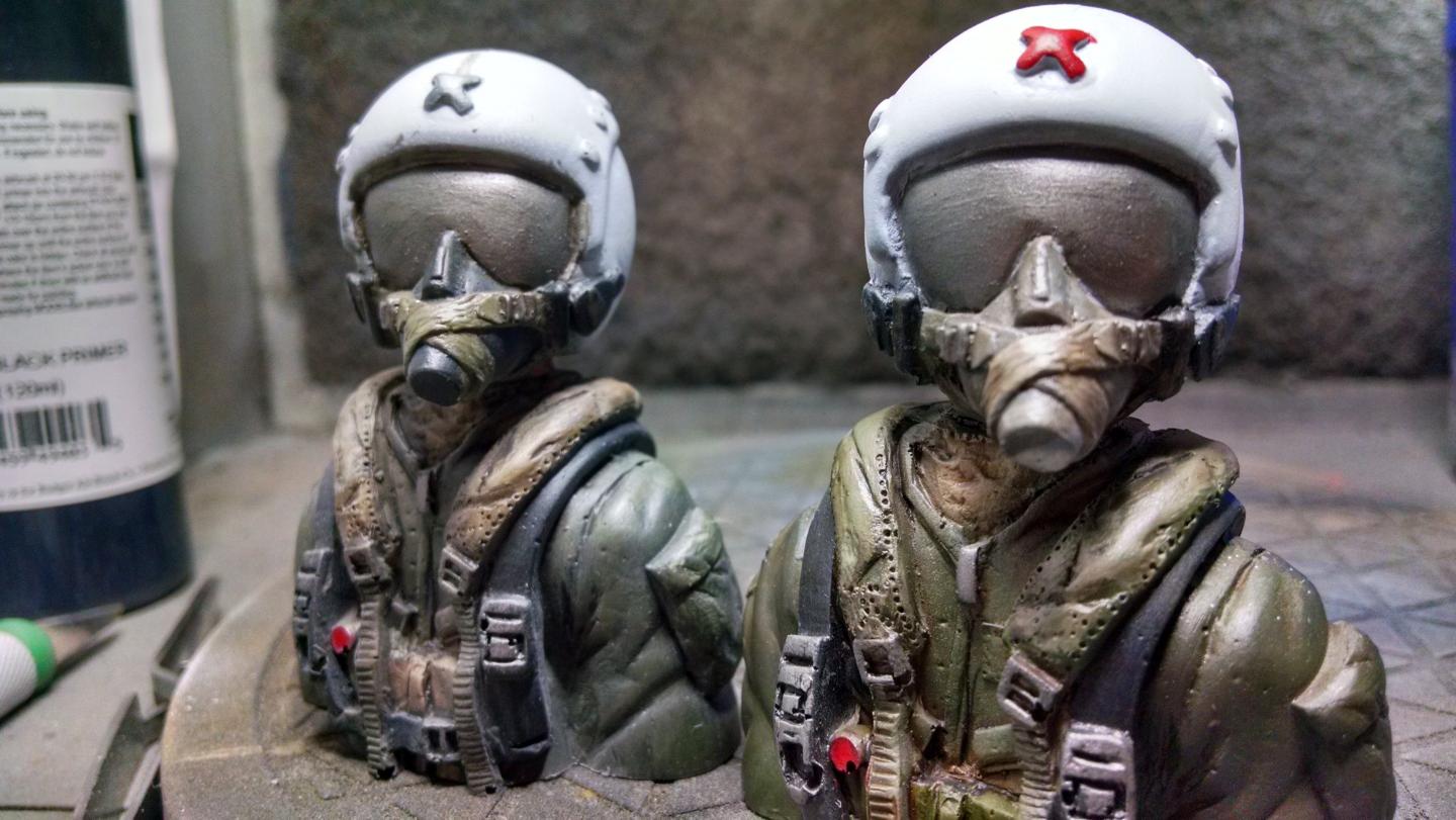

                                        Well Done on the pilots!
