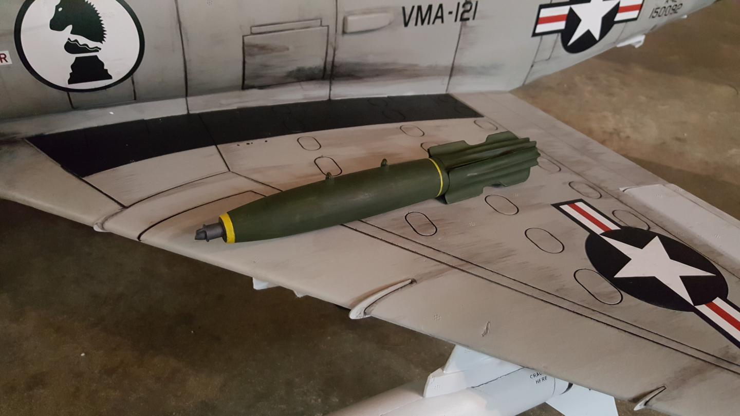

                • Steve.........:Cool: Those look like Mk 82's and where'd ya get the Mk 15 Snakeye variant. I WANT SOME ;)

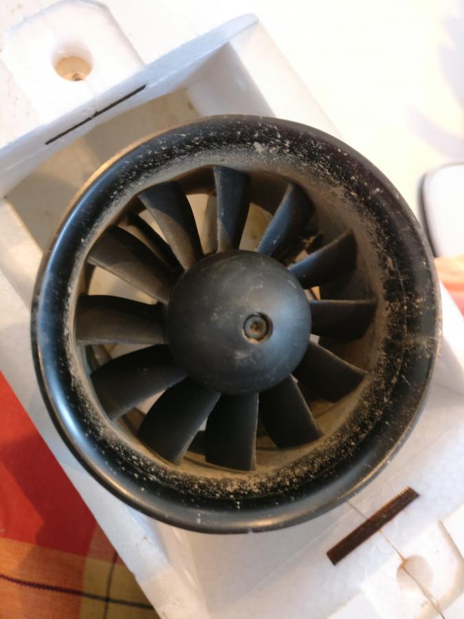

ID:	100736After seeing sea viper's post i thought i should check my fan too since i fly from very muddy grass. I was shocked to see that the entire fan casing was covered with around 1mm of mud! it was tricky to remove it but in the end i used a toothbrush and water to clean it out. I think i might have to cover the cheater holes now since I've only got 4 flights on it so far and it picked up a worrying amount of mud.

                          • These thing are glorified outdoor vacuum cleaners. It doesn't take much.
                            • Holly smokes Slimbobtheflimbob that looks like my sump pump! Cheater....BE GONE!
                              • With the center drop tank mod it seems to deflect the trash thrown up from the nose wheel.

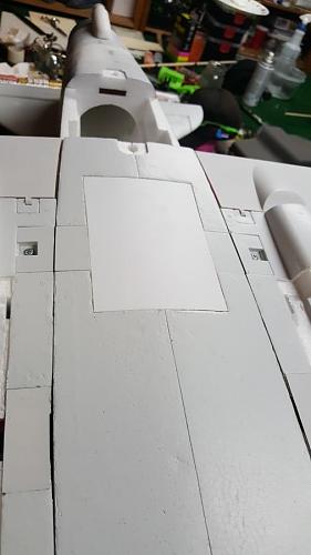

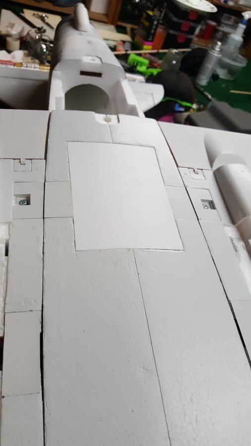

                                  • I personally did not notice any difference. An FSA calculation was done by someone on RCG that determined the intakes by themselves were slightly larger than the fan and others in the know have indicated no real noticeable difference as well. One individual felt there was about a 10% loss in performance by covering it but the majority by far seem to feel otherwise. I just made a plate from sheet styrene and replaced the cheater with it. I did glue some small strips of styrene to the front and back ledges to help bow the plate more in the middle to match the natural curve of the bottom. I did not make a foam block to fill the cheater intake although some have.
