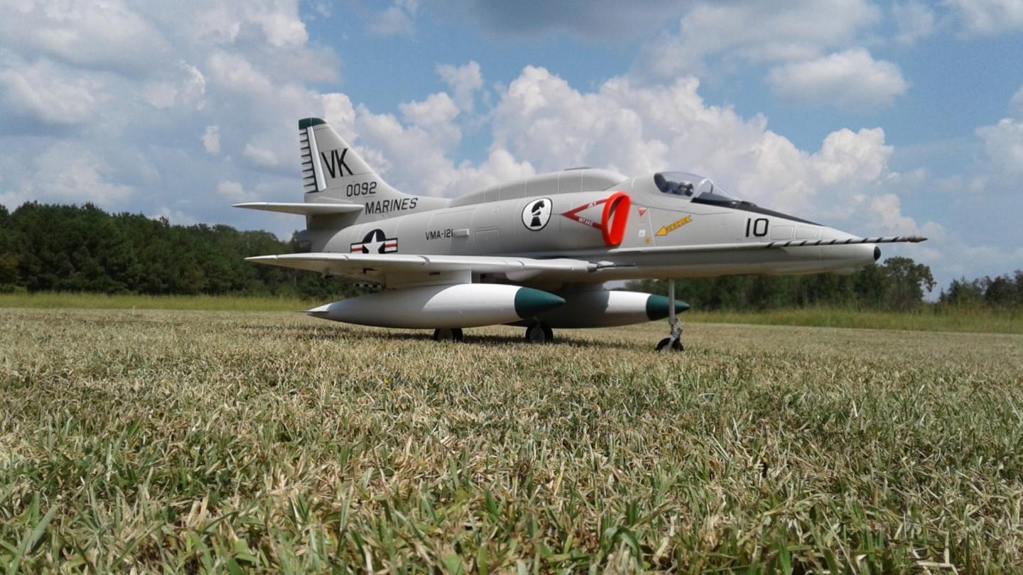

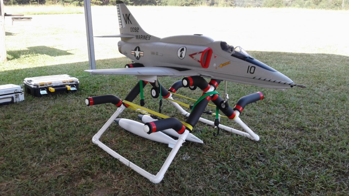

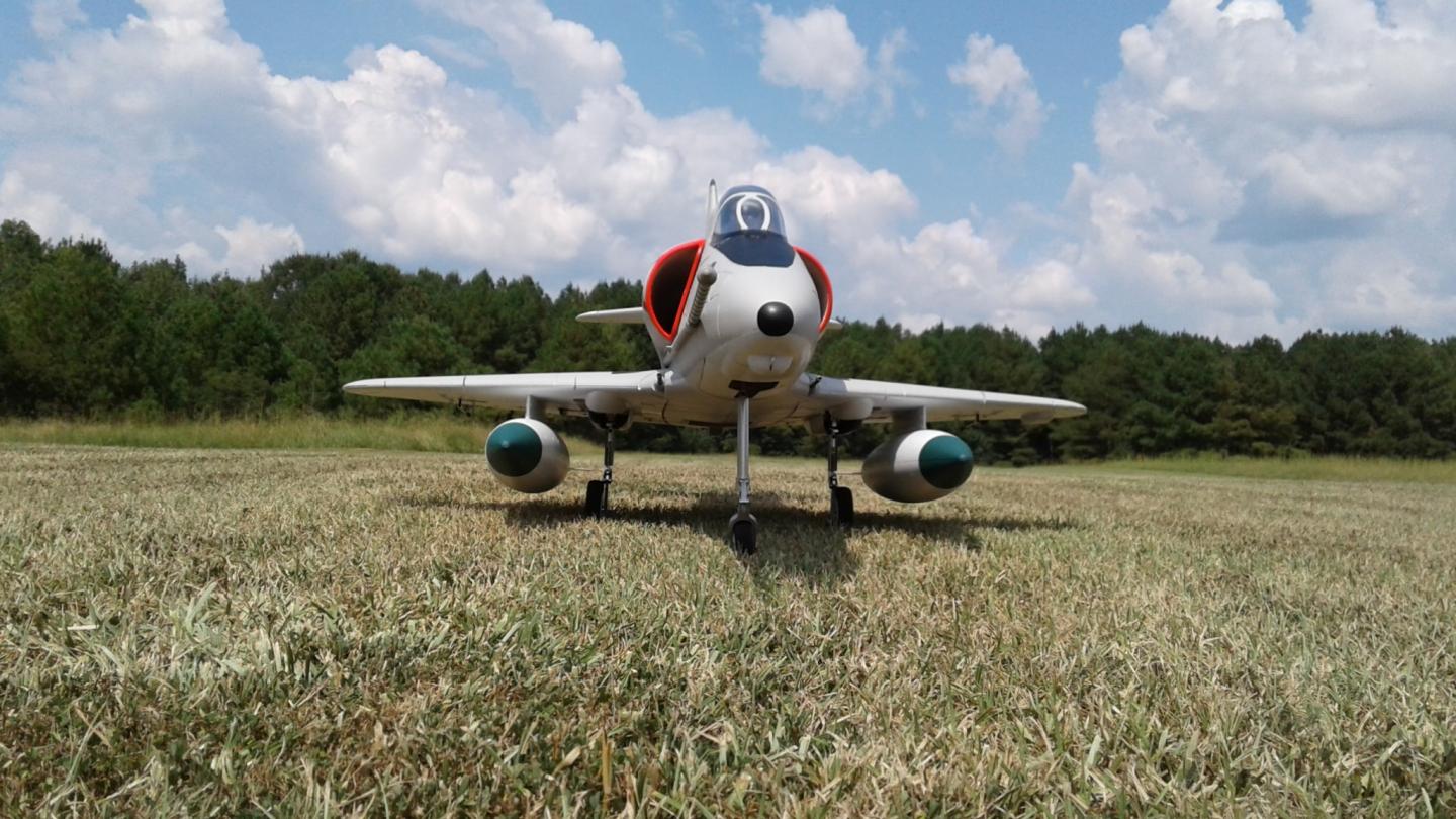

          Flew mine five more times today. And I have the following observations...
          It looks great with tanks but they make it a little laggy and a little pitchy on landing. Don't like flying with them.
          The hump doesn't seem to bother the A-4 in flight. I did fly my mobius on the hump. Don't like it. Slows the bird down a little.
          My nose gear is getting more and more loose. Looks like the pin is wallowing out the trunnion. You would think someone could make a nose gear that could handle grass by now.
          I don't like having to remove glued stuff to do routine maintenance. Period. Case in point, the nose gear.
          And I don't like glued in servos. I know why they are that way. I disagree and think they should have put them in plastic pockets with screw on covers.
          Take offs are smoother without flaps in my experience.
          Overall the A-4 is a dream to fly. It's fast and gets out of the grass in about 100ft or so. I love it.
          Got a grand total of about 39 minutes of flight time on the bird. Hope to get more tomorrow.

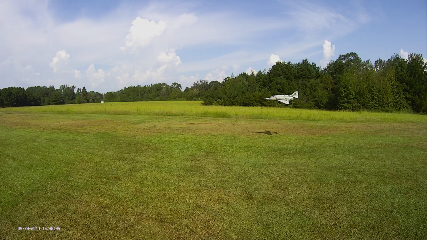

                                e4dragongunner...she flies good doesn't she? Congrats!
                                This was mine yesterday!
                                Click image for larger version  Name:	vlcsnap-2017-09-23-18h45m09s071.png Views:	2 Size:	1.60 MB ID:	98141
                                Cmdr Heatherly below the hard deck...

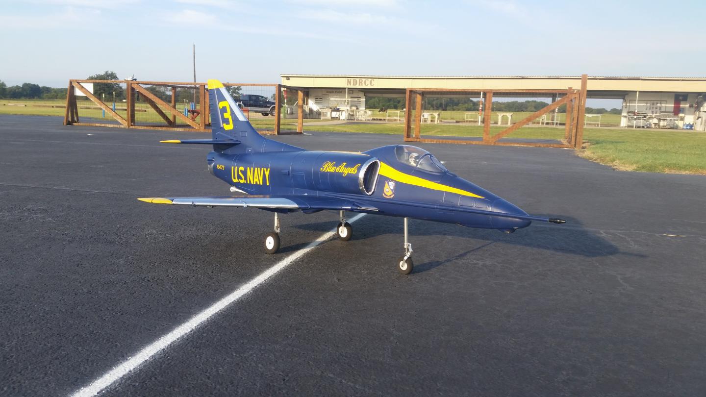

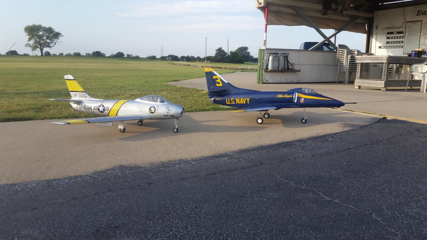

                                          Put a couple more flights on the Skyhawk this morning. I took the Sabre out with me as well.
                                          I mixed a little up elevator, about 2mm, with full flaps. It helped out quite a bit.
                                          I flew the Skyhawk without the refuel probe last weekend (maiden + 2). I had visions of a lawn dart so I played it safe. Flew it with the re-fuel probe this morning, no augers!!!
                                          I am using Turnigy 5000mah/40C batteries pushed all the way forward, CG is about 190mm rearward from the seam where the wing mates with the 20mm cannon fairing at the wing root (reference point in manual). Aileron throw about +/- 8mm, I upped the elevator throw from +/- 12mm to about +/- 15mm for the flights this morning. This bird flies great! Picture perfect rotation, very nice axial rolls, doesn't drop the nose too much in steep turns, and with a little up elevator mixed in with the flaps, she just floats right down on the runway without any real elevator input, very nice!
                                          Still very happy with this plane.
                                          Hoping for a 90mm F9F Panther from Motion/FW soon! A 105mm version would be even better!
