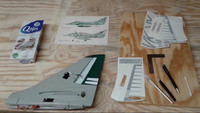

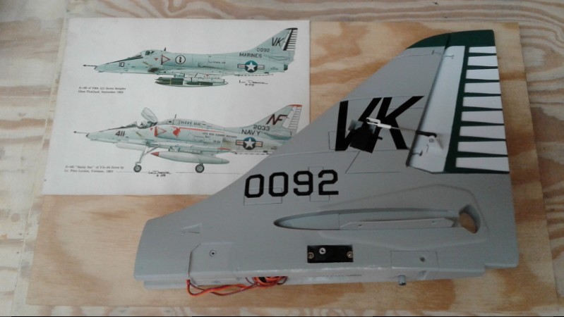

I painted the rudder then cut and applied the white part of the Callie Graphics vinyl. I had to make up a couple of custom pieces on each side of the rudder as the original graphic did not entirely fit. But this is the only way I could figure to do those white spaces.
