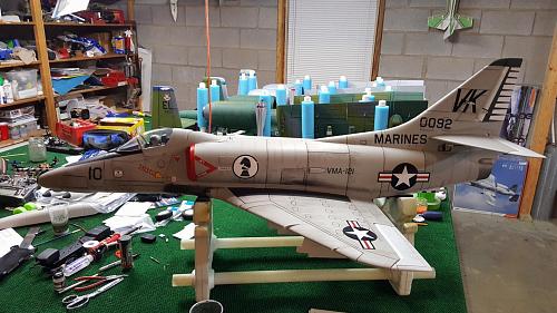

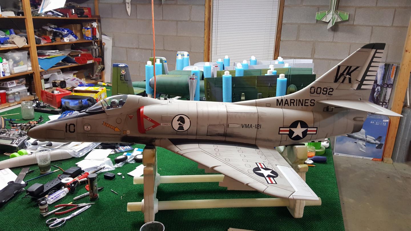

She looks really good Pat! How late did you stay up last night doing the weathering? :Yawn2:I couldn't stand it, so I went ahead and dirtied her up! All I did was take a charcoal pencil to draw in the lines, then used a thin hard-bristle brush to blend it and give the lines some shadow. Still have a little more to do, then will hit it with a coat of Testors Dullcote to seal it and knock down the shine of the decals.
I always use a setting solution for my water slide decals. Makes them snuggle right down to the surface details, provides extra adhesion, and prevents them from peeling. I used Microsol on these.Comment

Excellent , Thanks for the weathering insight! and decal info.

Not too late. Did one side last night, and the other this morning waiting to take my daughter to school.
I'll see what I can find for the bottom as far as panel lines, but may do the same and just "dirty it up" on the bottom.PatComment

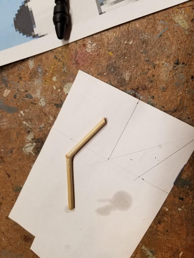

Thanks. I cut them at 22.5 degrees. Also, took some bamboo skewers, snapped them to 45 degree angles, reinforced them with super glue and put them in the joints for extra support.Comment
