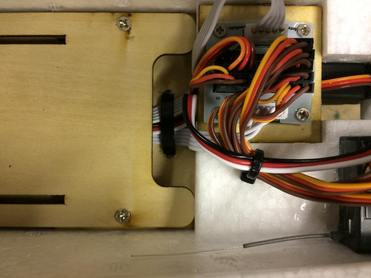

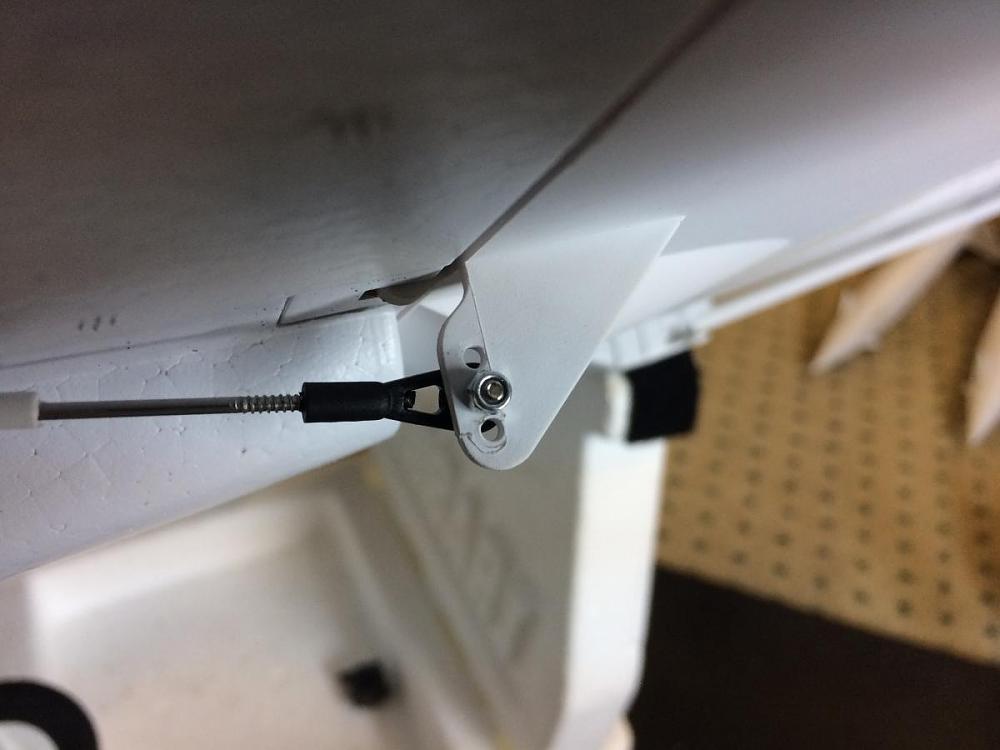

    Got mine put together, no shipping damage, everything fit perfect and the finish is really nice. I've started physically checking every solder connection and all were solid but the motor wasn't plugged into the ESC, all three wires completely loose.

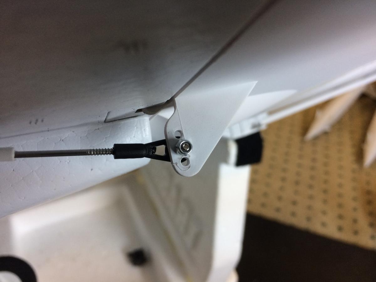

    I noticed that the flaps were about 4mm off at full position, I was able to make them match by moving the port side to the middle hole on the control horn.
    With that really long nose strut I decided to put a wire tie around the front end of the retract for a little extra strength, it also holds the wires in place.

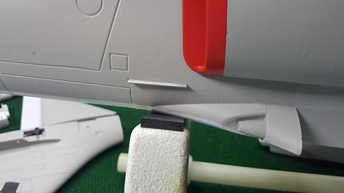

        I noticed on this model that the mold stars really stick out, maybe me, but it seems like there are a lot more on this plane...
        Maybe being a little anal as you can't see them 5 ft away... But on the bench they stick out like a sore thumb...
        Maybe have to buy another and sand and paint for a Blue Angels show plane, and just fly the crap outta this one...
          I think it's because the rest of the finish is so smooth.
              Maybe I should just take off my glasses...lol...

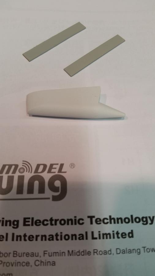

                I had these 3 extra parts left over after assembly - what are they for?

                  The bottom big part is the parachute that goes at the rear bottom of fuse...
                  Not sure about the other 2, haven't got that far yet...

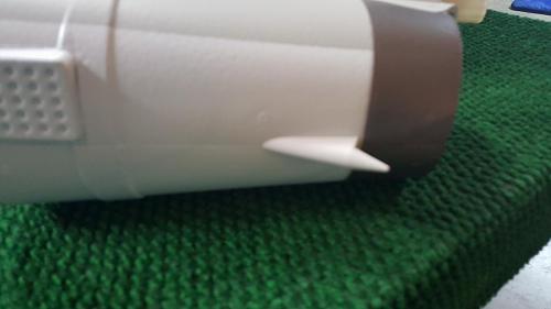

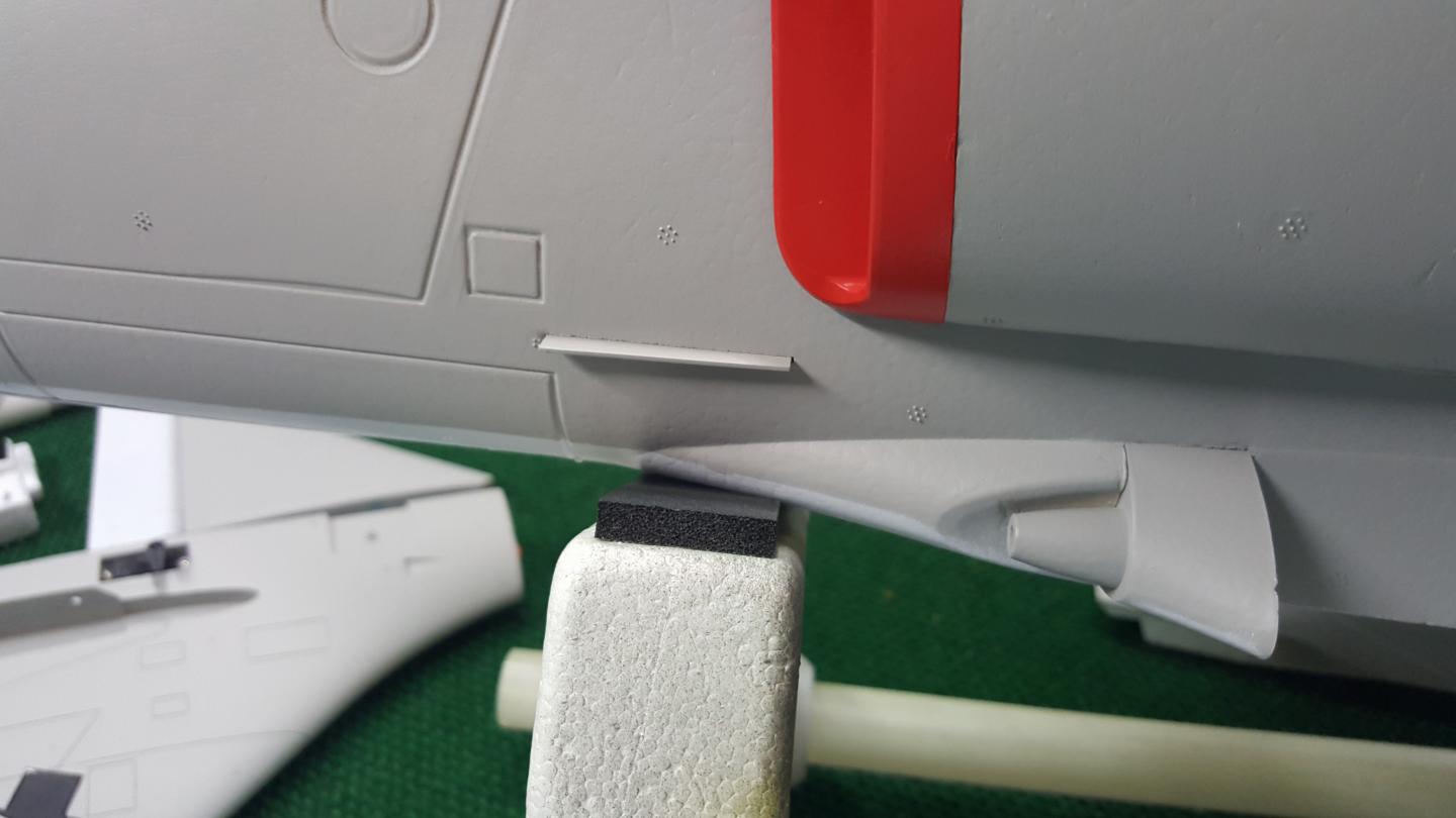

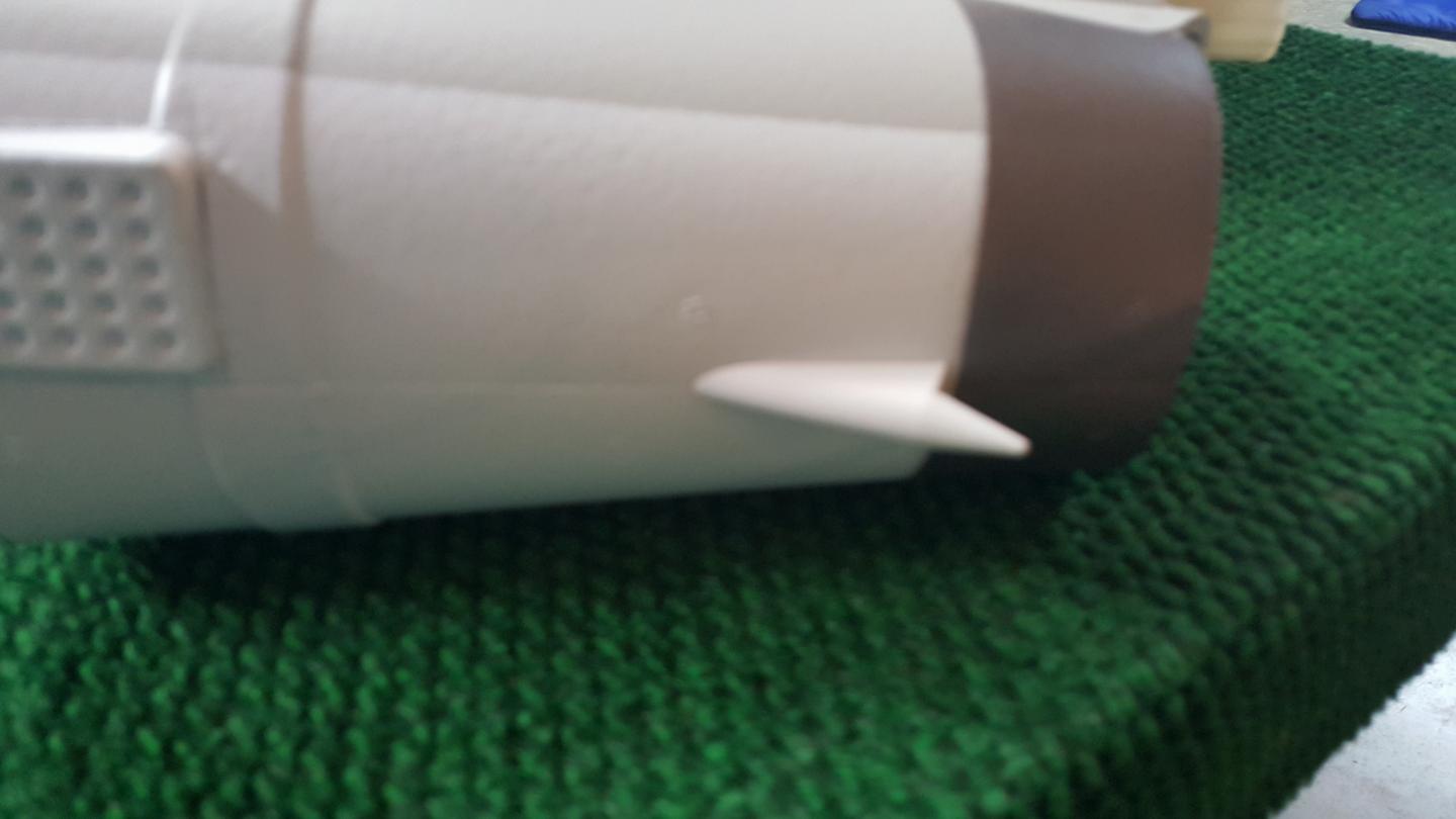

                    And both sides of the fuse just below the intakes.

                          TI are the servo horns in the right place? I just can't see where having the ball links in different holes would be good. I have always been able to get the throws setup by moving the servo horn a notch or so and adjusting the pushrod length.

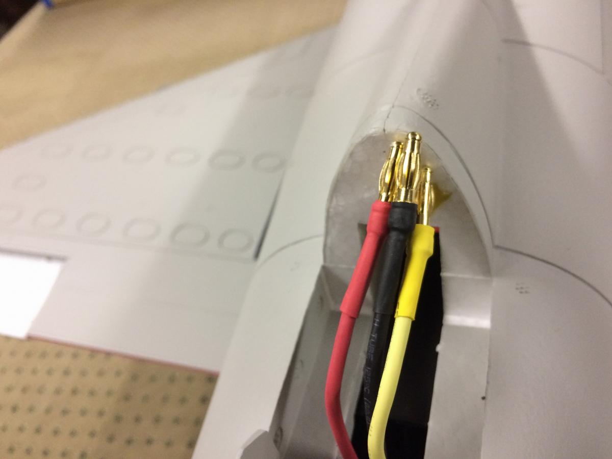

                                  I assembled the entire model in a very short time last night - I was very pleased with how it went, this is a very well-designed product IMO. Everything fit well and there were no issues. Besides the manual "forgetting" to mention a few of those small parts that I asked about (thanks for your help Tom and RCJet Dude), which was not a big deal.
                                  I checked the connections between the motor and ESC and they were OK on mine. I relocated the battery strap and I'm going to add that zip-tie for the nose gear like Tom suggested. I used Foam-Tac to attach the tail cone. I've done this on all of my birds and never had a problem.

                                    It's the amount of travel that was off, even with the horns, rods and arms set exactly the same the travel was less on the port side.

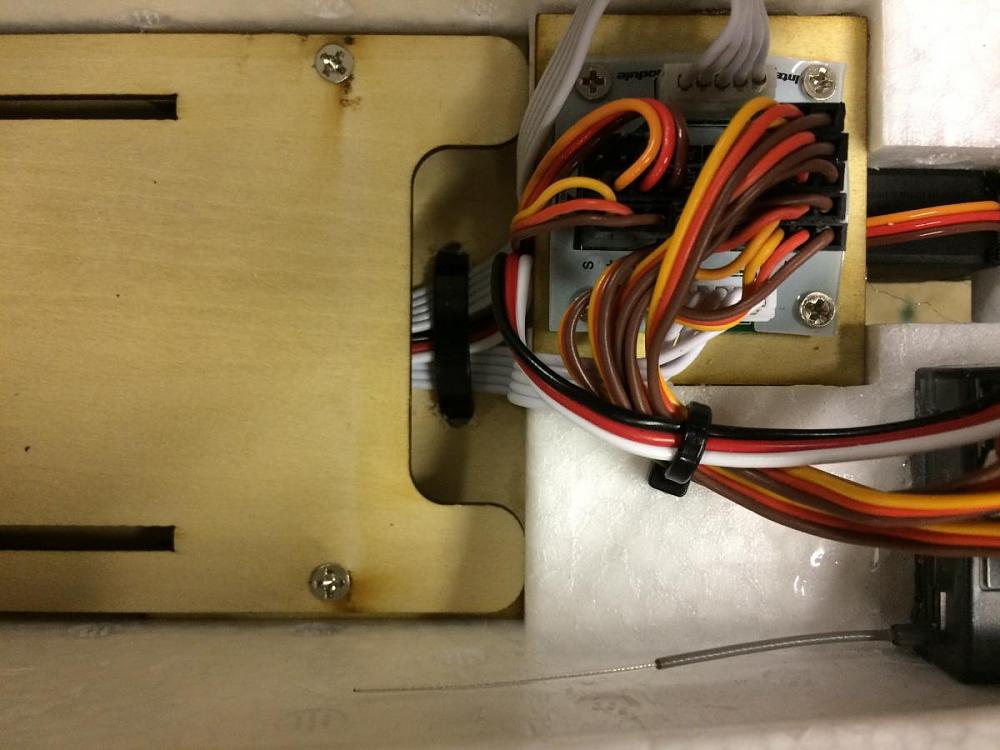

                                        Can you believe how clean the wire runs are in this bird with the use of the ribbon cables from the wings? There is no "rat's nest" to have to fight. I love it. So neat.
                                          TI.....had that happening on a flap servo when I first got my FL SeaFury.
                                          That servo is deficient (not reliable) if it doesn't have the same travel as the others.
                                          Asked Motion to replace it and they did so with no issue.;)
