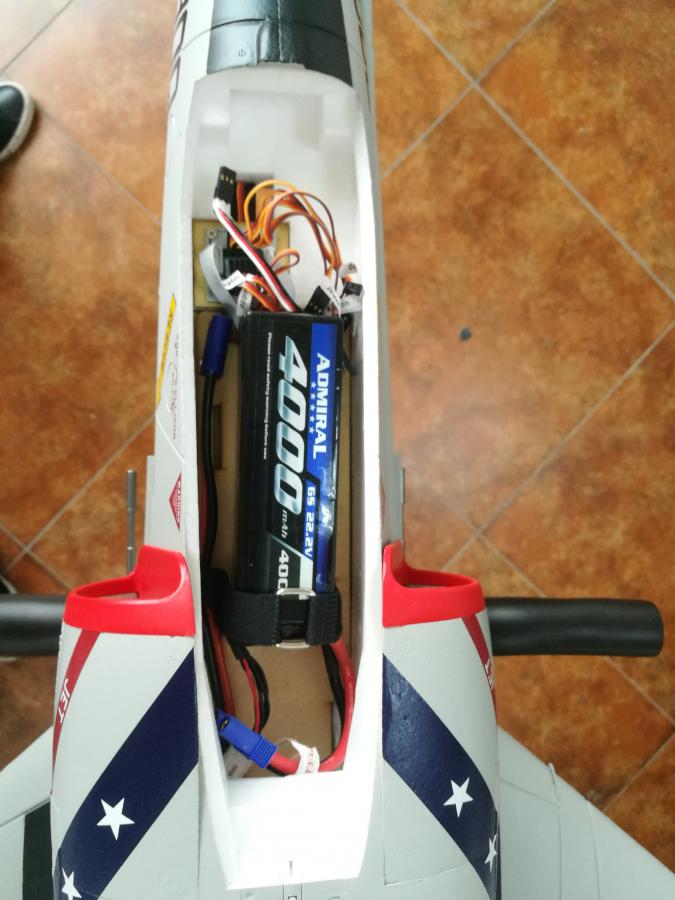

        Originally posted by OV10
        Click image for larger version Name:	Admiral 6s 4000 Placement.jpg Views:	1 Size:	67.0 KB ID:	94625
        Not too keen on the battery strap location.........looks like an immediate mod is required for a more central secure location like at the center area of the battery. ;)
        How'd that get past ya Alpha??
        There are two cutouts in the battery tray for the velcro strap. I use the rear cutout because I don't have velcro on the batteries here, and pinning the narrowest part of the battery is the most secure way to keep it from sliding aft. Users can relocate the battery strap to the forward cutout (which would place the strap just about the middle of the Admiral 4000).

          Thats a big old battery bay!
            In my models, I often use a big hunk of soft foam to fill the empty space in the compartment and keep the battery from sliding around.
                  I'll definitely be adding a 2nd battery strap..

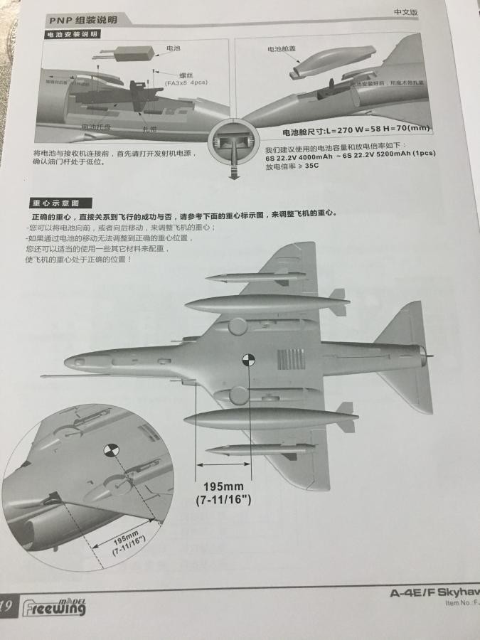

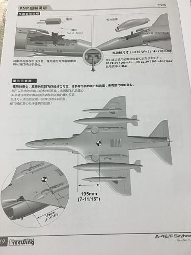

                    Thanks Alpha... The manual on my A4 has the amended CG as per pic..
                      #570
                      That is not the same image that Alpha posted. The reference point was further forward in Alphas post. Let me just double check to make sure.... It looks like the CG is at the same place in both pics but the reference point is definitely different and could potentially lead to errors if going by a ruler.
                                It looked the same to me.
                                  #576

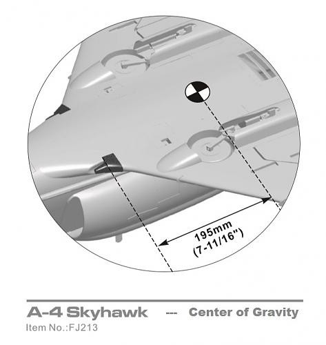

                                  Compare the front reference point in both images.

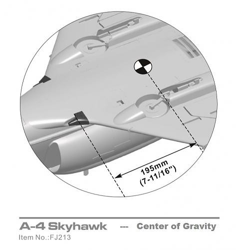

                                        Could it be one pic is an Admiral 4000 and the other a 5000???
                                          #580
                                          Compare the two...
                                          Do you see the difference at the front of the wing?
