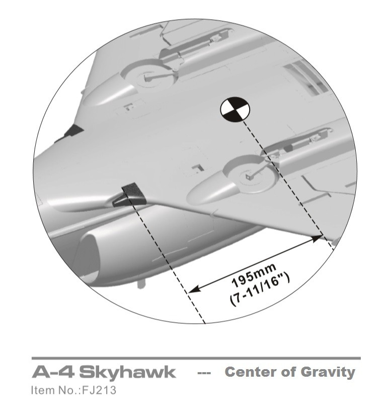

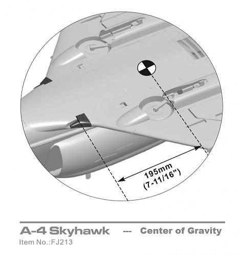

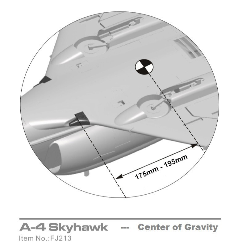

                                  Hi HellHath, good to see you received yours. Our Stateside containers are anticipated to arrive later this week, and before they do I want to publish some insider information so it's fresh for all of you as you take delivery of your Skyhawks. Consider the following as Essential Tips from the Design Team. We've put years and over 500 flights by now on these aircraft, so, please take them to heart.

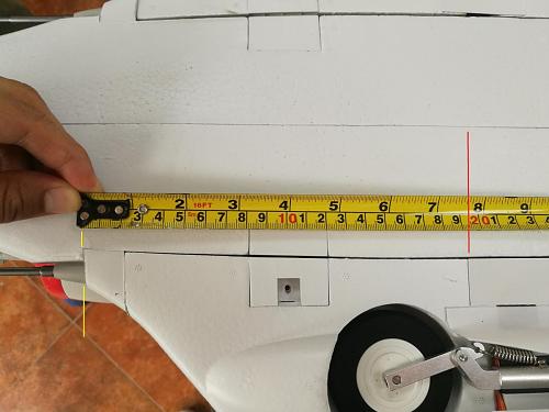

                                  Throws, Neutral Positions, and CENTER OF GRAVITY. I've summarized the manual's information into the image, below. Note that early versions of the printed instruction manual may be unclear as to the forward location from which we measure the CG. The inset picture shown here is correct, as are these real life photos that also show the relative neutral positions for your maiden flight.

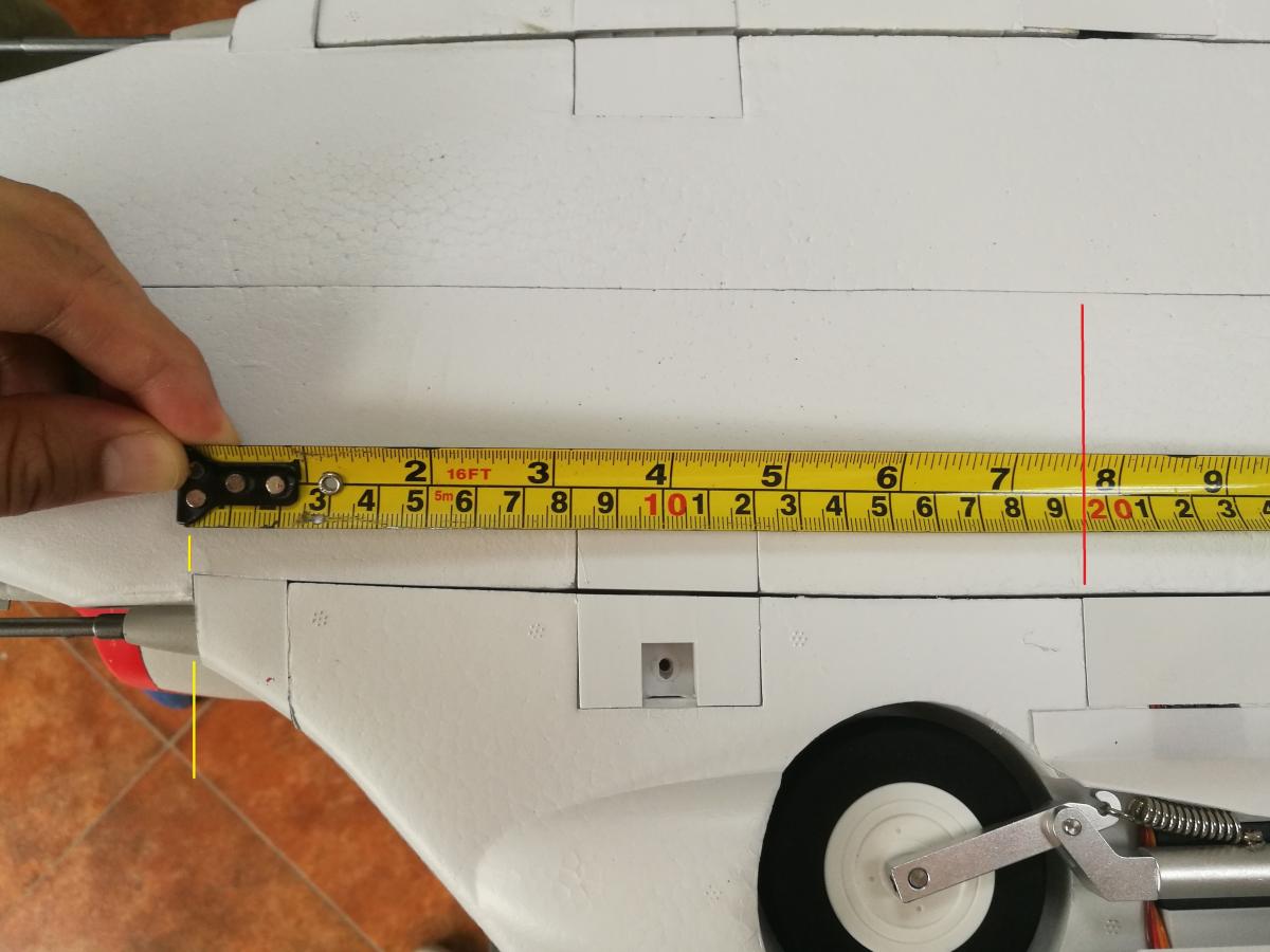

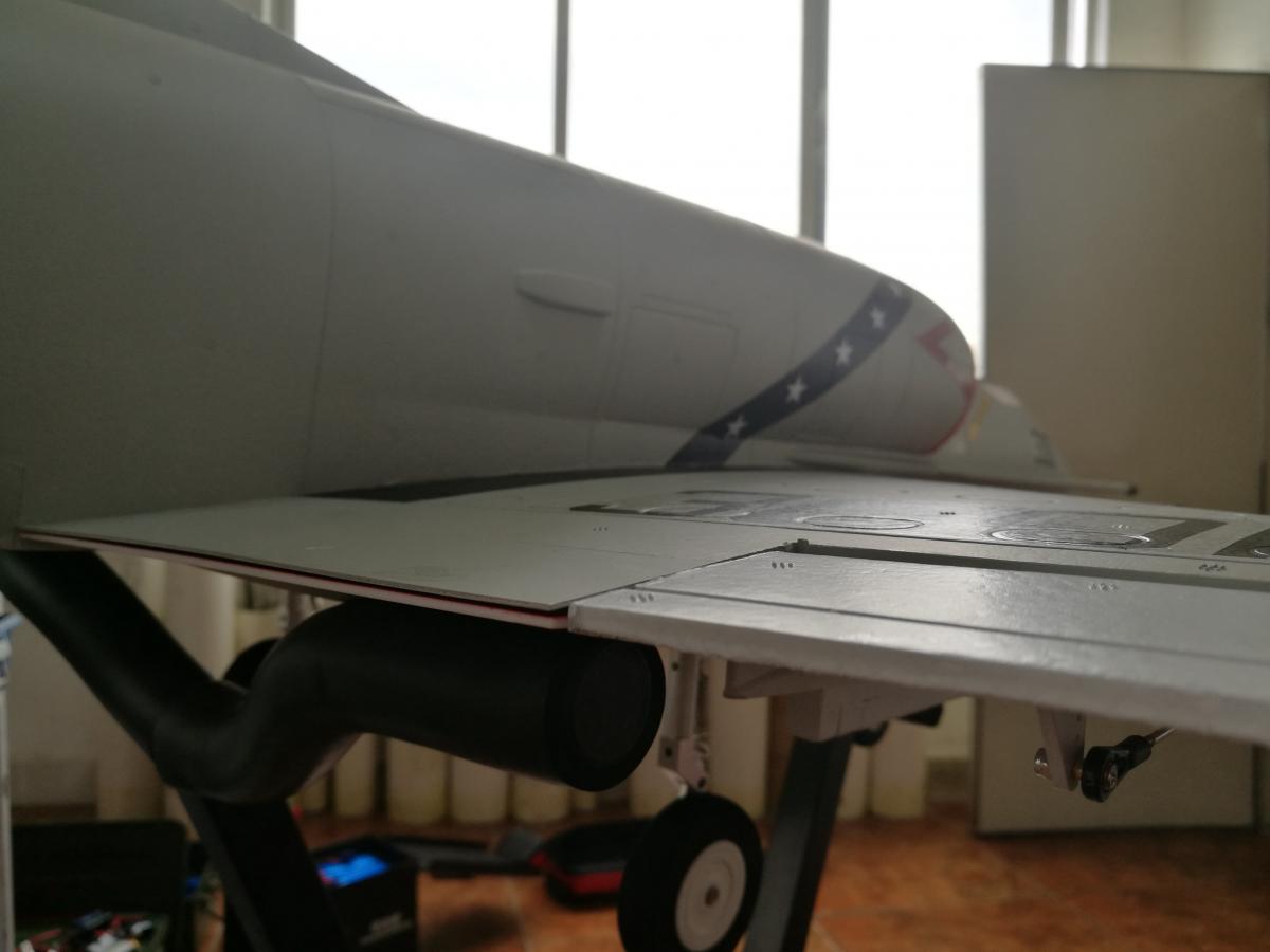

                                  Click image for larger version  Name:	CG 190-195mm back from plastic gun port per the manual.jpg Views:	1 Size:	88.1 KB ID:	94619

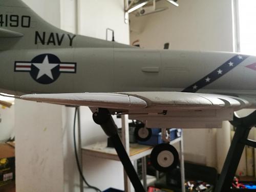

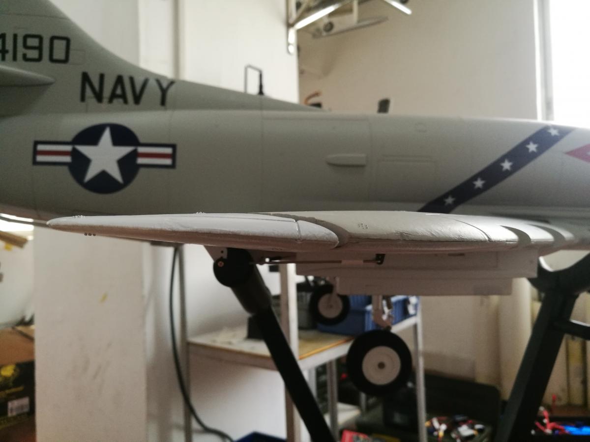

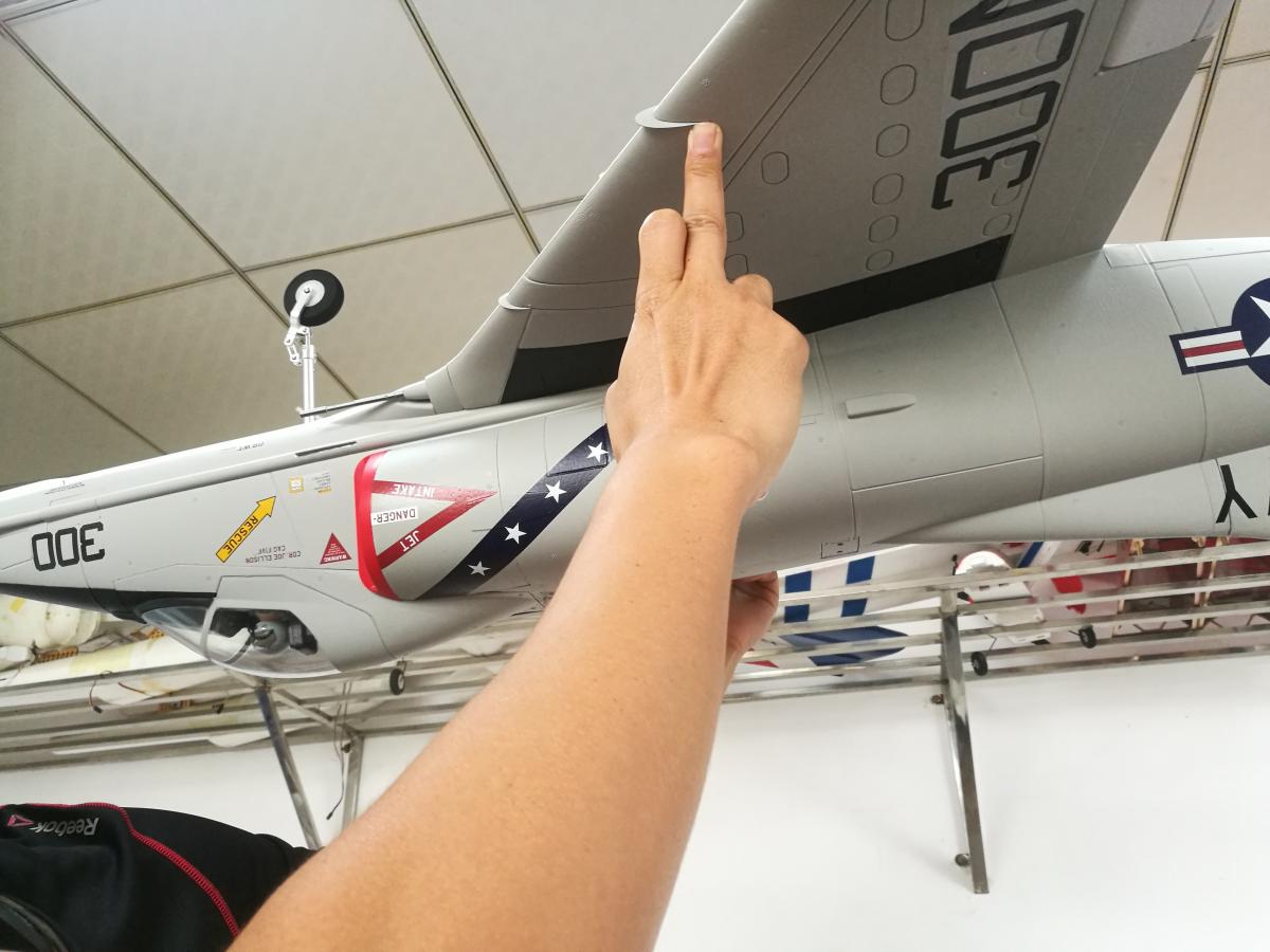

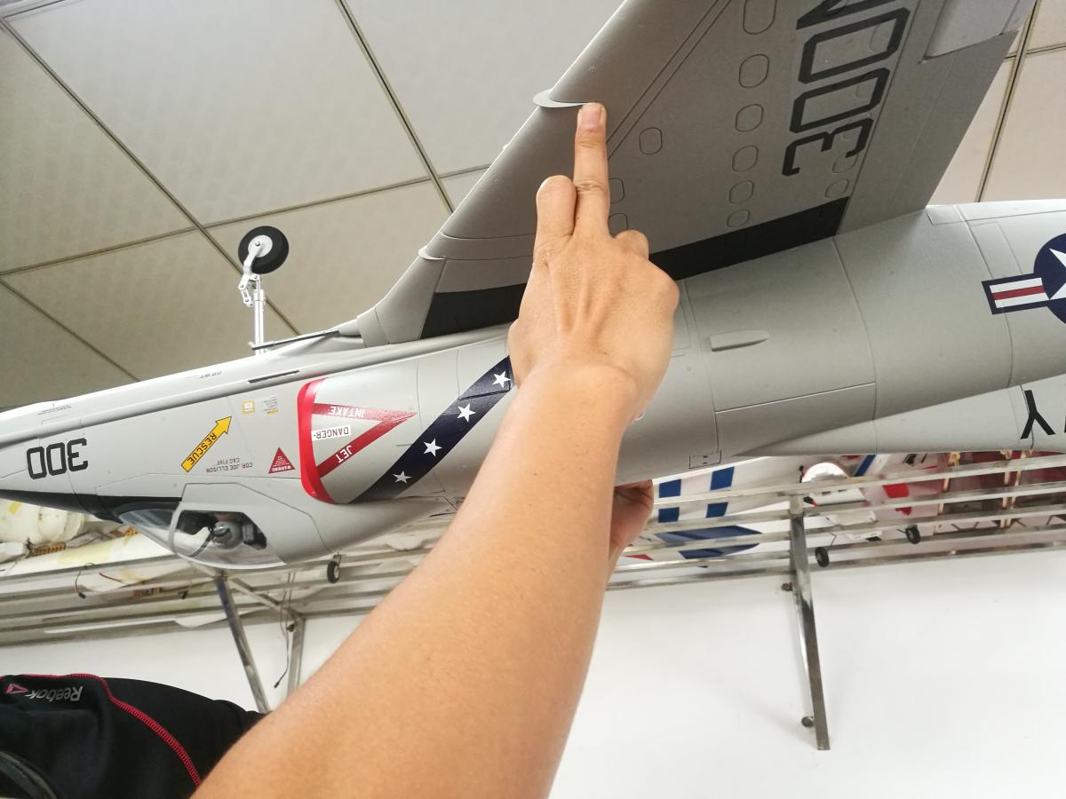

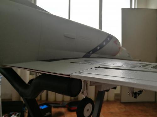

                                  Aileron neutral point. The upper surface of the aileron is flush with the upper surface of the wing. Note that this causes the aileron's TE at the outer tip to angle upwards. This is reflex, and this is normal.
                                  Click image for larger version  Name:	Aileron neutral --TE.jpg Views:	1 Size:	56.8 KB ID:	94620 Click image for larger version  Name:	image_15497.jpg Views:	1 Size:	72.7 KB ID:	94624

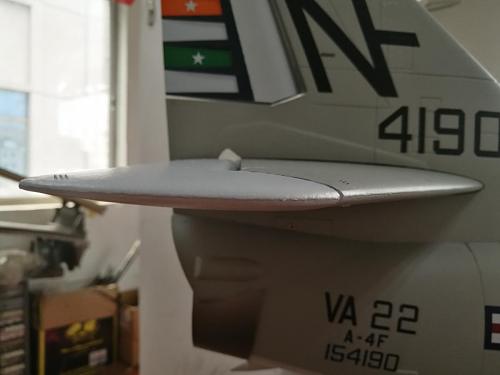

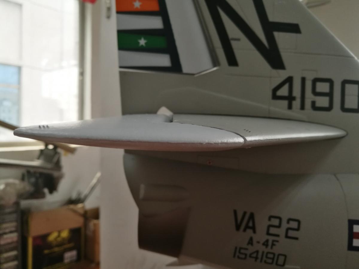

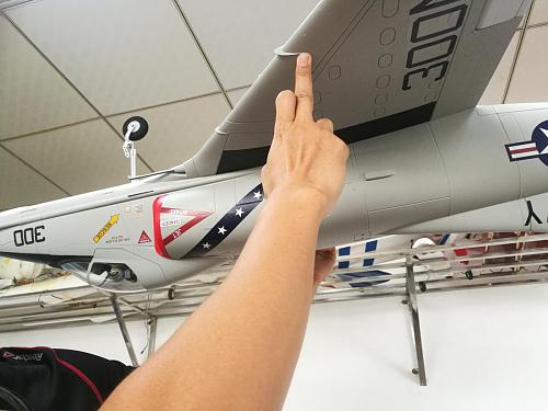

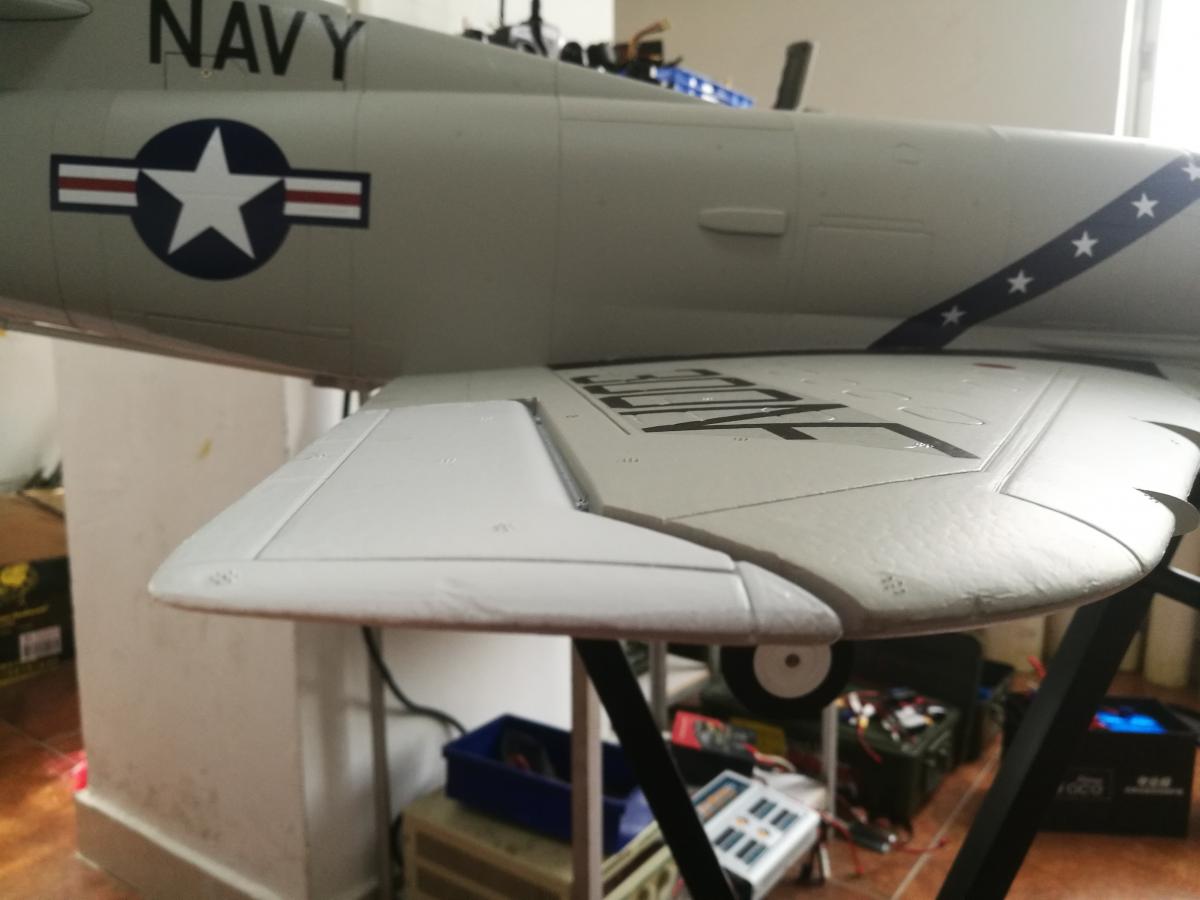

                                  Elevator neutral point. Flush, as shown. Use the mold lines on the TE as visual reference. Sometimes I end up trimming ~1mm up elevator.
                                  Click image for larger version  Name:	Elevator neutral.jpg Views:	1 Size:	53.5 KB ID:	94621

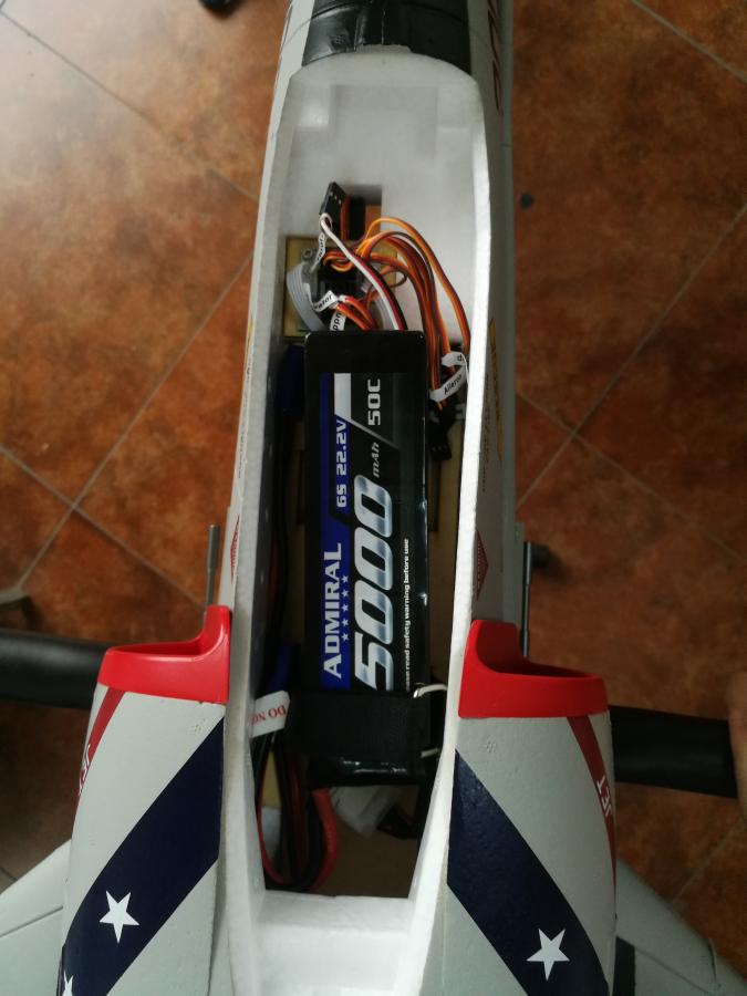

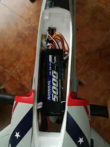

                                  Battery placement. Like many of our other 80mm EDFs, we designed this aircraft with the Admiral 6s 4000mAh and 5000mAh in mind. Recognizing that some of you hotrods may see the A-4's potential for an 8s 80mm setup so we designed the layout so the stock PNP 6s batteries (lightest recommended) would be near the front of the bay, not the far back of the bay. I recommend maidening with the heavier battery, if you're concerned about overcontrolling this agile aircraft. Note the battery position. We measure the CG without the ordnance attached. With or without the hump doesn't matter. Whether the gear up or down and whether the model is balanced upright or inverted does not significantly alter the CG point when balanced on fingertips (less than 5mm). When you've flown the model as much as we have, it's usually just "shove forward and fly" for anything between 4000-5000. But obviously for the first few flights, we recommend checking your model. Using too much epoxy to secure the tail, for example, can throw off the balance, so always check your own model before ascribing to my personal generalities.
                                  Click image for larger version  Name:	Admiral 6s 4000 Placement.jpg Views:	1 Size:	67.0 KB ID:	94625Click image for larger version  Name:	Admiral 6s 5000 Placement.jpg Views:	1 Size:	59.1 KB ID:	94623
                                      Not too keen on the battery strap location.........looks like an immediate mod is required for a more central secure location like at the center area of the battery. ;)
                                      How'd that get past ya Alpha?? :pop

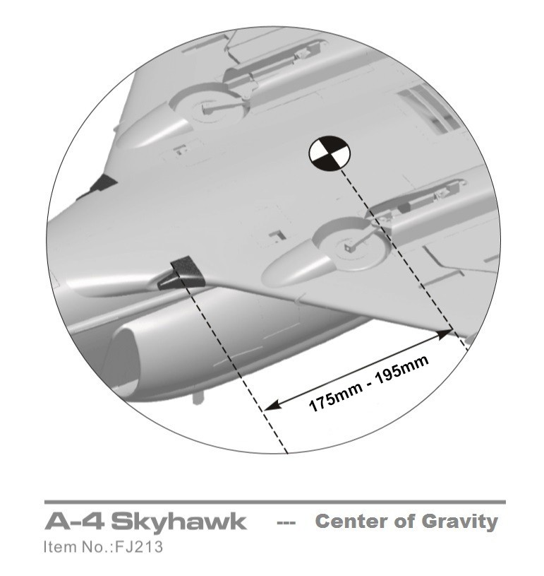

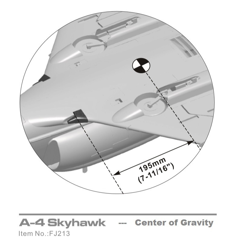

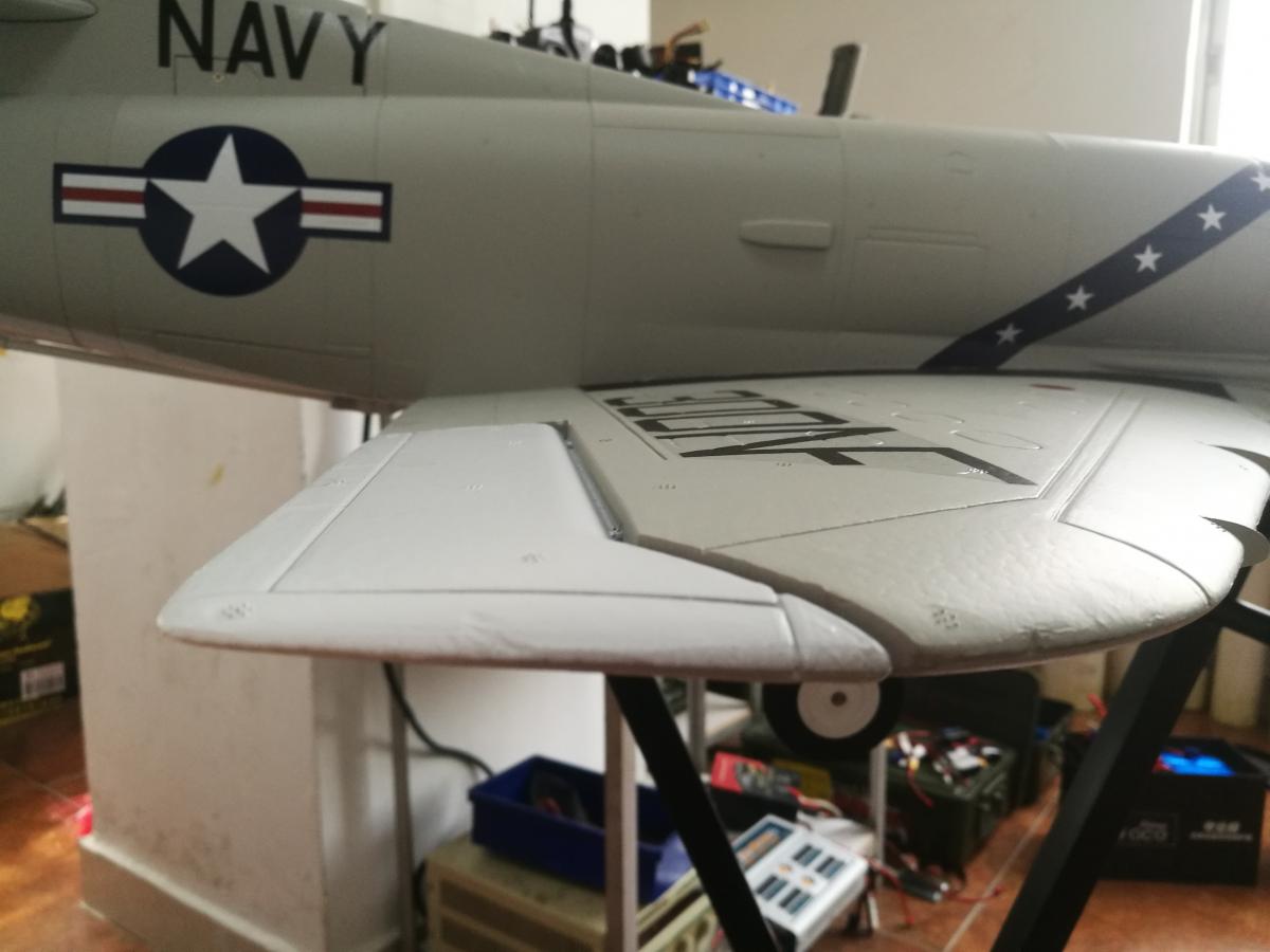

                                        Click image for larger version Name:	image_15491.jpg Views:	1 Size:	64.3 KB ID:	94613
                                        Click image for larger version Name:	CG 190-195mm back from plastic gun port per the manual.jpg Views:	1 Size:	88.1 KB ID:	94619Click image for larger version Name:	CG inverted or upright --gear down or up.jpg Views:	1 Size:	97.6 KB ID:	94626
