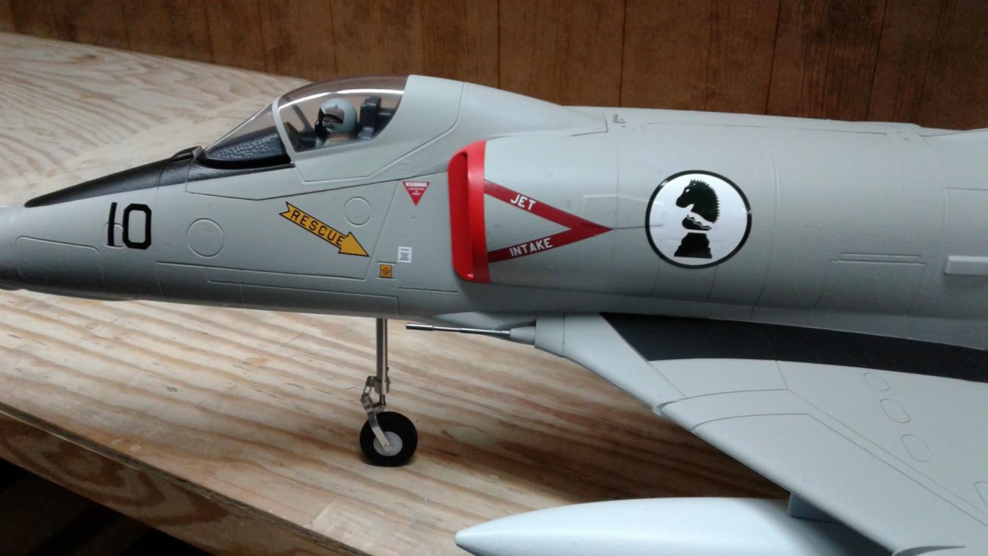

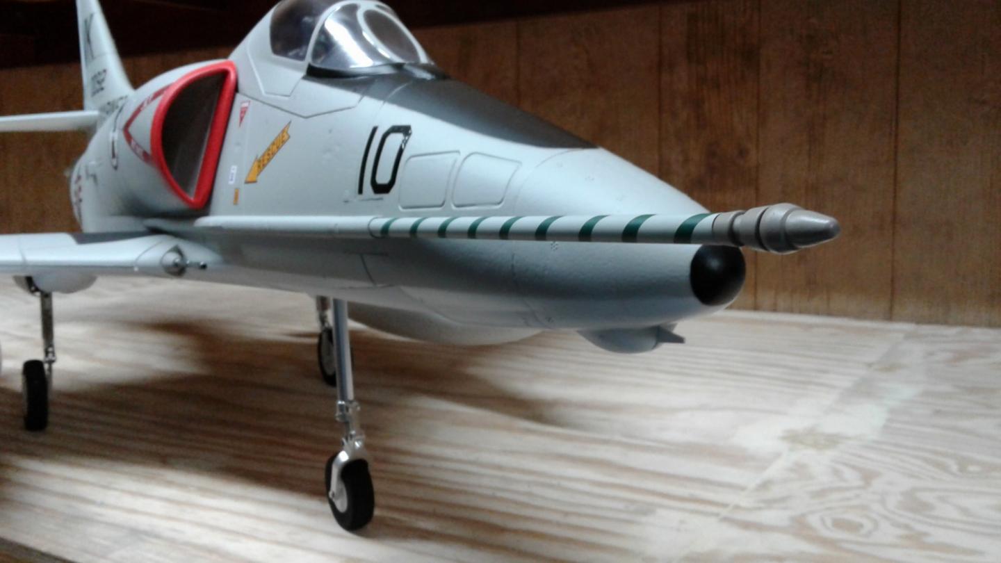

        I just noticed my "jet Intake" decals were a bit high on the shoulder. So, after some careful persuading, I got them off. Then I replaced them with the ones from the kit. Those water slide decals in the kit are actually pretty nice. I like the water slide version better than the vinyl one I had because it goes over that bump on the intake better than the vinyl one did.
        Click image for larger version  Name:	20170920_070227.jpg Views:	1 Size:	96.6 KB ID:	97553
          #1124
          Picky, picky....LOL

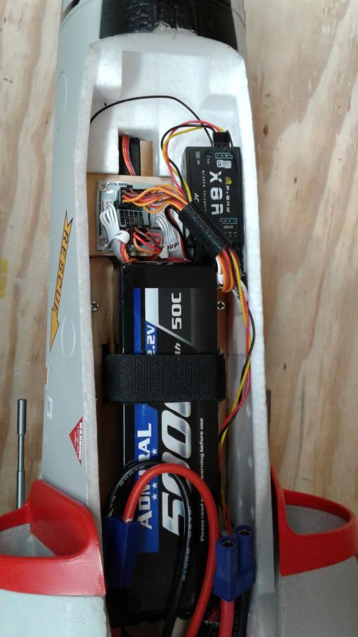

                      Here is my CG as flown in the video with tanks attached (accurate to within the width of my fingertips). Required ZERO trim. Even with tanks off.
                      Wheels up or down doesn't make that big of a difference really. The update will get you flyable. Adjust it after that.
                      Click image for larger version  Name:	20170920_091129.jpg Views:	1 Size:	59.4 KB ID:	97568
                      Incidentally, I achieved this CG by using the Admiral 5000 (new one) and just shoving it all the way forward. My RX is in the front too. You need weight up front in the A-4. If you go and start moving things back then you have to move some weight fwd to counter it. The problem is you can only go so far fwd with the battery because of that bulkhead.
                      Here is mine
                      Click image for larger version  Name:	20170920_091222.jpg Views:	1 Size:	55.8 KB ID:	97569
                      I set mine up based on the advice of Pilot Ryan. Following his direction made this the easiest maiden flight I have ever had. And he told me to set it up as per the update.
                      Hope this helps somebody. Now..it's a good day to fly. I feel like charging some LiPo's....<Salute>

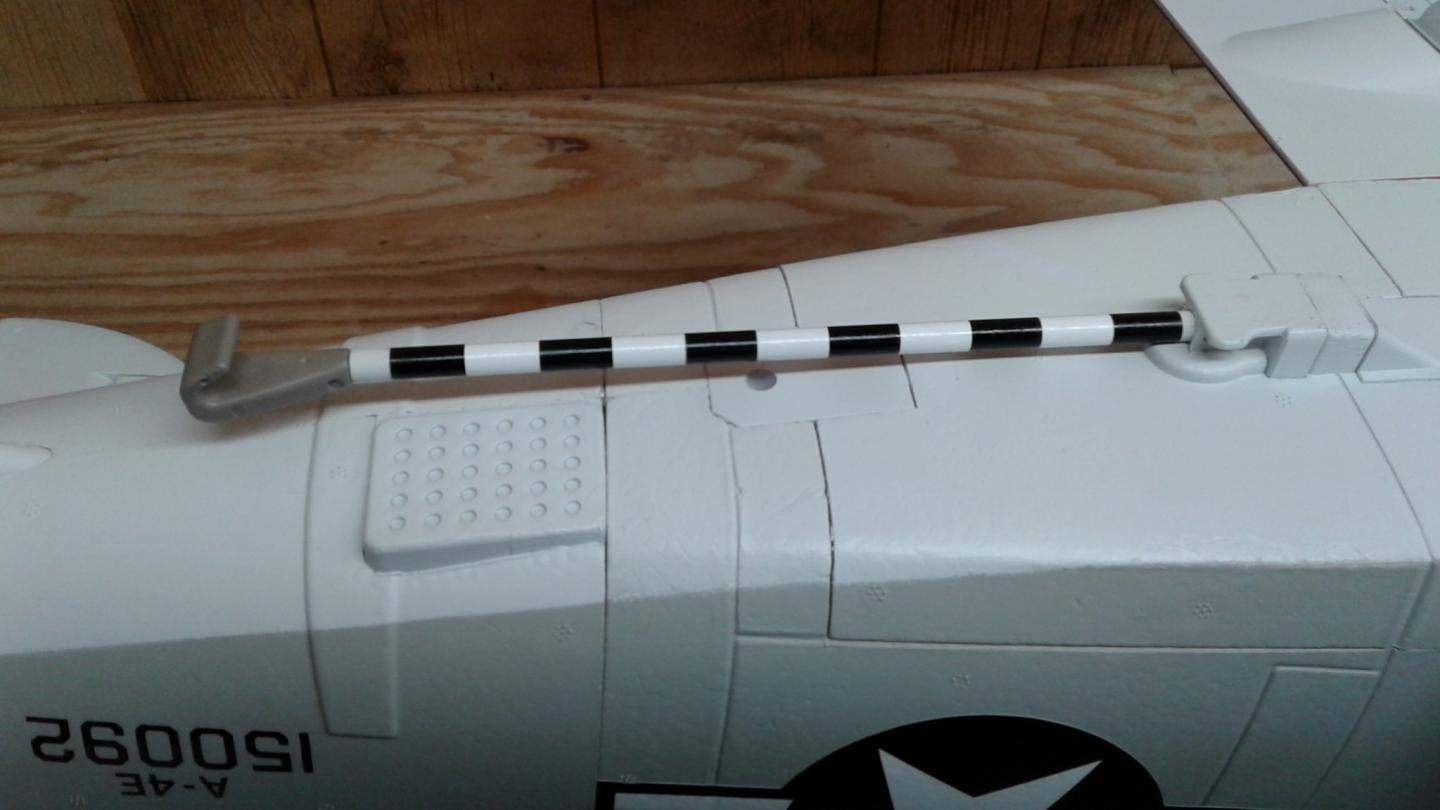

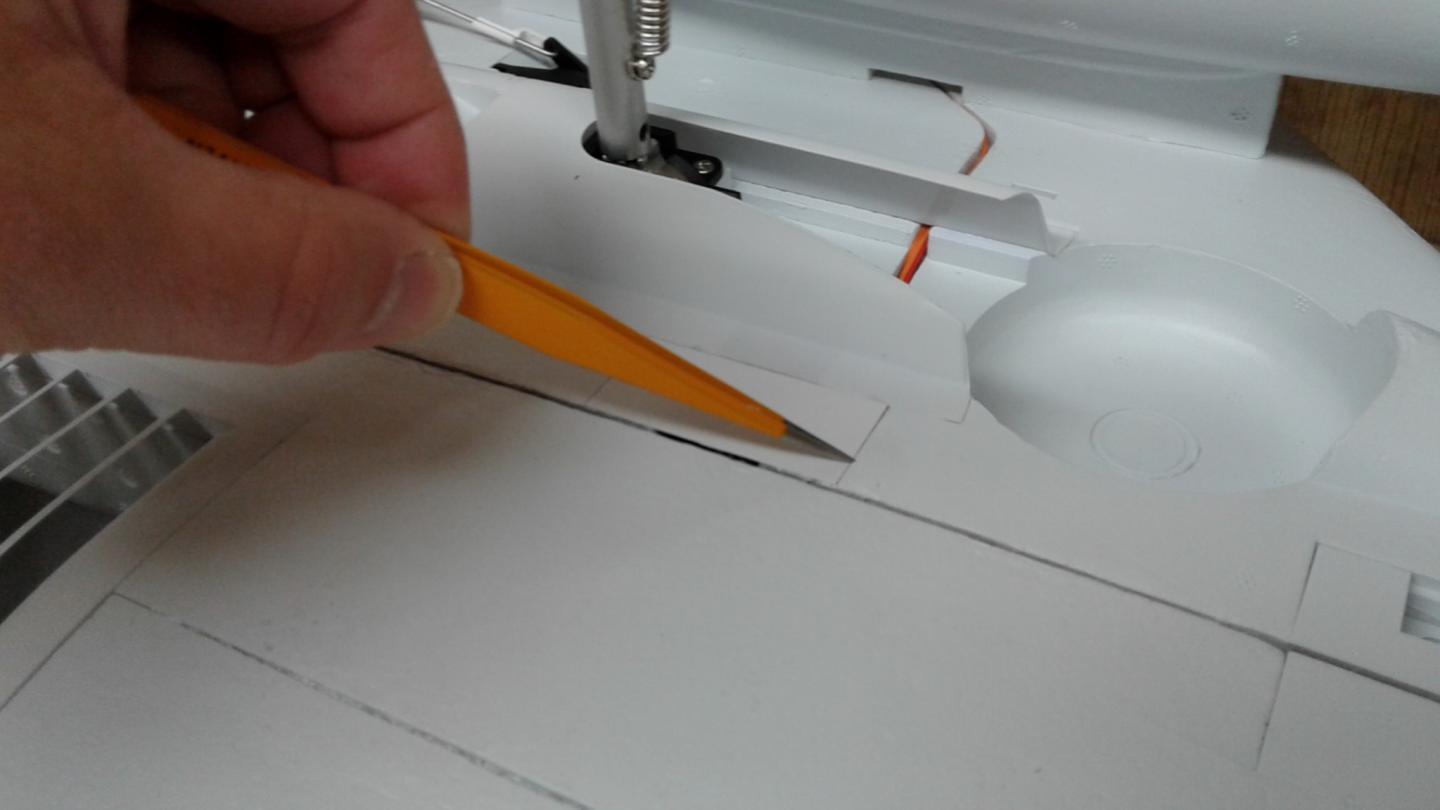

                                        Worked on my hook and refueling probe today

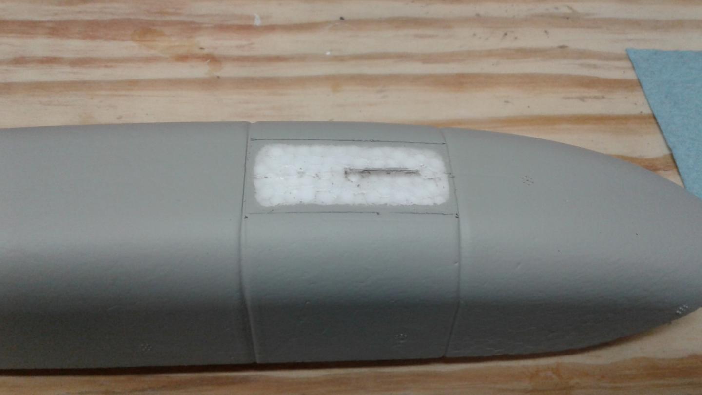

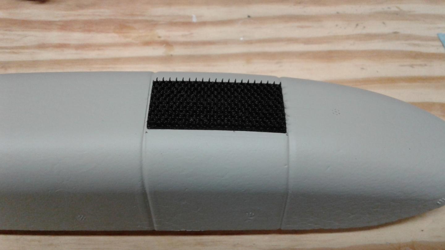

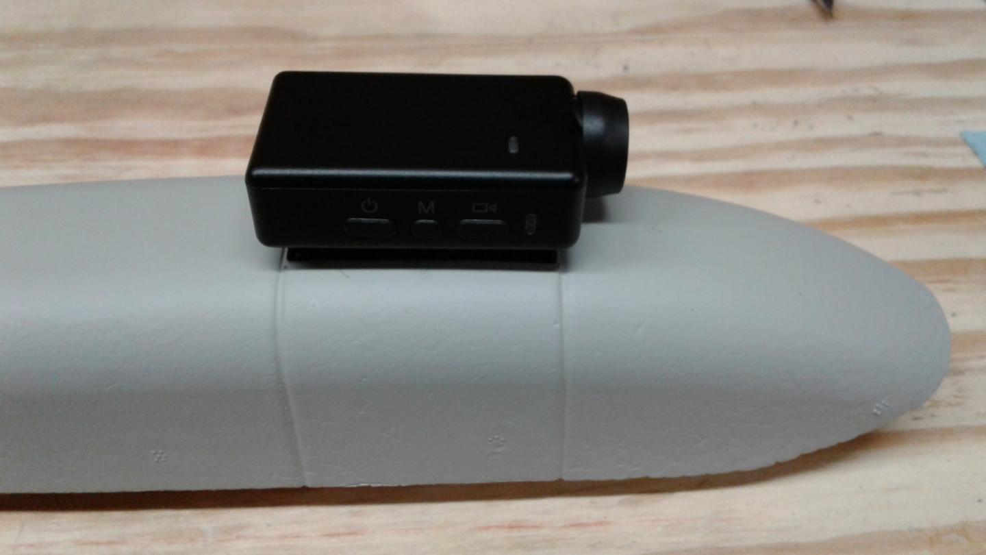

                                          Since I am not using the hump for the aircraft I am modeling, I made mine into a removable camera mount.
                                          Click image for larger version  Name:	20170920_160419.jpg Views:	1 Size:	66.2 KB ID:	97620
                                          Click image for larger version  Name:	20170920_160505.jpg Views:	1 Size:	73.7 KB ID:	97621
                                          Click image for larger version  Name:	20170920_160530.jpg Views:	1 Size:	64.4 KB ID:	97622
