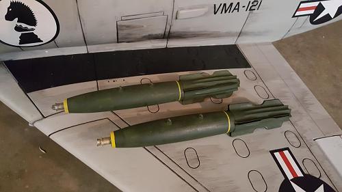

          And then there were two....
          The second one did go faster... by a little bit.. I think.
